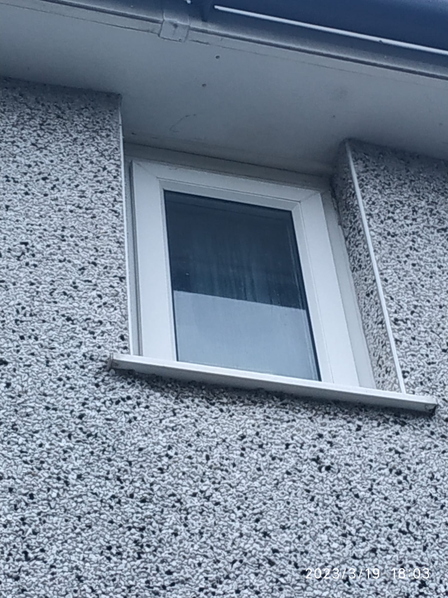

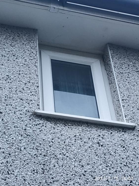

JohnBishop Posted March 20, 2023 Share Posted March 20, 2023 Hi All. I have a bit of a problem. I know that the best vantage point for the camera is where this small window is. The problem is there is insulation all around and I think I cannot drill through that roof material above the window. How can I go about it? Get a suitable mount and screw in to the window sill? Link to comment Share on other sites More sharing options...
MikeSharp01 Posted March 20, 2023 Share Posted March 20, 2023 Does that window open - at all / outwards and what is the soffit made of UPVC / Wood? 1 Link to comment Share on other sites More sharing options...
JohnBishop Posted March 20, 2023 Author Share Posted March 20, 2023 6 hours ago, MikeSharp01 said: Does that window open - at all / outwards and what is the soffit made of UPVC / Wood? yes, the window opens outwards and the soffit is made of UPVC. Thank you Link to comment Share on other sites More sharing options...
SteamyTea Posted March 20, 2023 Share Posted March 20, 2023 There is a John Bishop from Liverpool, told that every house needs a security camera up there. Link to comment Share on other sites More sharing options...
MikeSharp01 Posted March 21, 2023 Share Posted March 21, 2023 On 20/03/2023 at 13:23, JohnBishop said: yes, the window opens outwards and the soffit is made of UPVC. Thank you Most modern cameras weigh nothing so the soffit will support one of them no problem 1 Link to comment Share on other sites More sharing options...
JohnBishop Posted March 21, 2023 Author Share Posted March 21, 2023 4 hours ago, MikeSharp01 said: Most modern cameras weigh nothing so the soffit will support one of them no problem sounds great. This is what I wasn't sure 1st how is this "soffit" called and 2nd if I can drill through it in case of some water egress. Link to comment Share on other sites More sharing options...
MikeSharp01 Posted March 21, 2023 Share Posted March 21, 2023 55 minutes ago, JohnBishop said: This is what I wasn't sure 1st how is this "soffit" called and 2nd if I can drill through it in case of some water egress If it's a decent 10mm soffit you can use self tapping screws so a very small hole, shallow, is needed just to start the screw and select the length so it does not come through. You need not worry as if there is water up there you have much bigger problems. 1 Link to comment Share on other sites More sharing options...
MikeSharp01 Posted March 21, 2023 Share Posted March 21, 2023 Either way use stainless steel screws. 1 Link to comment Share on other sites More sharing options...
SiBee Posted March 22, 2023 Share Posted March 22, 2023 Mine are all screwed into upvc soffit👍 May have gotten lucky and hit a timber with at least one screw. I had to drill something like a 30mm hole for the cables and balm connectors which is enough to feed a wooden packer through for your screws to fasten into. Or, what about plasplug hollow fixings or caravan cavity fixings? 1 Link to comment Share on other sites More sharing options...

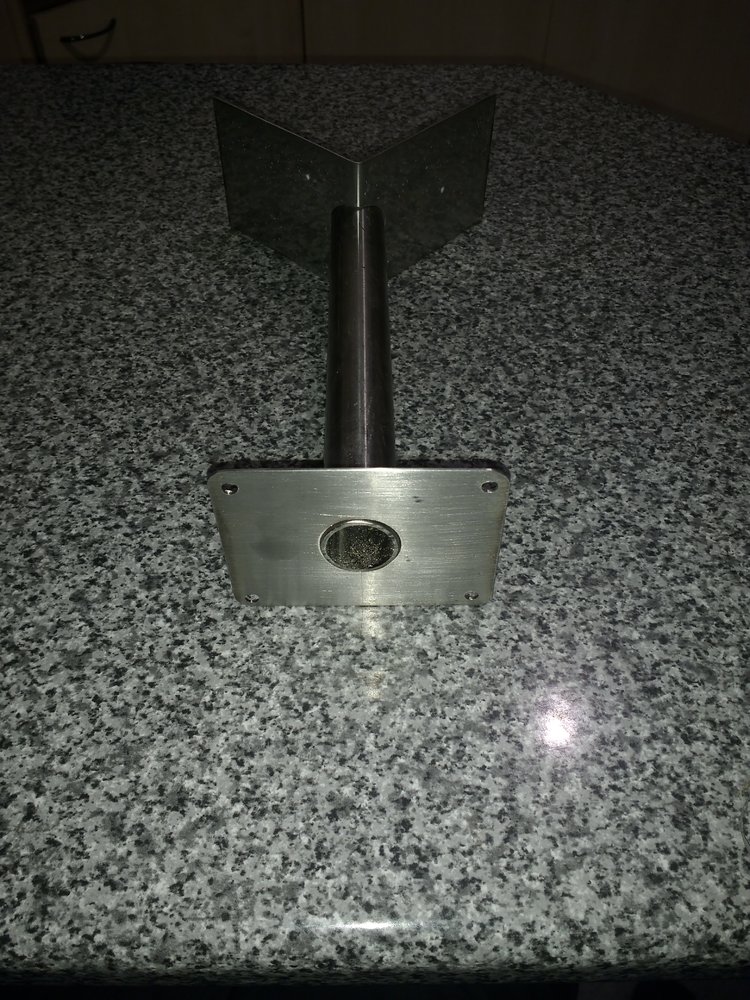

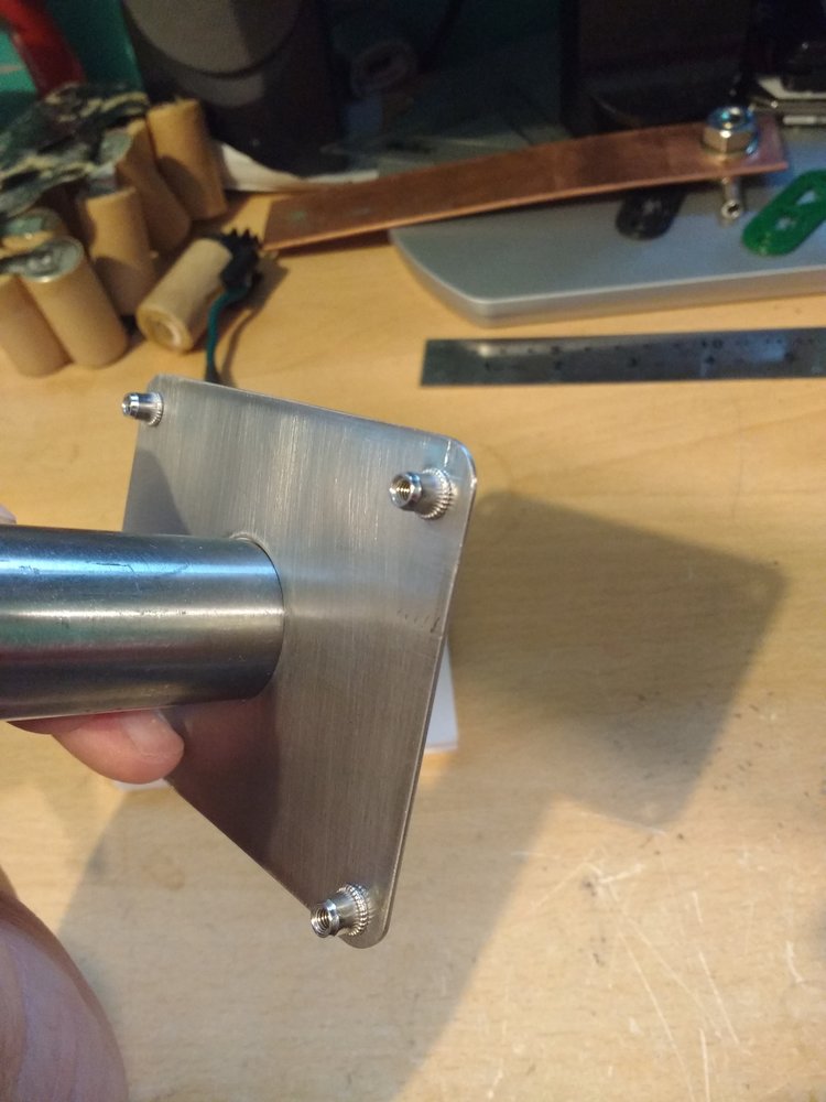

Onoff Posted March 22, 2023 Share Posted March 22, 2023 I'm making a stainless camera bracket for a mate at the moment. All cut, just got to weld it up. Goes on the corner of the house, sticks out far enough to see past the drain pipe: M3 stainless rivnuts: Link to comment Share on other sites More sharing options...

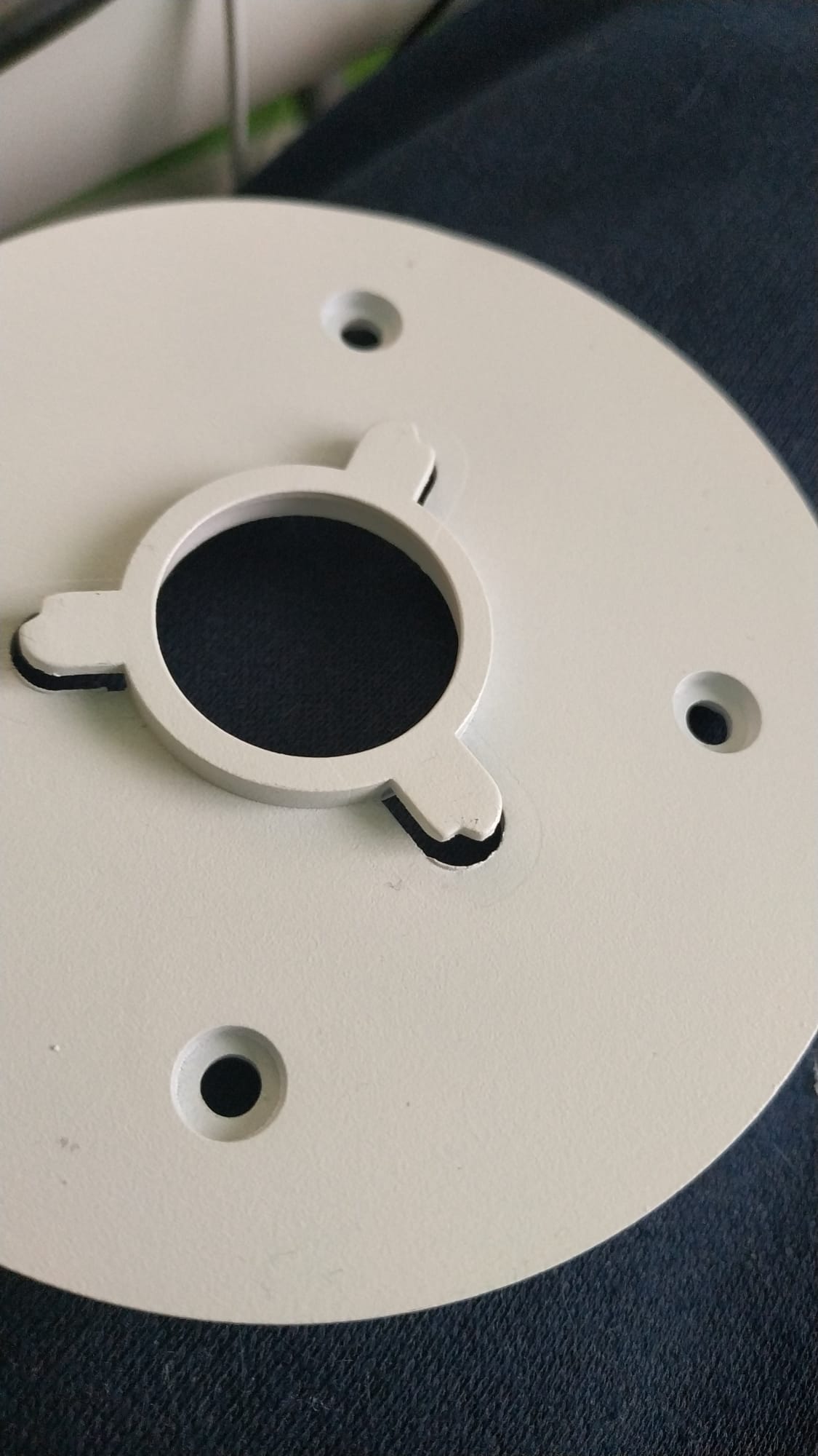

JohnBishop Posted April 1, 2023 Author Share Posted April 1, 2023 I understand in this case the best would be a self tapping screw. In my case I need a screw that is no more than 4mm wide (the whole is 4mm) and the opening is 7.5mm wide but the screw does not have to be flush with the mounting plate. If the soffit is 10mm thick then I reckon at least 10mm long screw. The self-tapping screws I see at Screwfix are minimum 6ga. Link to comment Share on other sites More sharing options...
