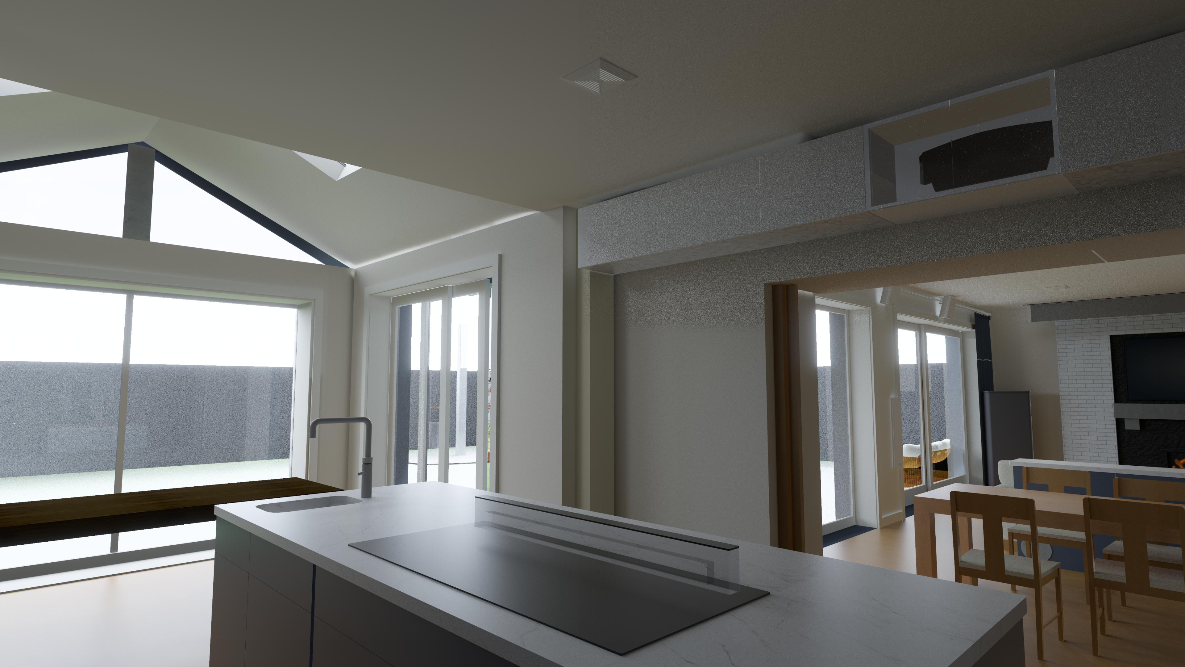

Indirect light - will my kitchen be too dark, and if so what can we do?

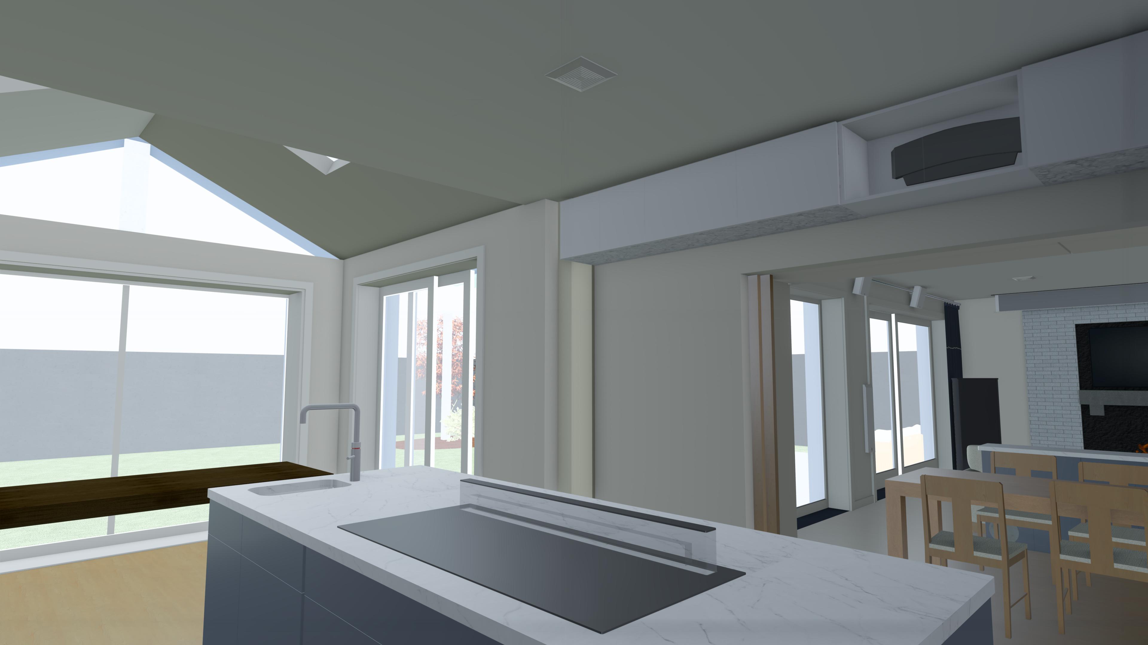

Please take a quick look at the below, and would love an opinion on:
A/ Would this kitchen be too dark as it is.
B/ What is the official/scientific way to go about finding this out? Is there some rule such as "at least xyz lux measured at 3pm on the furthest horizontal surface..."
C/ Anyone have a similarish kitchen - basically sun-facing but no direct light - that can put us at ease?
D/ Should it be too dark, will replacing the navy and potentially the oak with some light/white colour help anything?
- "Too dark" would be defined as that you probably need to turn on kitchen lights even at 3pm during a normal-ish day

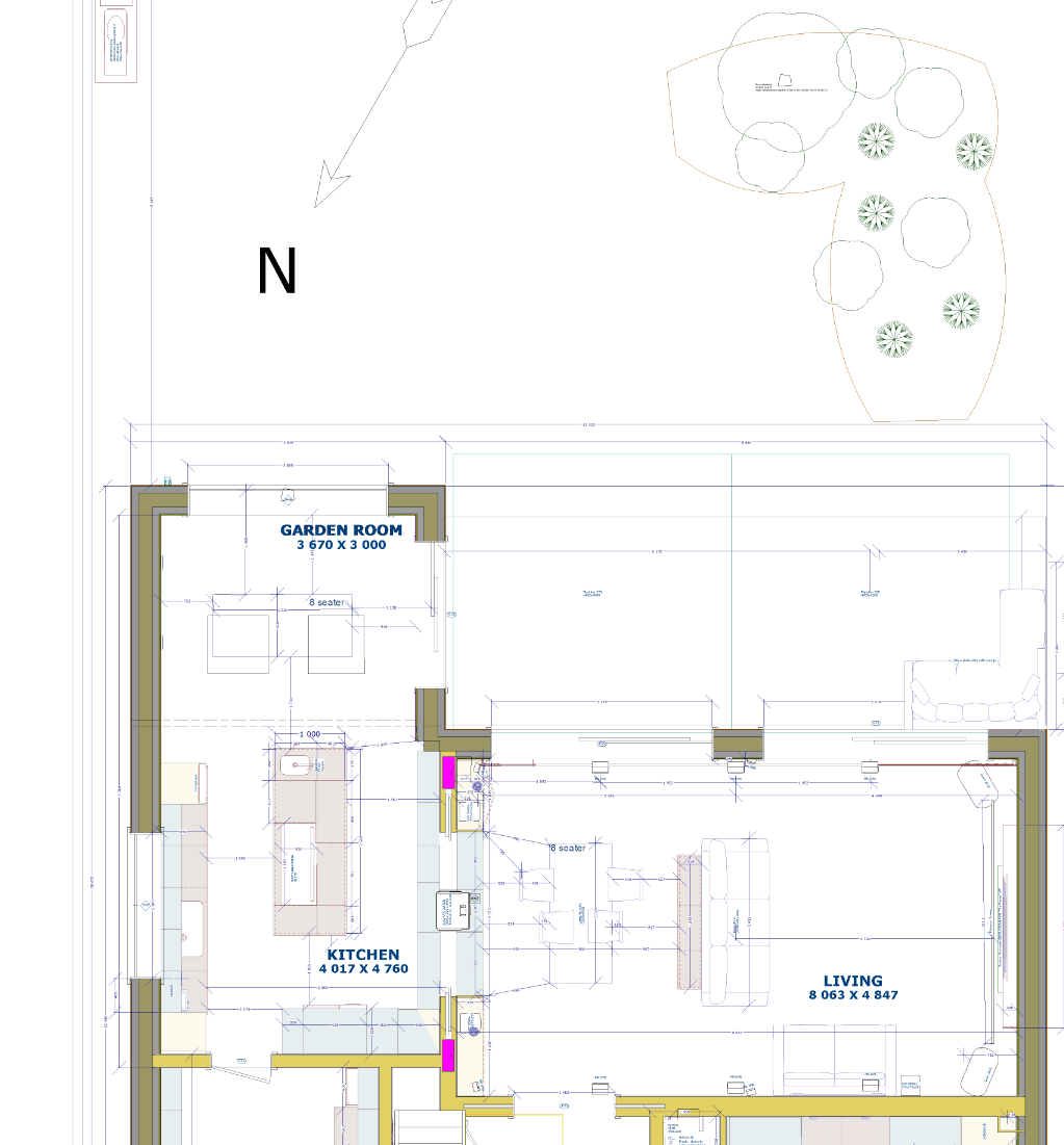

- As you can see, house is SSE facing, sun disappears from the last tip of the garden room at 4pm already.

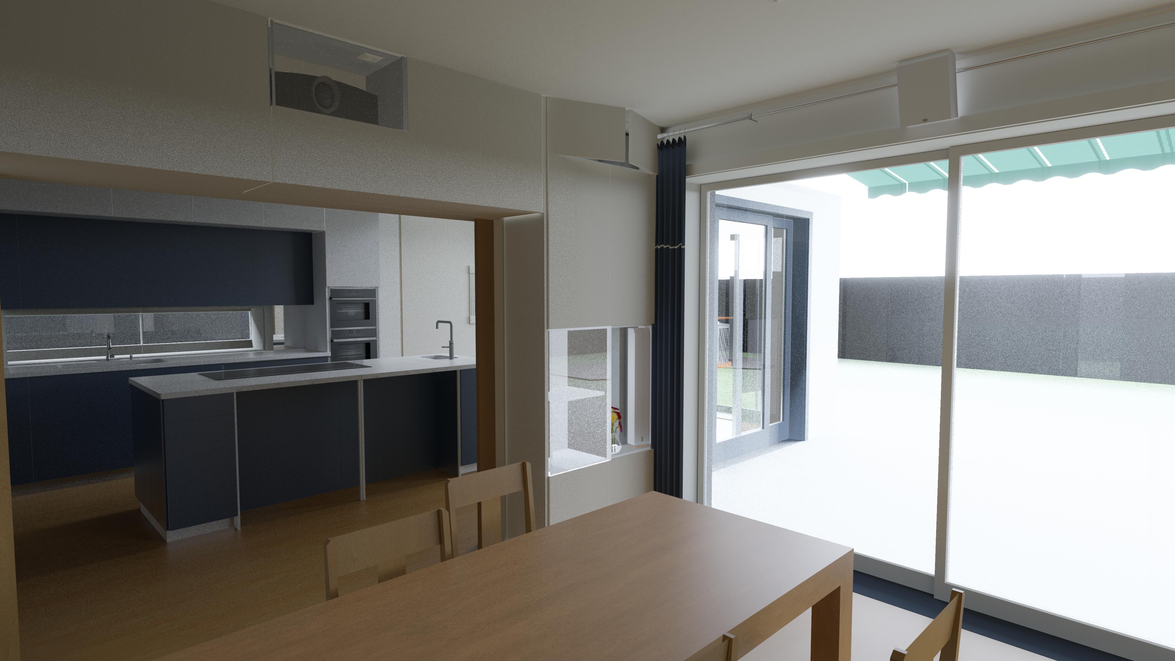

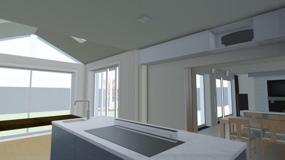

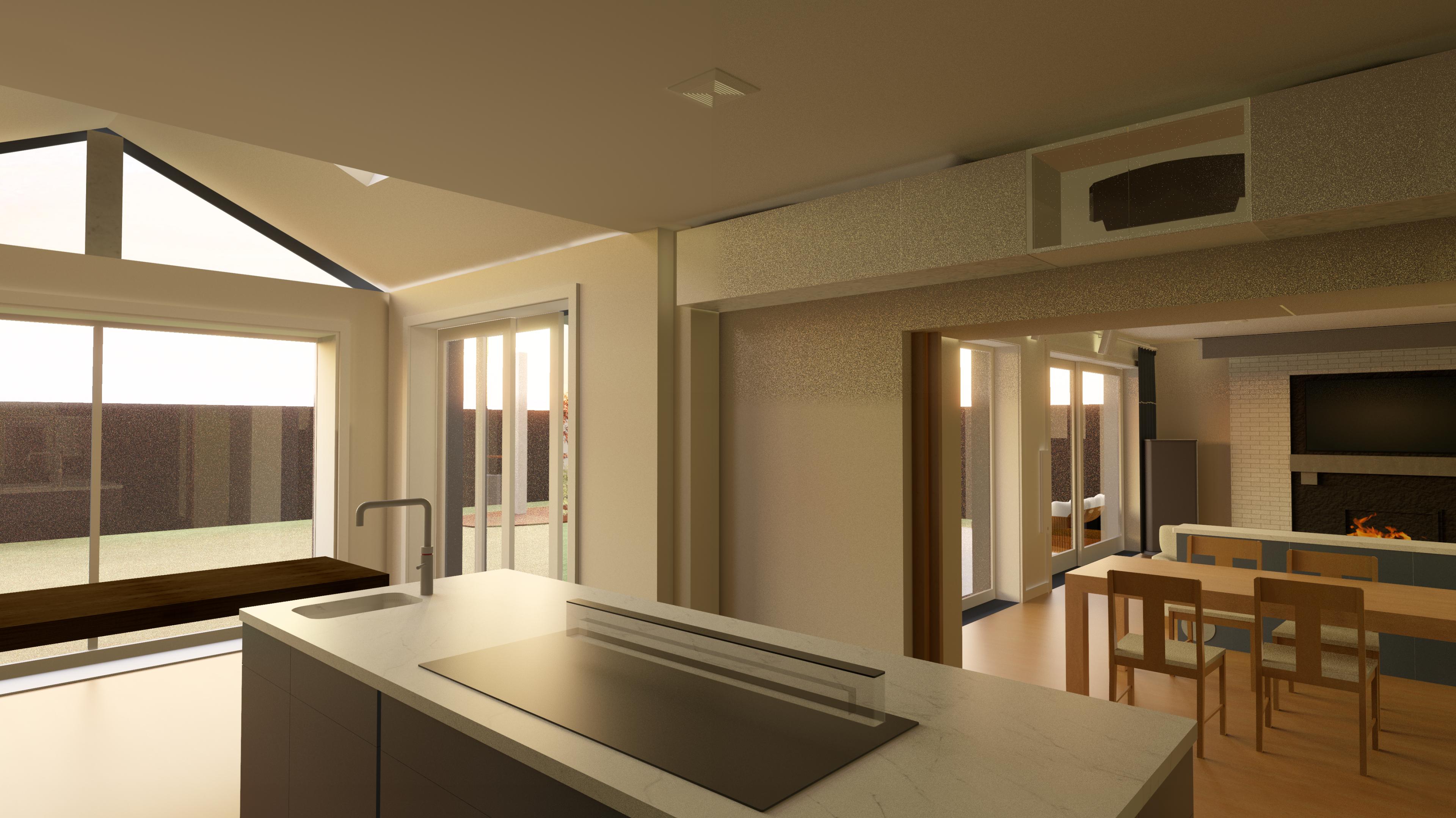

Some renders with different settings, certainly not officially representative of an actual situation but to get an idea.
Note that even the livingroom in the back looks 'darkish' so clearly computers are not great at simulating what a real human would think of the situation, especially since our eyes easily adapt etc etc.
The gardenroom has a ton of glass as can be seen, 2 rooflights, triangle, etc. Also big glass doors in living but a bit further and not a huge amount of surface can be seen from the kitchen
and as for the kitchen colour scheme:
- White, warm oak floor, navy.

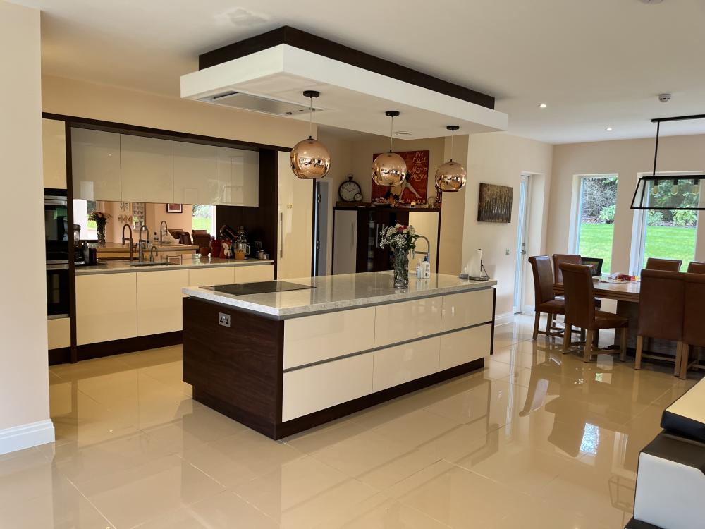

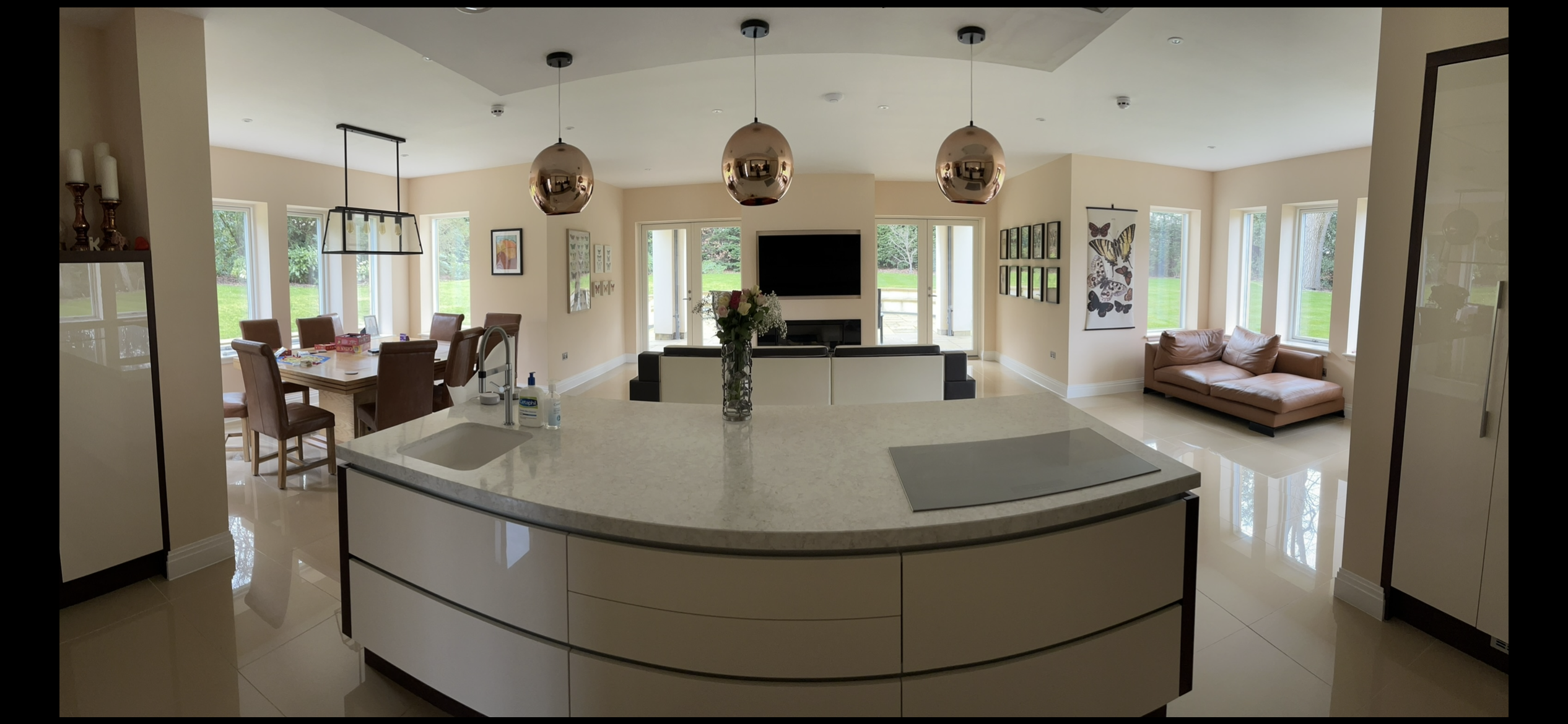

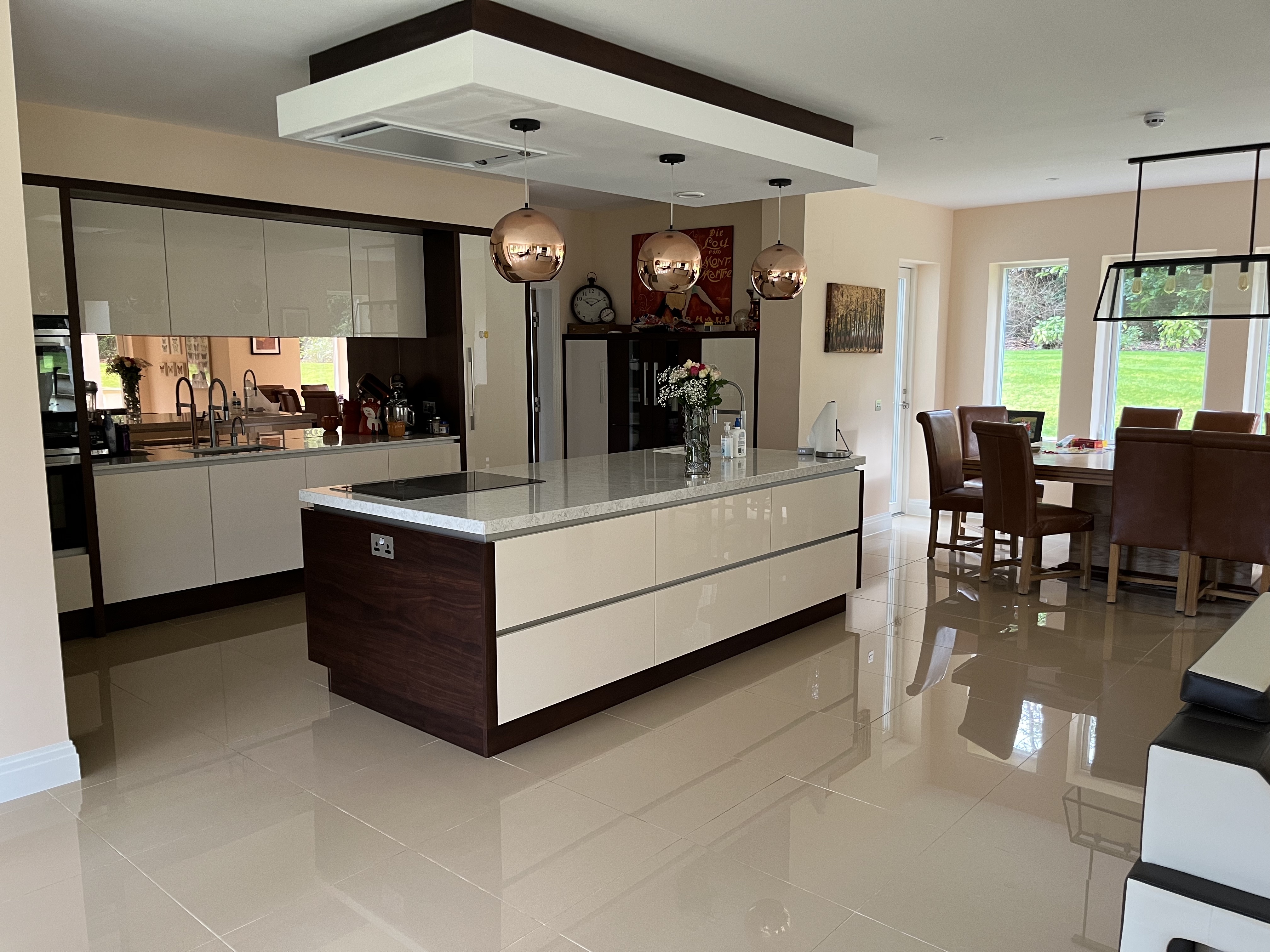

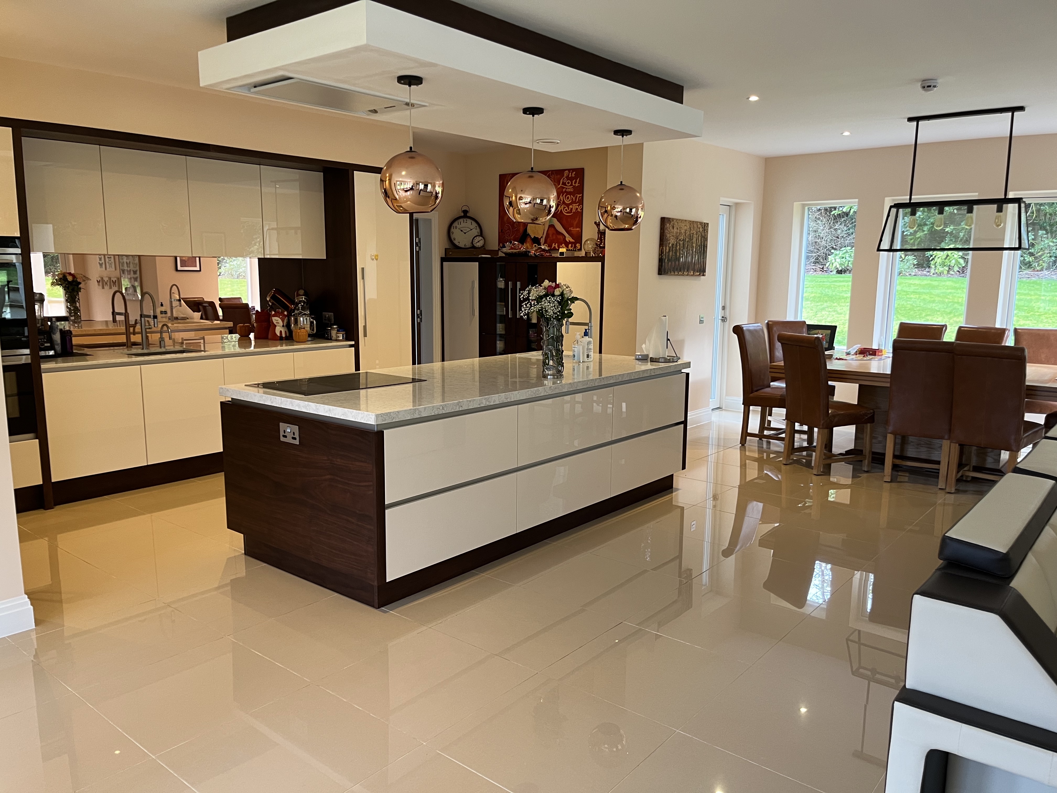

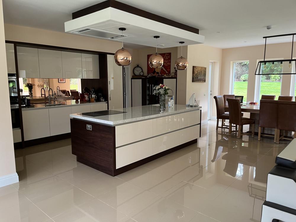

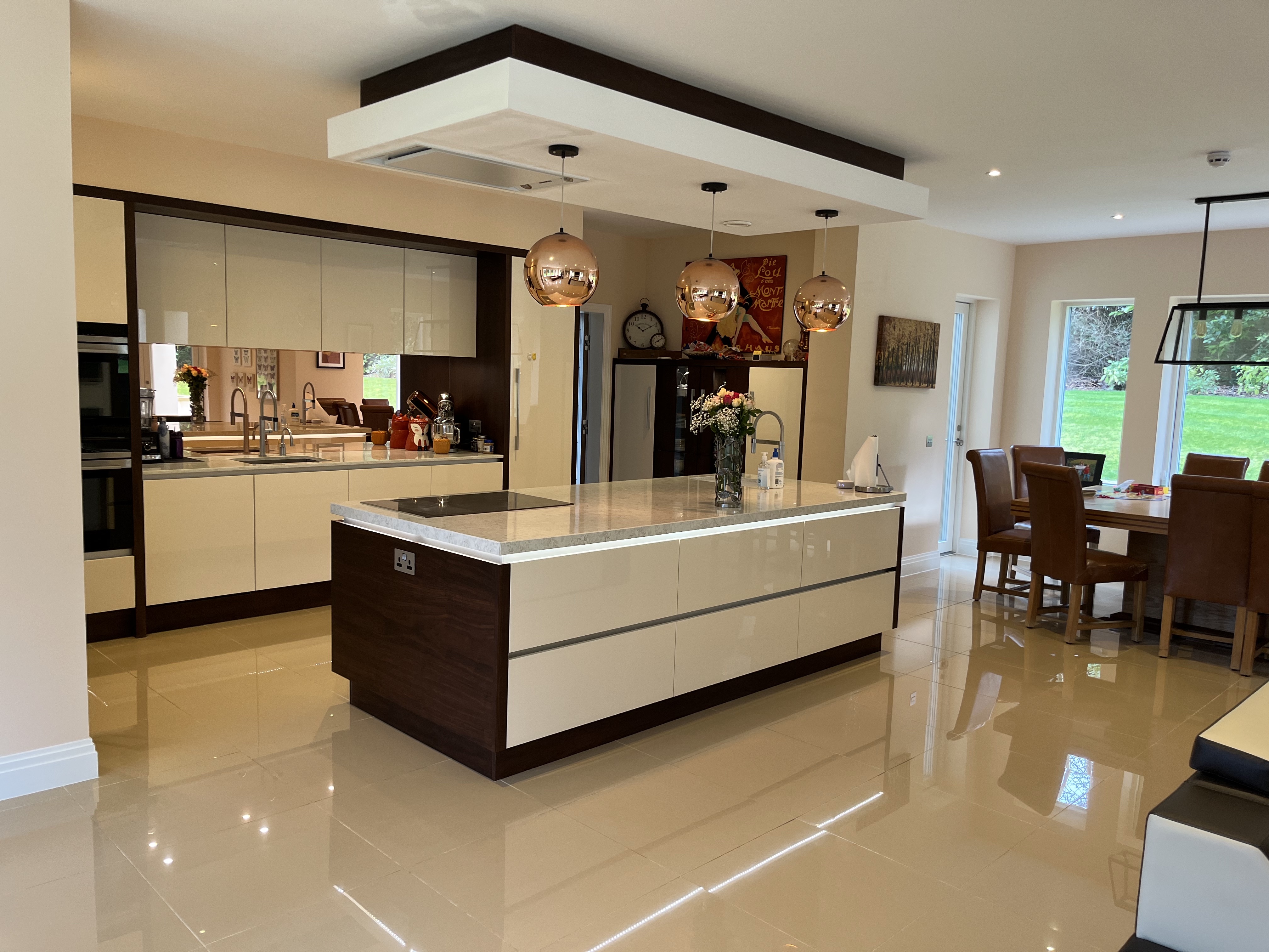

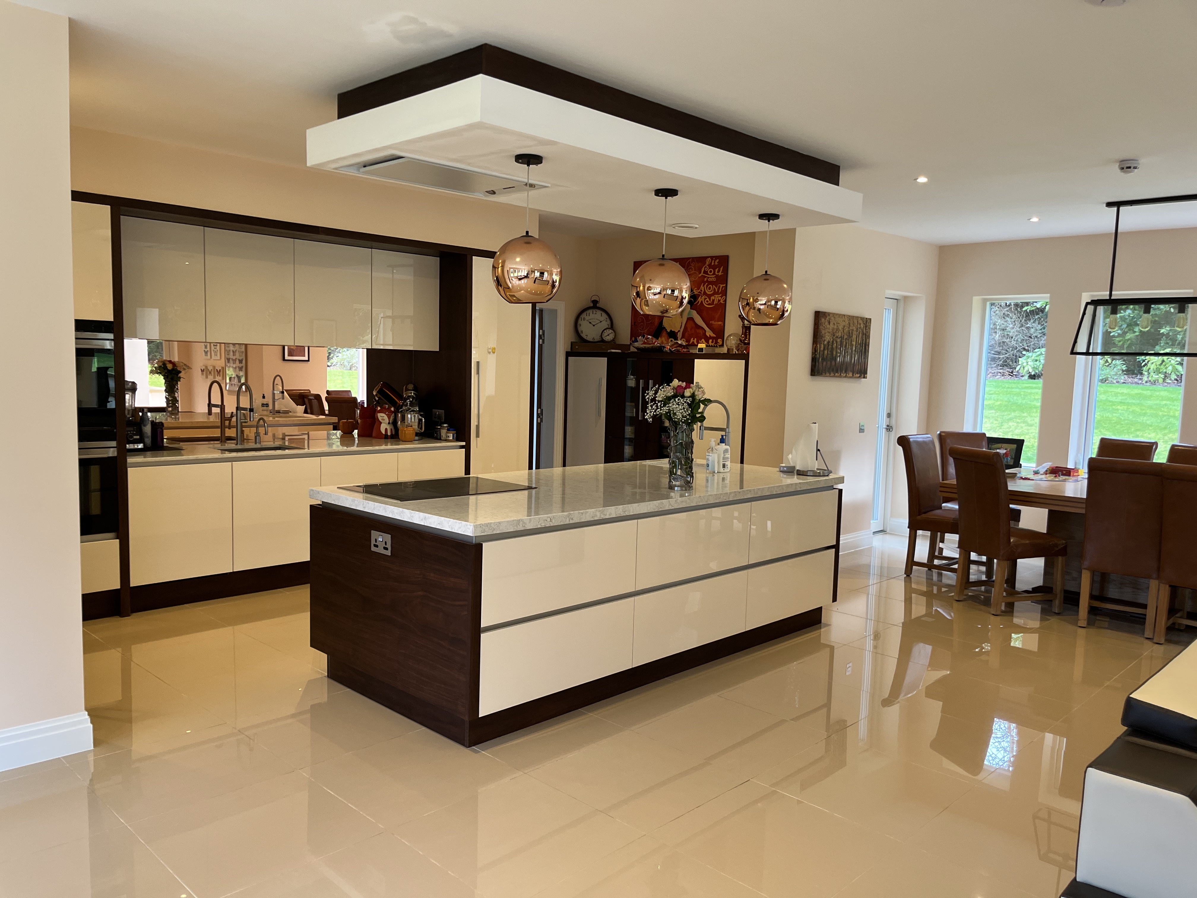

I just took these. 3pm and cloudy. The widows you see face south east, the sun is currently southwest.
All three side of the kitchen have windows except where the kitchen is
In order these are
1. No lights
2. Lights between the island and worktop and in the wings to the kitchen. 10x 5w GU10
3. All ceiling lights, adding in lights in the sitting area. 16x 5W GU10
4. Ceiling lights plus under cabinet and above island lights.
We use number 2 nearly all the time. If it is sunny outside, you can sit at the table without the lights on, but it is never quite light enough on the kitchen area to work. If it is very sunny and in the middle of the day, I notice that there is no difference at the table between lights on and lights off, but by that point someone has nearly always turned them on.
We basically never use the under cabinet lights or above island lights,  we do almost all prep work on the island.
I split the lights into two circuits, kitchen/entrance/table area and sitting area. I never turn on the sitting area lights, my family always turn on all of the lights.
By my calculation, the kitchen lights use more electricity than all the other lights in the house put together. This reflects spending a lot of time in the kitchen plus GU10s being a less efficient way to light an area so the kitchen have more bulbs to get a similar spread of light than other rooms.
I added a picture of the whole room with no lights on. I think it quite clearly shows that light doesn't penetrate much more than 2-3m into the room from the windows.
If I was redoing things I would also have put a couple of GU10s directly above the island, although it is well enough lit by the ones around the island. I would say it is much brighter above the island with just one set of lights on which I don't think the picture captures well.

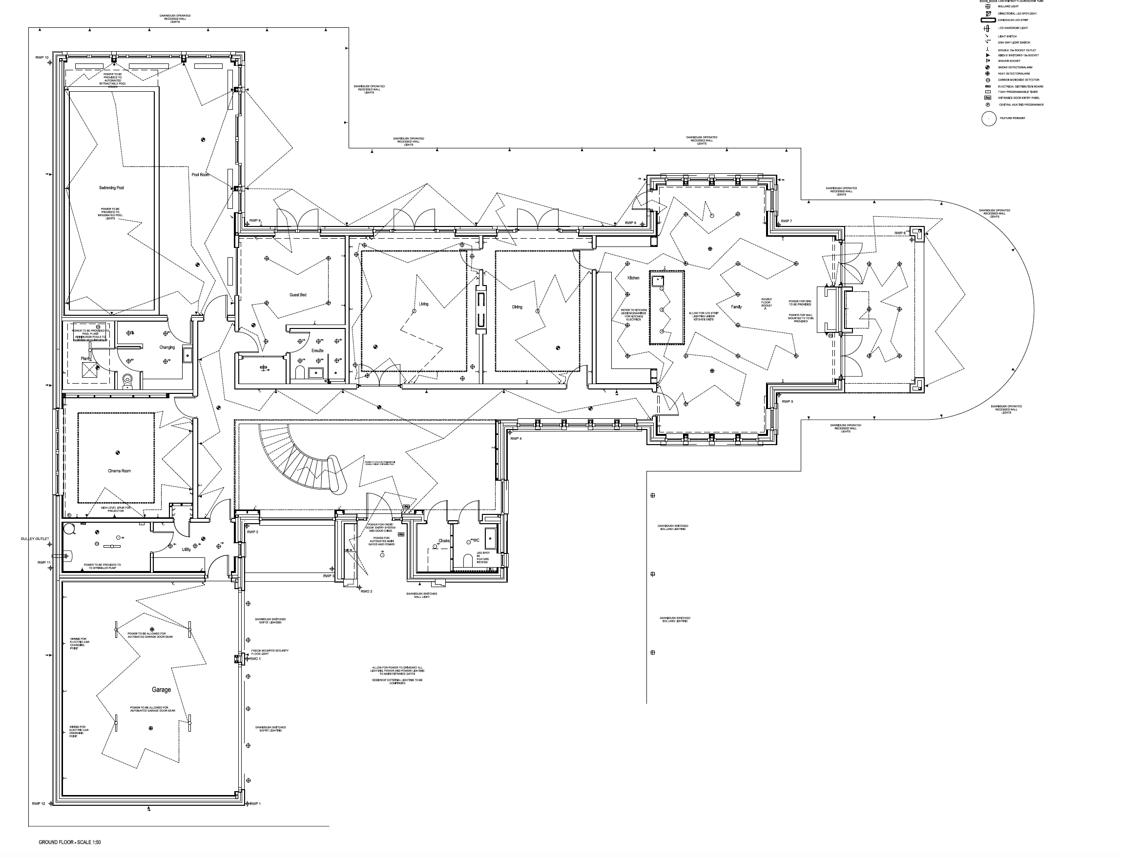

Long time since I posted these, i found one with the lighting plan n it. I did all the lighting plans myself, it took a long time -
The kitchen lighting plan is correct here, there were some changes to other rooms after this.
It is very dull and raining today. Yesterday was a bit brighter.
1. Lights off -
Table close to windows - 170 lux. The lux level varied between 190 at the window edge of the table and around 90 at the other side, showing how quickly it drops off as you go into the room.
Island - 30 lux
2. Lights on behind island and table -
Table - 220 lux
Island - 160 lux
3. All ceiling lights on -
Everywhere in the room was between 190 and 220 lux.

Nice! Your plan doesn't have any dimensions but eyeballing off the door widths in those 'side alcoves' I'm guessing they are effectively about 1500 deep on each side, so the island is about 2200 away from the closest window? 30 lux at 2m is not a lot, and indeed you need 200 for comfortable kitchening -  but I'm noticing the same here.

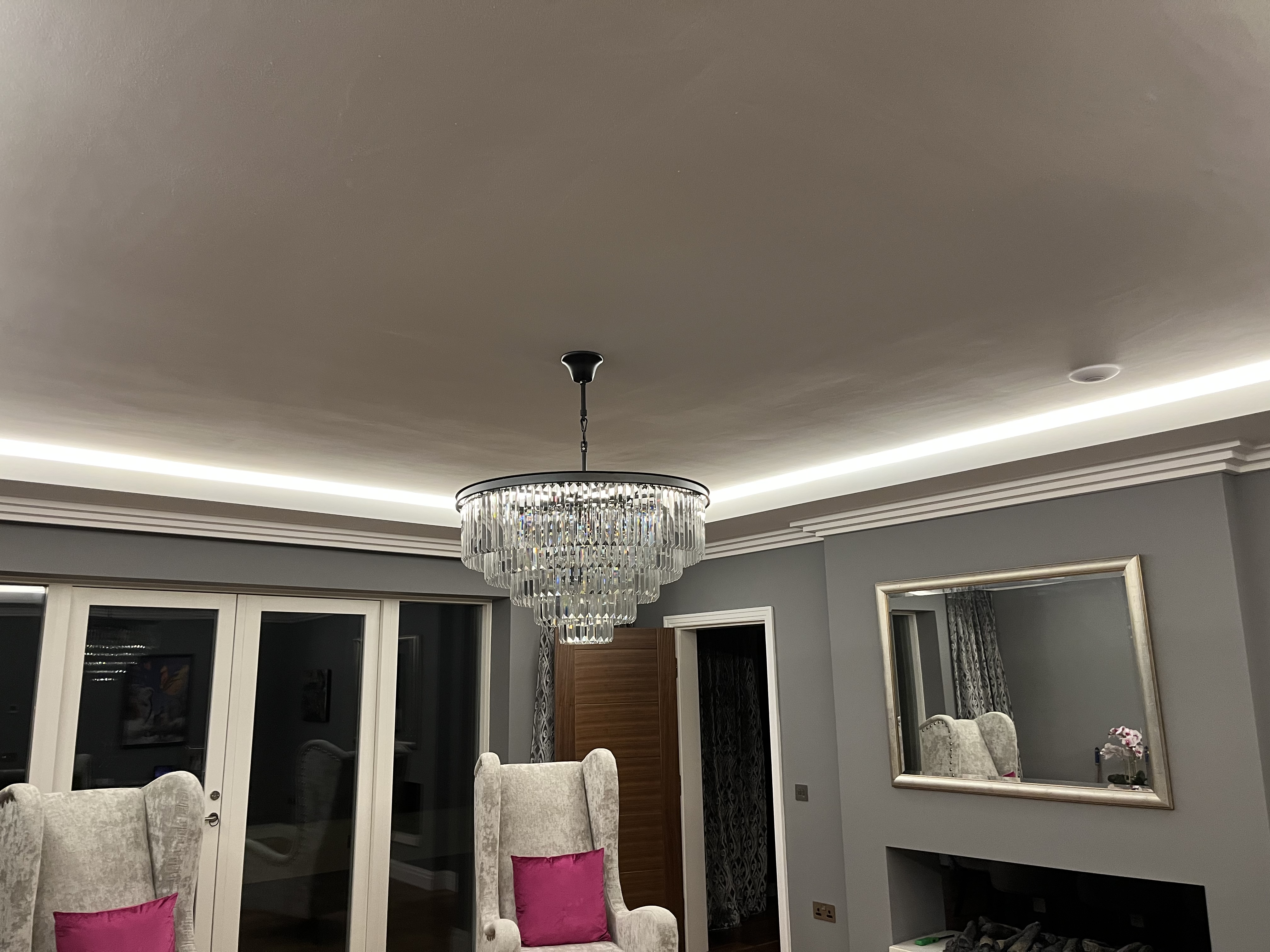

Slightly off topic but I also note in your living and dining you have a light string in a rectangle shape. Is this an actual pelmet, or did you just embed the lights in the ceiling straight down?
Link to comment
Share on other sites
The wings of the kitchen are 2m deep. It is 10m across so the centre of the island is over 5m from the nearest window.
But the inside edge of the table is only 2m away and even at that point it is already considerably darker.
The ceilings have a step with the sides 150mm below the centre and LED strips inside them bouncing off the ceiling.
