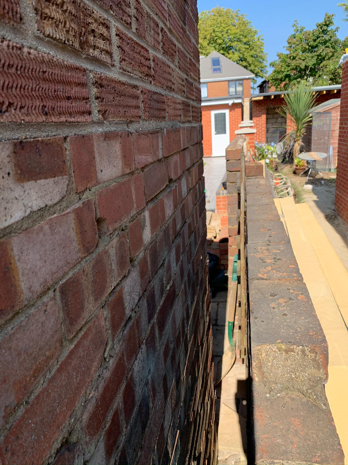

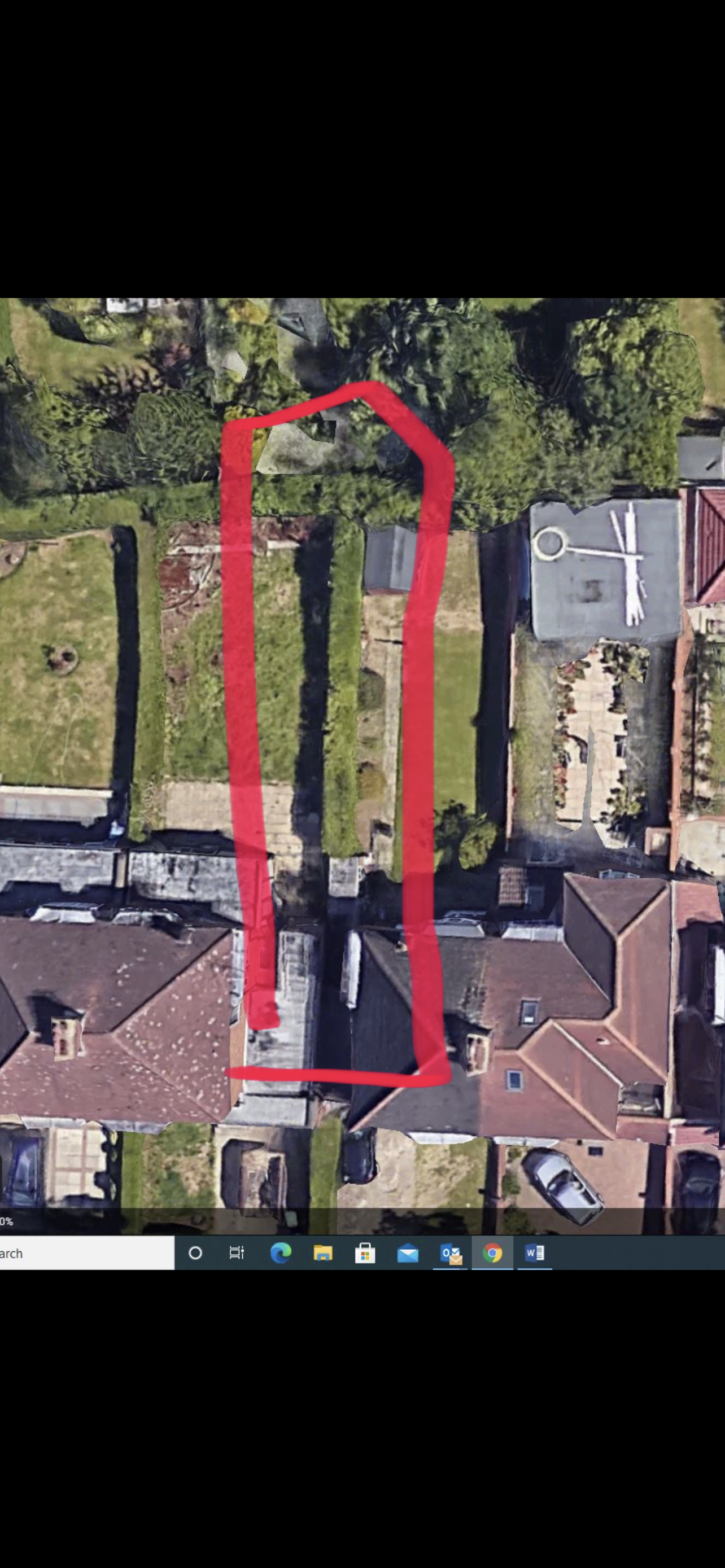

virat bhavsar Posted March 17, 2023 Share Posted March 17, 2023 in the both picture attacehd can any one give me clare idea of what and where is the party wall considered for the bounday wall? I am bit not sure about the title deed it says, in general about the 1996 partywall law where both side will have half and half rights. but as one can see in the picure the red box shows the hedge, which is no where in the middle of the boundary, its one side of the proprty more or less. please advise what to do in this situation? in the second piture shows two walls where the second wall was the small store which shows in the first piture befoer the hedge. Many thanks in advance. Link to comment Share on other sites More sharing options...

ProDave Posted March 17, 2023 Share Posted March 17, 2023 I am struggling to relate the 2 pictures. The first is a view presumably looking along the house wall? and then the garden wall, but I can't relate that to the aerial view. In the aerial view, are you left or right house? And what are you trying to do (or stop)? and what is the issue? Link to comment Share on other sites More sharing options...
Temp Posted March 17, 2023 Share Posted March 17, 2023 If you want to build right up to the boundary remember nothing must overhang, so you need to think about eaves and gutters. The boundary wall is also unlikely to have adequate foundations for an extension so the whole thing might need taking down and rebuilding. In the future a neighbour might also want to do the same and suddenly your house isn't a detached house anymore. That can devalue it a bit. Sometimes it's not worth building right to the boundary as it frequently seems to cause issues. Link to comment Share on other sites More sharing options...
saveasteading Posted March 17, 2023 Share Posted March 17, 2023 There is often the remains of a fence within a hedge. Or look at the ends for signs of previous connections Link to comment Share on other sites More sharing options...
