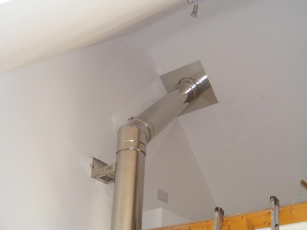

ProDave Posted March 16, 2023 Posted March 16, 2023 If you take it up outside, it will have to be quite tall and with stays. How about up the corner, then following the roof line and out at the ridge, a bit like ours in the bedroom, though in your case as close in to the roof line as you could get it.
Ralph Posted March 16, 2023 Author Posted March 16, 2023 That's a thought. The flue will have to be almost as tall as the roof line to avoid the velux windows we have. The only thing that bothers me about coming out the roof is how crap the roof flashing will look on our standing seam.

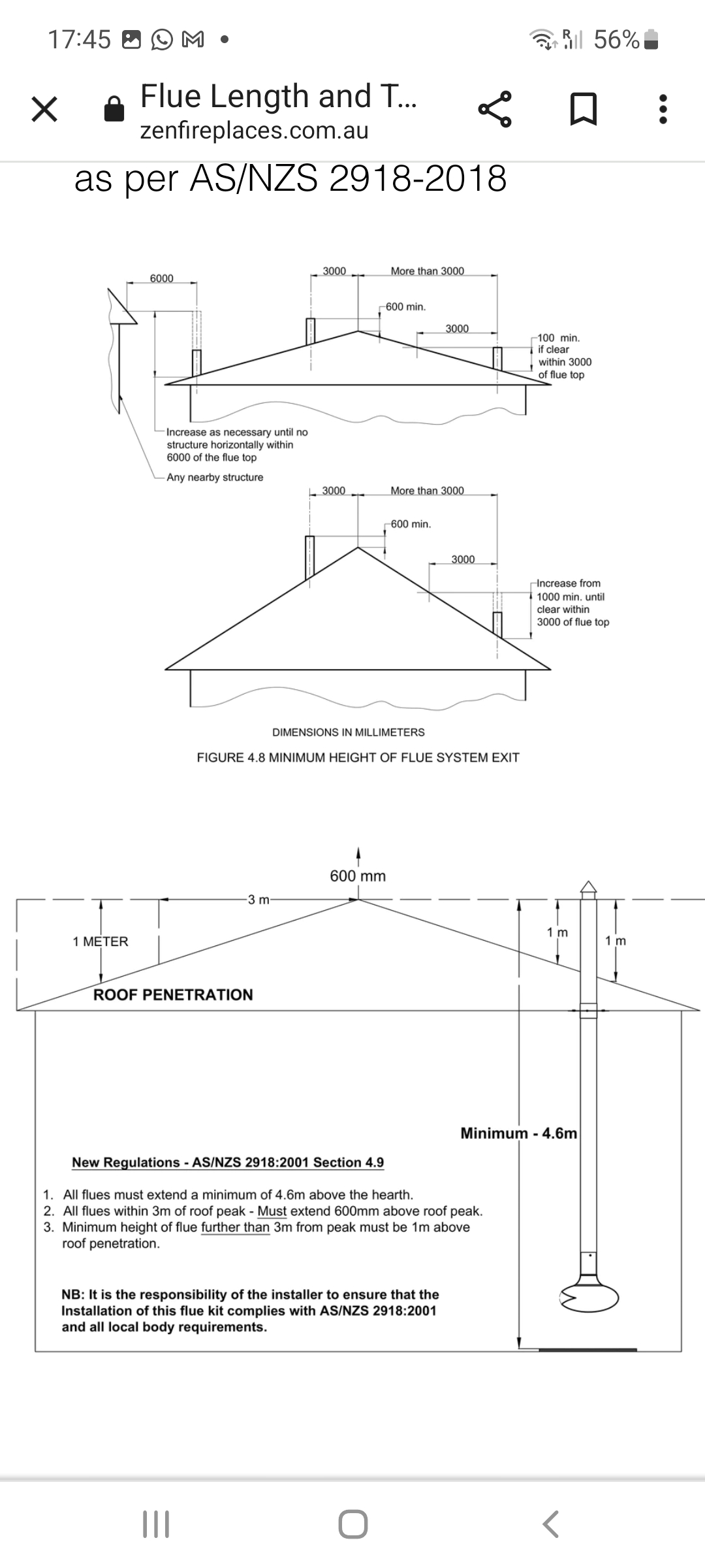

saveasteading Posted March 17, 2023 Posted March 17, 2023 Great pic. Have you checked the height rules? I'm not saying this attachment is correct but I found it quickly.
Ralph Posted March 17, 2023 Author Posted March 17, 2023 I think the one that affects us is to make it 600mm above the top of the velux
Ralph Posted March 17, 2023 Author Posted March 17, 2023 On second thoughts that may be 1 meter in Scotland
