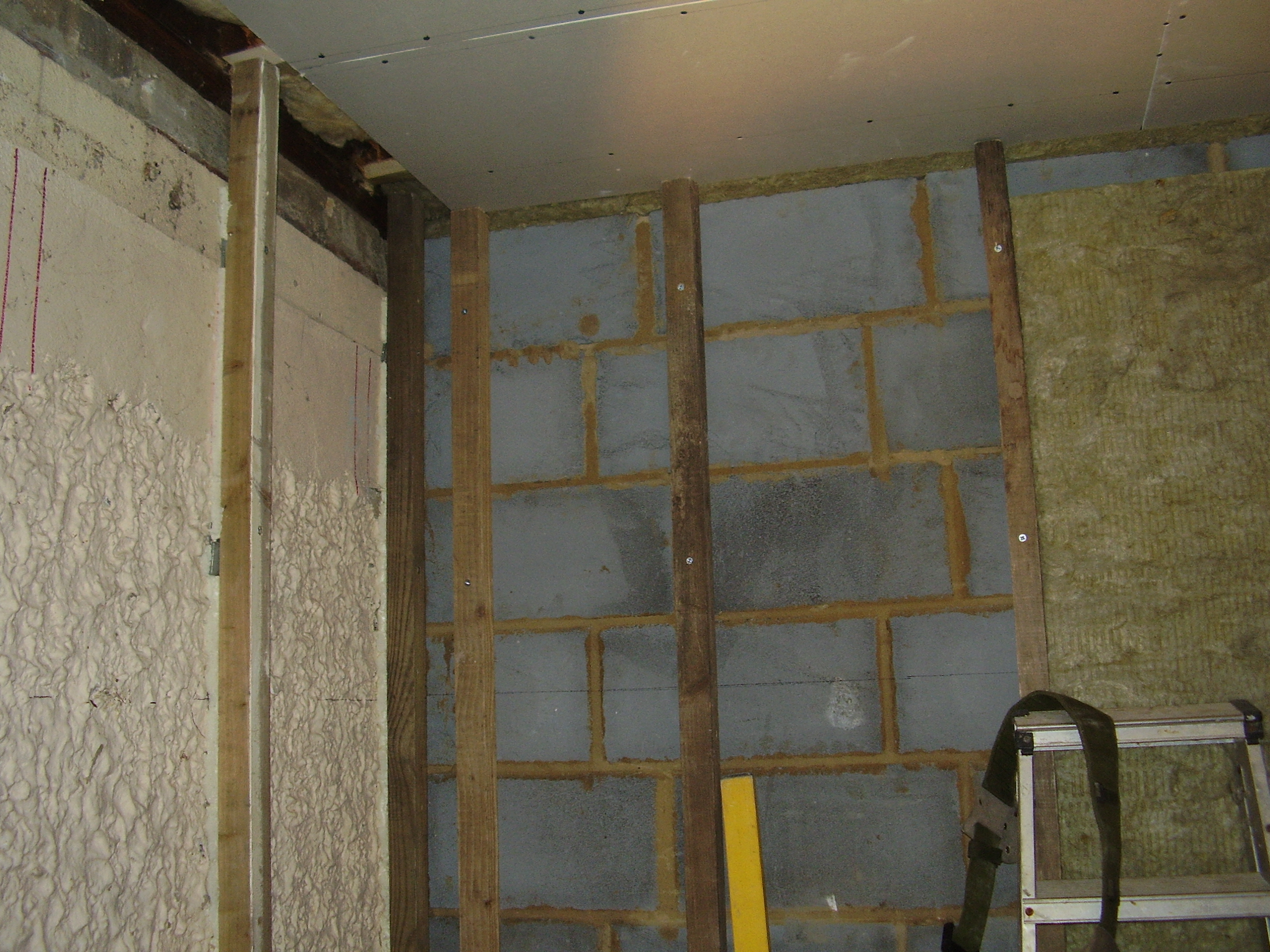

Onoff Posted June 5, 2016 Share Posted June 5, 2016 Not for a professional I'd agree but for the occasional user they're great. I've used one and IMHO they do what they say on the tin. The bed gets laid about 12mm thick then with a tamp ends up at 10mm. I wetted all my blocks first and got the mix just. It's a doddle tbh. Very little, if any waste so less to worry about muck falling down in say a cavity. Have lent out to a couple of mates who found it good too. The little clip on string line clips are inspired IMO. I do then faff about an point all the joints with a mortar gun.....then go over them with a paint brush to work it in, then over fill again and rub off the excess with a block when going off so all smooth. No gaps in my blockwork! This was a bit of a pig. I had a single skin, rickety out house. I put a second skin up on the inside using the Bricky with Easy-fix ties tied into the new skin as I went. 60mm gap with 50mm Rockwool batts. Then more batts on the inside and another 50mm of Rockwool. Got the idea from the Make It Up As You Go Along School of Building! If only I'd known about eBuild then. About the only good bit is I've got about 350mm of fluffy insulation in the roof. Link to comment Share on other sites More sharing options...
