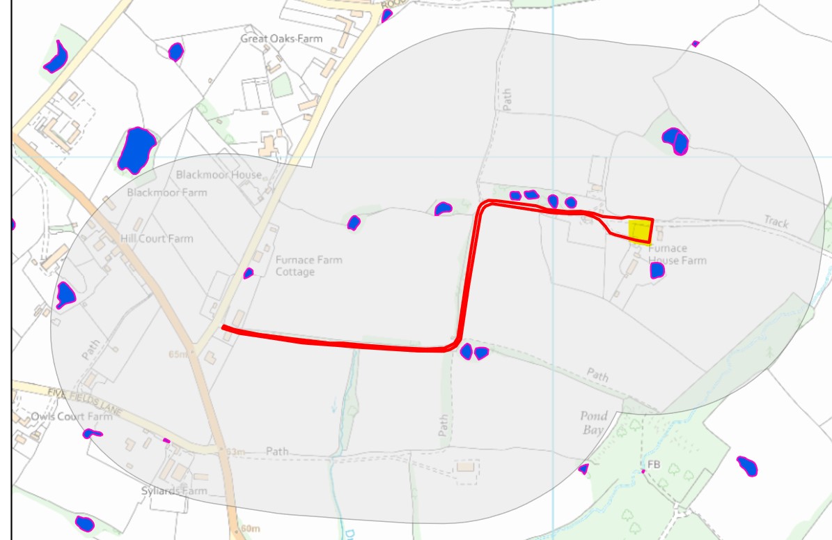

Furnace Posted March 17, 2023 Author Posted March 17, 2023 Thought I'd post a dispiriting update. I applied to the Natural England District Level Licensing Scheme for a Compensation Payment quote. £570 +VAT for the enquiry. £2754.40 +VAT for the Compensation Payment £690 (no VAT!) for the Licence Total £4679.28 This is the cost due to 11meters of hedging being removed because of an access issue. The Compensation Payment is calculated based on the number of ponds being impacted. The ecology report states that the groundworks area affects 6 ponds. NE assesses this by reference to the Red Line Boundary of the site and all ponds within a 250m buffer zone around it. LPA require the RLB to include access to the site, and since my plot (highlighted in yellow) is 600m down a drive to the main highway, it affects 14 ponds. I've challenged Natural England to review this and have been rebuffed twice. I'm suitably dispirited.

Furnace Posted March 17, 2023 Author Posted March 17, 2023 6 minutes ago, ToughButterCup said: And I'm outraged for you. Solidarity in adversity. I'm particularly frustrated since I donated 3 ponds elsewhere on the farm to the NE restoration scheme. Breakdown of the £17,215 cost of a replacement pond is attached.NEpond costs.pdf
Furnace Posted March 17, 2023 Author Posted March 17, 2023 54 minutes ago, Redbeard said: How do you get on with your MP?! I hope he's got better things to do, but I may well raise a complaint at the lower level if my fortitude survives the interaction with the environmental consultant who wishes to take up residence to supervise all ground works. Including installing an orange geotextile membrane and replacing all top soil in areas that tested negative for contamination 'just in case'.

saveasteading Posted March 17, 2023 Posted March 17, 2023 If you don't mind me saying, I think your letter needs a statement of your complaint at the start. Unreasonable, disproportionate, and pointless because no newts will be protected. Then how you already made a pond, which is more than recompense. (It's a shame your newts didn't have names.) And that this is 11m of an x m hedge. You now offer a.....newtorium or whatever, which will help newts in your area whereas cash is of no use to them, but nice for consultants. And what you want is..y Would I be right in suspecting that your planning agent suggested these consultants? Could be too close. Tried a chat with the ones I suggested in the pm?
Furnace Posted March 17, 2023 Author Posted March 17, 2023 8 minutes ago, saveasteading said: Would I be right in suspecting that your planning agent suggested these consultants? Could be too close. It was a recommendation, however there were no self-serving suggestions for "follow on" work so I don't feel led up a garden path in this instance. 16 minutes ago, saveasteading said: Tried a chat with the ones I suggested in the pm? I haven't spoken with the ones you mentioned. I confess I feel out of my depth in saying "I've had the result of a Preliminary Ecological Appraisal, and the conclusion is going to cost me £4.5k. Can you suggest an alternative?". I pushed back at the current report author with suggestions of "Is there another way we can present this to better serve the newts' interests?" and got a "There is an impact and that's how it must be remedied" response. There only really seem to be two ways to deal with it. One is "find" an ecological consultant who agrees it's all madness and declares there's no impact. The other is to follow the mitigation rules, but argue that they're inappropriate for this development and try to minimise them. I might get it down to £2.5k if they agree with my approach. I've never done this before so am completely open to suggestions and advice - it's my first rodeo.
saveasteading Posted March 17, 2023 Posted March 17, 2023 Yes you wonder how rude you dare to be. I bet you wish this hedge had died mysteriously last year. There has to be another way that it would be ridiculous to argue against. I don't think there is any 'closed shop' so try the competition. Just a phone call, and nothing to lose.

Furnace Posted March 30, 2023 Author Posted March 30, 2023 (edited) Another edge of your seat update..... I pushed back even further... Thanks so much for your message and for discussing the matter internally - I really appreciate the flexible approach. I'd like to push back a little on the proposed methodology since it does have a material impact on the cost. Below is the boundary of the groundworks area shown in red (previously submitted as DLL_works.kml, attached) showing a 250m zone centred on the south-eastern corner. This zone excludes the two ponds to the west, and includes only the six ponds detailed in KB Ecology's report. I believe in this rural instance it is appropriate to consider only the 'works area', since the broader 'site area' is to be untouched. I look forward to hearing your thoughts. ...and received this reply After further discussion we have decided that in this instance we are happy to use the groundworks under the understanding that the wider site area will be untouched. It’s important to highlight that a GCN licence under DLL will only cover works within the groundworks area and any works outside of this will be at your own risk and not covered by the licence. I shall draft a new IACPC & issue it formally shortly, this will include a reference to the above along with an updated Output map for the groundworks area. That reduces the Compensation Payment from £3,305.28 to £908.98 I'll call it a day at that. Edited March 30, 2023 by Furnace added map 1
saveasteading Posted March 30, 2023 Posted March 30, 2023 Settle for that. Everyone happy. But this is what your newt consultant should have done for you.
