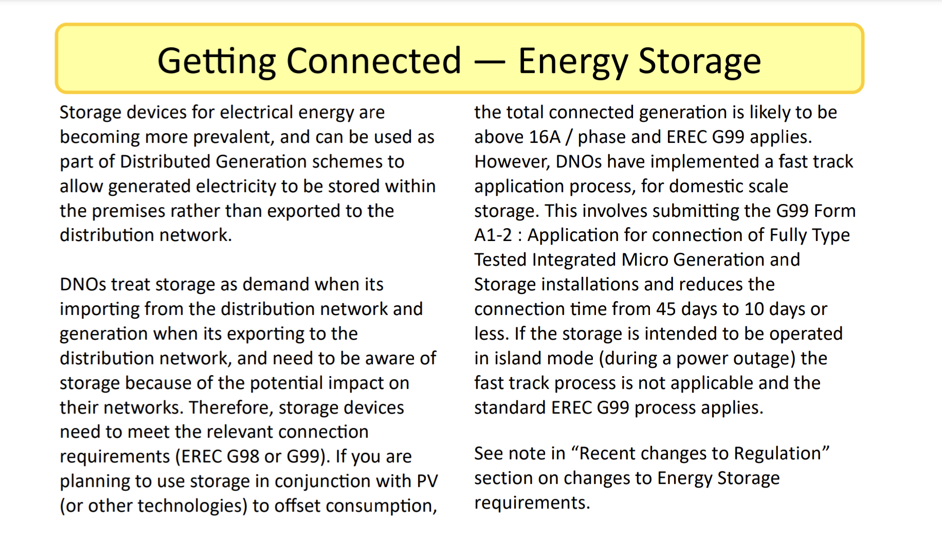

yebaws Posted March 6, 2023 Share Posted March 6, 2023 Currently have 3.65 Kw solar PV installed, with 3.68Kw inverter. DNO notified with G98 and that's all fine... Now looking to install 6.4KWh battery storage with 3.6Kw hybrid inverter / charge control unit. Solar PV is on the roof of an outbuilding about 100m away from house and feeds back to house CU through SWA cable. As the charge controller needs a CT clamp connection to the supply coming into the house CU in order to detect export, it wasn't practical to have the batteries up by the panels, so they will be in the house near the consumer unit and connected to the AC supply. This also means that we can charge the batteries at night with off-peak electricity as well as excess solar. Once installed, I will need to submit a separate G98 form to DNO. What are the rules about this? Could they refuse / request a G99 application, saying that I will have more than 3.68Kw exporting capacity? In practice, we would never be exporting from both the PV inverter and the battery inverter at the same time (the whole point of the battery storage is to reduce the amount of electricity we're exporting for free), but the battery inverter does have a "force discharge" option, so it would be possible to do it. Help much appreciated. Link to comment Share on other sites More sharing options...
SteamyTea Posted March 6, 2023 Share Posted March 6, 2023 46 minutes ago, yebaws said: What are the rules about this? Could they refuse / request a G99 application, saying that I will have more than 3.68Kw exporting capacity? In practice, we would never be exporting from both the PV inverter and the battery inverter at the same time It matters not two hoots how you use the system. All that matters is if it is capable of exporting more that the 16A per phase. So either redesign so it can't, or apply for G99 before you start. 2 Link to comment Share on other sites More sharing options...

joth Posted March 6, 2023 Share Posted March 6, 2023 (edited) 1 hour ago, yebaws said: Also, I find it strange that a lot of sites (https://www.deegesolar.co.uk/dno_for_solar_panels/ for example) say that you only need to notify DNO if your battery storage has EPS / UPS. Yeah that's misleading, it's saying *additional* DNO notification is then needed, besides the G98/99. Page 34 of this guide is useful: https://www.energynetworks.org/assets/images/Resource library/G99 Type A Full Guide.pdf "G99 Form A1-2" apparently is your friend. Edit: actually probably not, reading that form it only applies to hybrid (integrated) PV + storage inverters Edited March 6, 2023 by joth Link to comment Share on other sites More sharing options...
