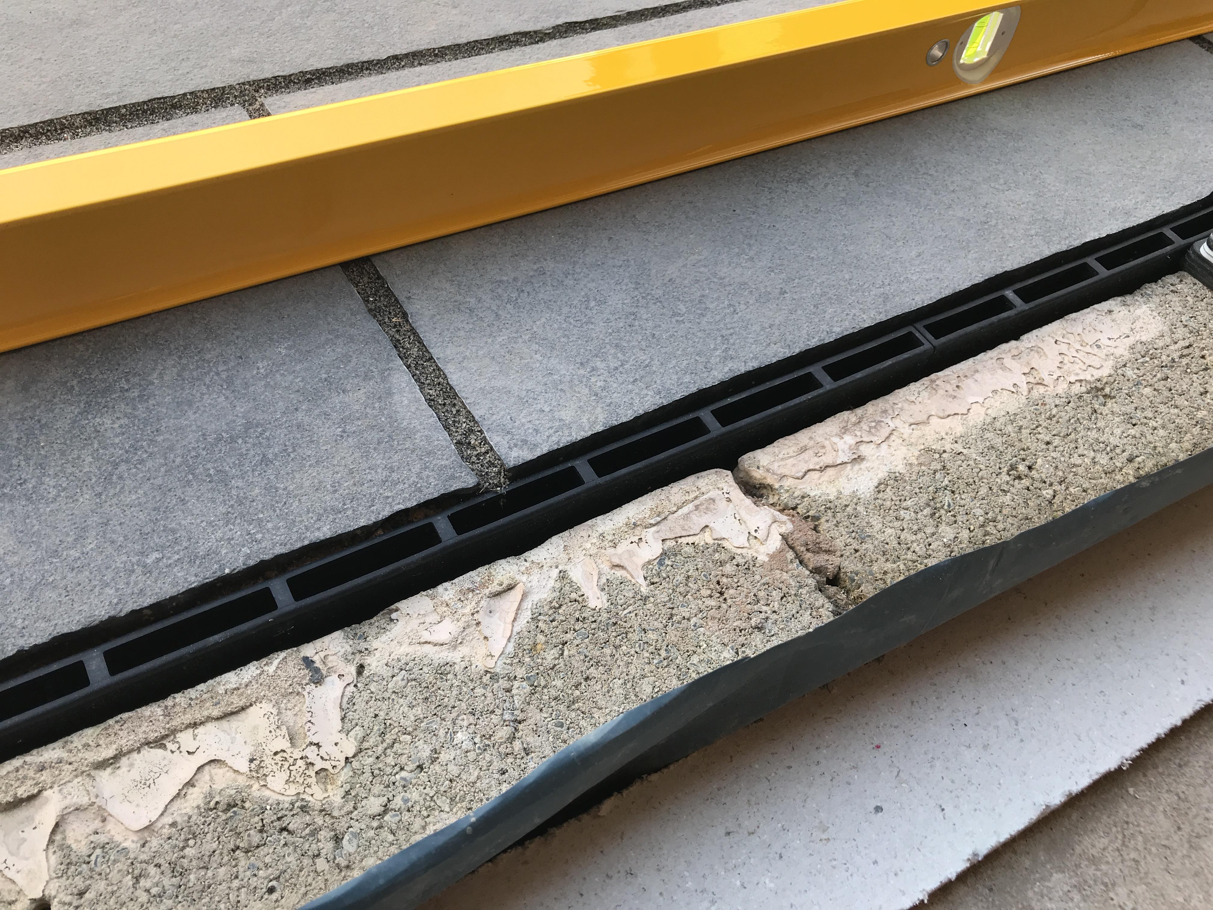

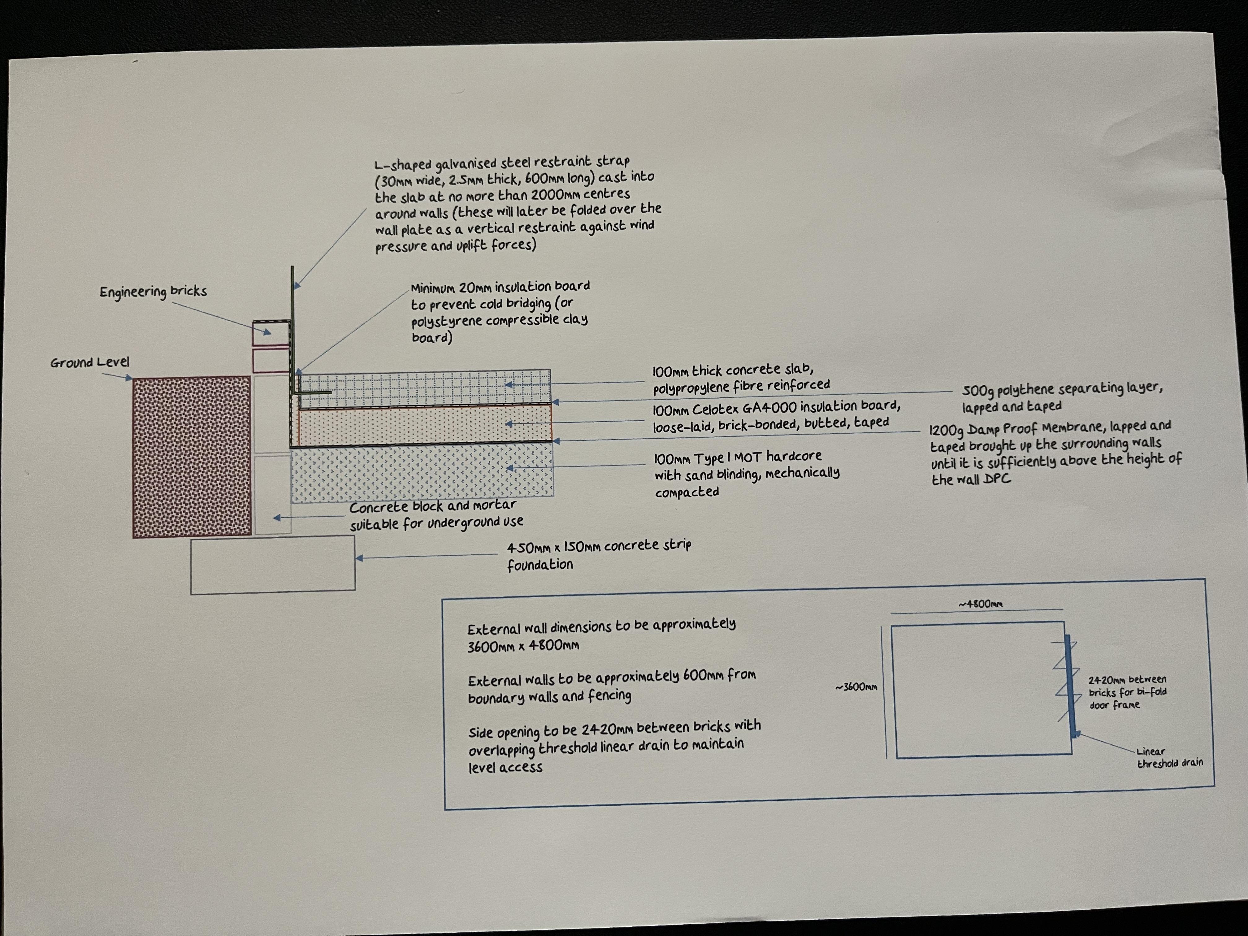

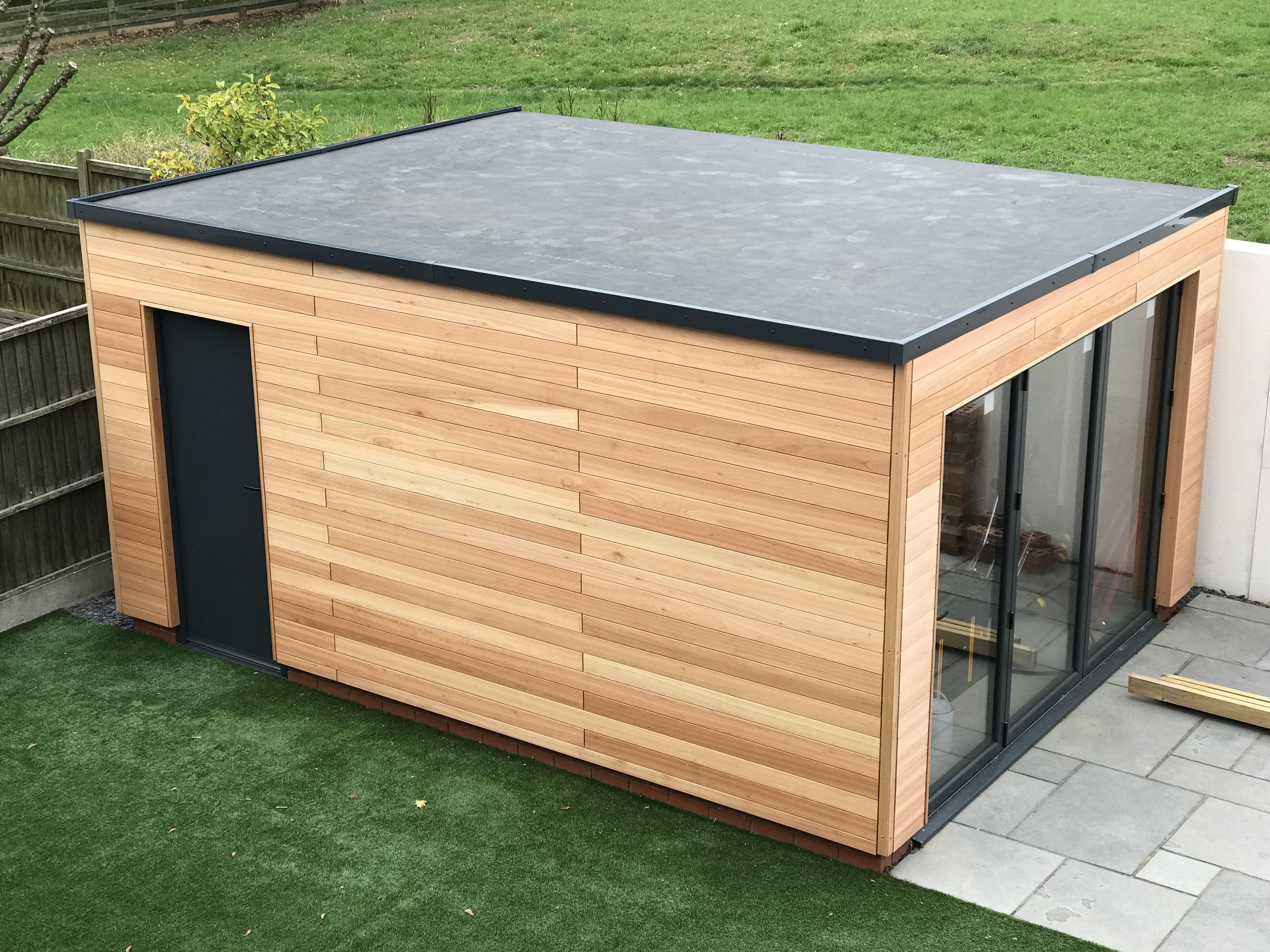

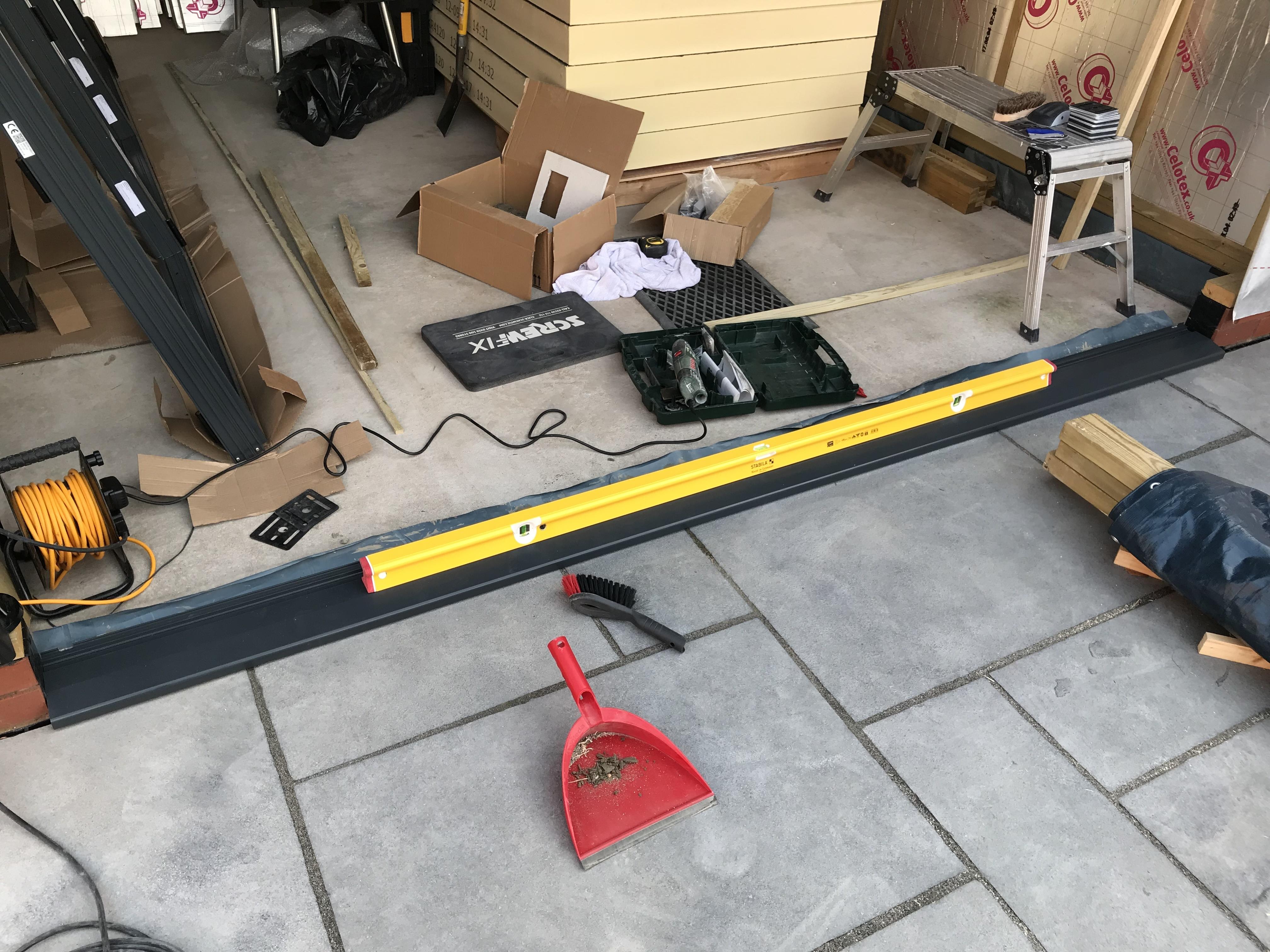

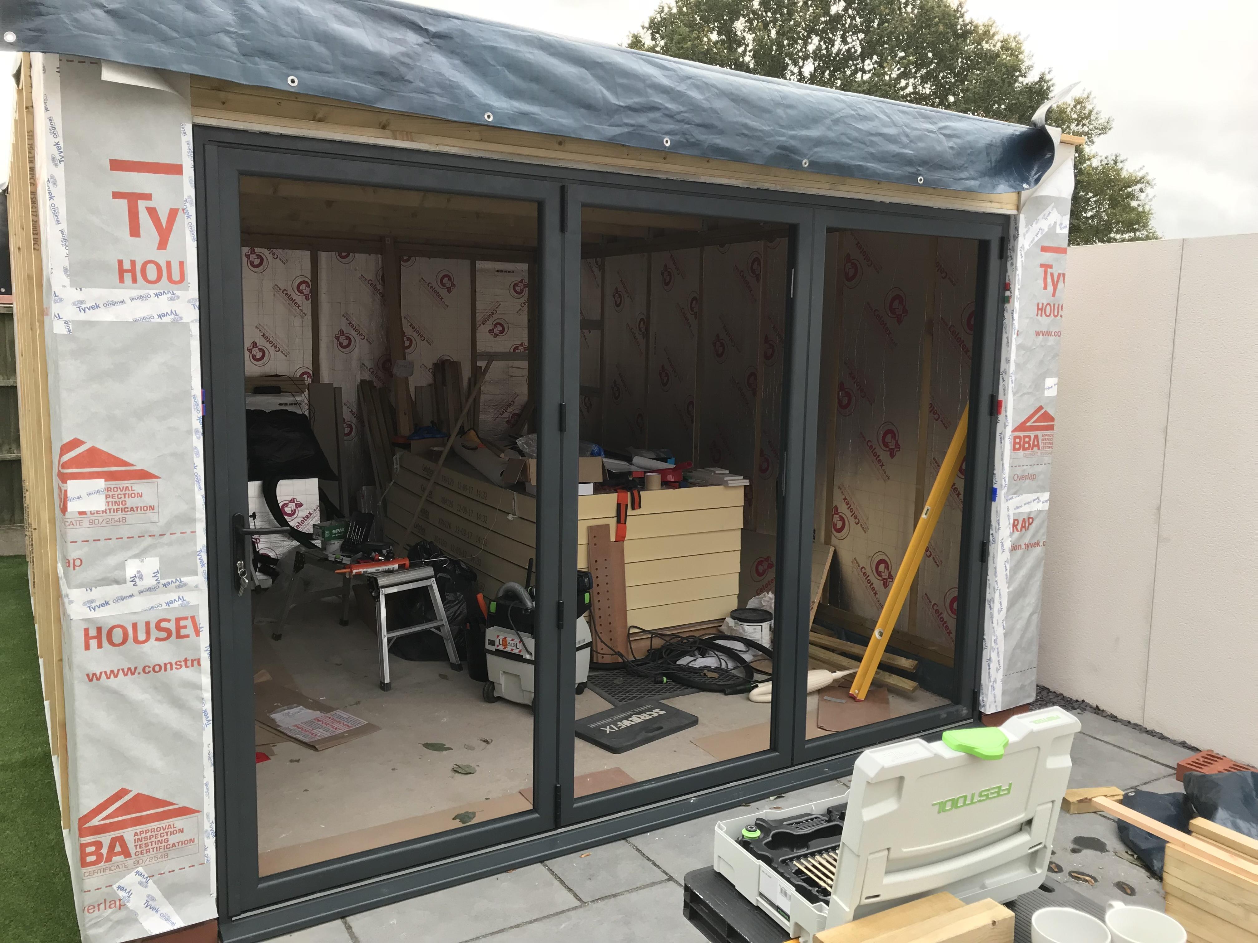

garrymartin Posted June 19 Share Posted June 19 1 minute ago, IanR said: I'm not sure that too many people are putting insulated rafts/slabs under garden rooms Never let me be accused of not bucking a trend... 😉 I put in an insulated slab without UFH, but there are no load-bearing structures on it. The superstructure sat on strip foundations / blocks / bricks and the bifolds sat on strip foundations / blocks. See the attached for info, but feel free to ask any further questions. This was 7 years ago, and I'm not saying I'd do it exactly the same again, but I've been very happy with it and even in the winter, the tiled floor remains a reasonable temperature. Zero issues. 1 Link to comment Share on other sites More sharing options...

IanR Posted June 19 Share Posted June 19 5 minutes ago, garrymartin said: Never let me be accused of not bucking a trend... But what you've done there is more typical, I'm assuming the recent poster has chosen this thread for the insulated raft, which does take the load bearing walls. 1 Link to comment Share on other sites More sharing options...
garrymartin Posted June 19 Share Posted June 19 1 minute ago, IanR said: But what you've done there is more typical, I'm assuming the recent poster has chosen this thread for the insulated raft, which does take the load bearing walls. It was primarily to show how I'd dealt with the bifolds, but fair point. 1 Link to comment Share on other sites More sharing options...
IanR Posted June 19 Share Posted June 19 1 minute ago, garrymartin said: It was primarily to show how I'd dealt with the bifolds, but fair point. But with a strip foundation and plinth wall there's an easy solution to the bi-fold, that and insulated raft doesn't have... Link to comment Share on other sites More sharing options...
garrymartin Posted June 19 Share Posted June 19 1 minute ago, IanR said: But with a strip foundation and plinth wall there's an easy solution to the bi-fold, that and insulated raft doesn't have... 🤣 In my defence, you did say "insulated rafts/slabs" and I definitely have an insulated slab... 😉 Link to comment Share on other sites More sharing options...

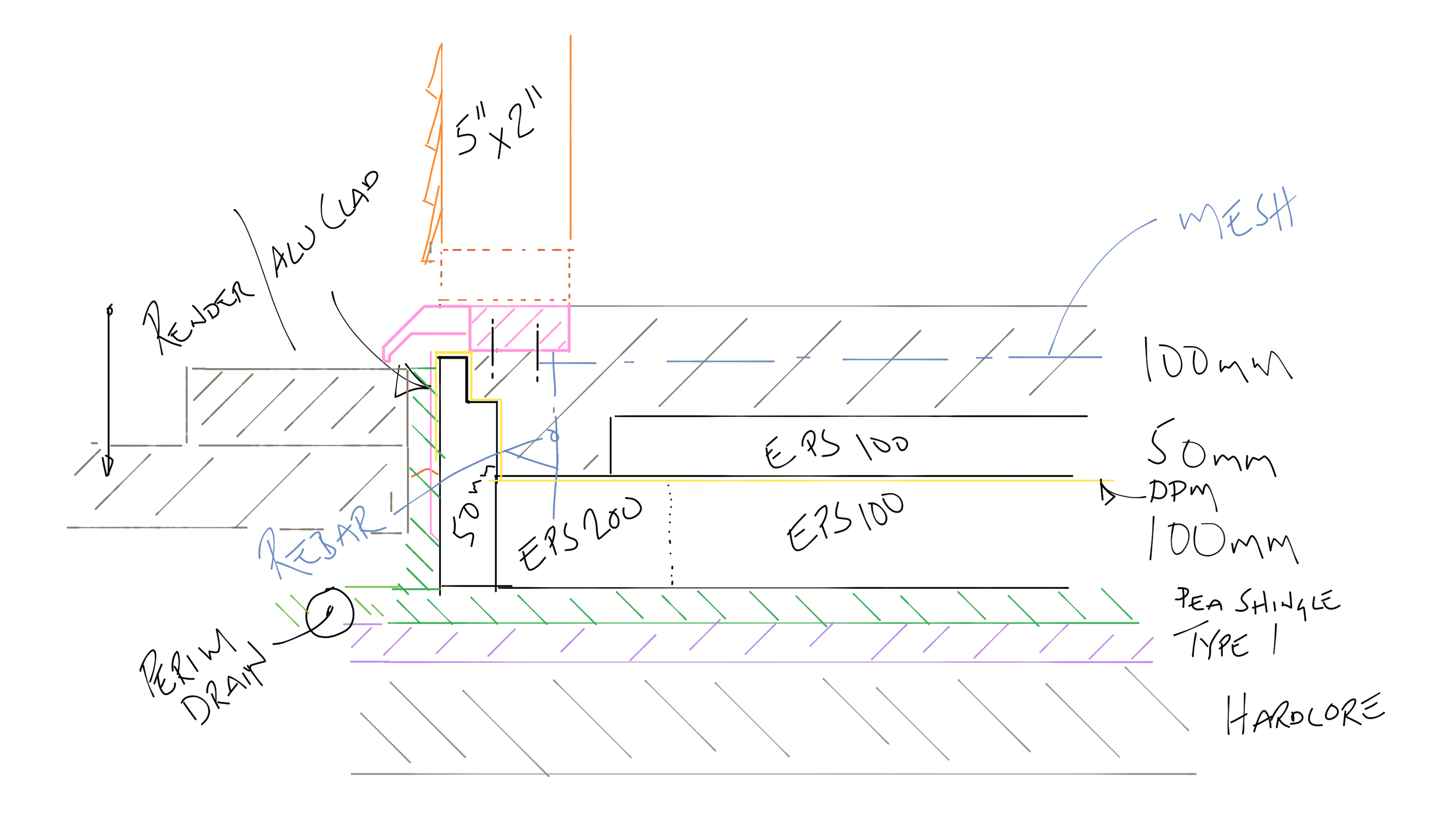

FozzieKev Posted June 23 Share Posted June 23 (edited) On 01/03/2023 at 19:27, IanR said: Here's my go at an over-engineered insulated raft, for a Garden Office. As per @Iceverge, ground should be around 150mm below the finished floor level. No separation layer needed for EPS. To do the chamfer detail on the upstand you'd need to make up a hot wire cutter. If not then a thinner upstand (25mm) will do. Upstand can be stuck and screwed to the base layer. You could, almost definitely, do it all in EPS100, rather the the EPS200 I've shown under the ring beam, as you won't be having a heavy roof finish on that 5° pitch. So I was looking at this and thinking how would you go about putting bifolds in. My guess now would be to strip foot the front to the width of the bifolds, and use some engineering bricks/blocks for the bifolds to sit directly on tied back to the slab through the EPS. Edited June 23 by FozzieKev Link to comment Share on other sites More sharing options...

IanR Posted June 25 Share Posted June 25 On 23/06/2024 at 21:58, FozzieKev said: So I was looking at this and thinking how would you go about putting bifolds in. There's a number of different options, depending on what you are trying to achieve. If you planned a heated floor (UFH) that would be used all winter then it's worth considering something more complex, but if you do not plan to heat the floor then a cold bridge along the bi-fold frame to floor is less of an issue. The simplest option, to get a low threshold for the bi-folds would be to recess the raft to create a shelf for the bi-folds to sit in (cutting away the EPS upstand as required) and have a local step on the outside with a drainage path between the back of the step and the side of the raft. To take this much further you'll need to share more info on plan for upper structure, planned surface outside the bi-folds, generic section of bi-fold frame and where the bi-folds drain to. Link to comment Share on other sites More sharing options...
