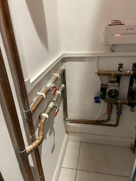

Hot water only making its way to manifold if central heating is on
Hi, hoping one of the UFH experts can help with an unusual issue 🙂
When the central heating is off and the UFH is calling for heat - the actuators open up, the boiler fires up, however the hot water feed to the ufh mixer valve is lukewarm and temperature never gets above 24 degrees going into the loops and return is 20 degrees. Therefore the floor never reaches desired heat on the thermostats.
However, when I fire up the central heating, the hot water feed to ufh mixer valve is red hot and and temparature reaches 45 degrees going into loops and return is 45 degrees. The floor then warms up over the next 2 hours to desired heat on the thermostats.
Why could this be happening? The ufh supposedly has its own feed from the boiler, so should be independent of the central heating.
Ive attached pics of the ufh pipe work, manifold and actuators. Also a pic of the 3 way valves for the central heating and hot water for the unvented cylinder - both set to auto and running via hive system.

Plumber has wired the UFH boiler signal into the boiler direct, not to the wiring centre as a good guess. That means the boiler fires but the pump is pushing against the 3 way and it’s not fully open - when the central heating controller kicks in then it opens the 3 way valve and then the boiler fires from the mid position signal, and everything gets toasty.
Without seeing it I’m guessing but it supports why the system doesn’t get warm
Thanks both for speedy responses, really appreciated. The boiler is firing up and like you say times out and tries again. Before exploring the buffer option, how would I check if the UFH boiler signal is into the boiler direct instead of the wiring centre?

In this picture the vertical pipes obviously come from the boiler but where do they go after passing the tap off for the UFH?
When it's in the not working state (CH off UFH on and calling) do these vertical pipes get hot? I know you mentioned the manifold only gets warm but what about these vertical pipes?
In the pic the pipes are directly under the airing cupboard and switches for CH and HW. The boiler is in the garage behind the wall where the manifold is positioned.
When it’s in not working state the hot water pipe (left hand side) is luke warm. When I switch central heating in it gets red hot. At first it is hot from ceiling to the pass off to the UFH. And they remain cooler beyond the pass off to the floor. After an hour they are hot.
I’ve also observed when it’s in not working state the pipes in and around the switches in the airing cupboard are always hot. It’s as if the hot water gets to the switches and stop, trickle trickle through. Then fully pass through when central heating is on.
I think this points to what @PeterW suggested. Nothing opening the valve when only UFH is calling for heat.
I'd get someone to look at it. Make sure they know its never really worked and show them the above.
