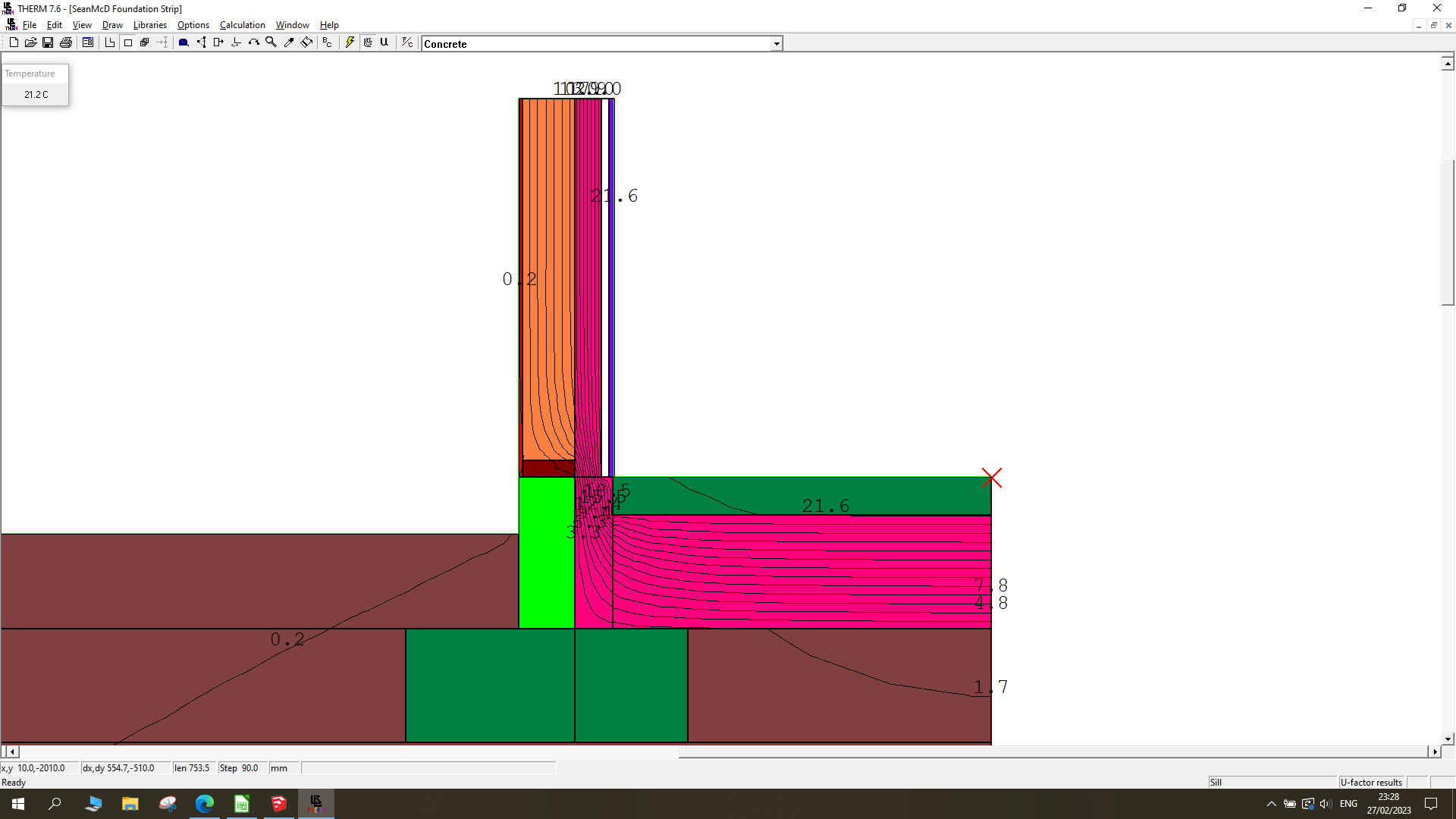

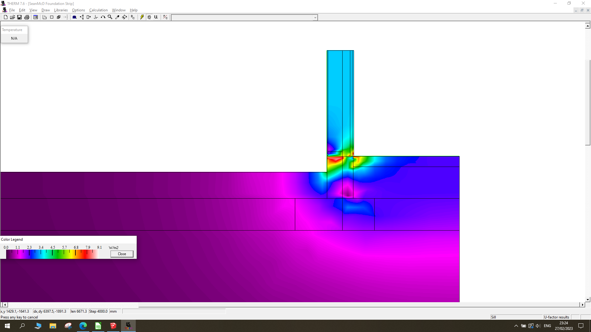

Iceverge Posted February 27, 2023 Posted February 27, 2023 You could easily get a 100mm pir upstand beside a 300mm EPS and 100mm concrete slab with a strip foundation. This gives an external psi value of -0.06W/mK. Better than the Passivhaus requirement of 0.01 W/mK. In fact with an insulated raft it would be tricky to join all the insulation together as your PIR is inboard of the loadbearing stud.
Shaun McD Posted February 28, 2023 Author Posted February 28, 2023 42 minutes ago, Iceverge said: You could easily get a 100mm pir upstand beside a 300mm EPS and 100mm concrete slab with a strip foundation. This gives an external psi value of -0.06W/mK. Better than the Passivhaus requirement of 0.01 W/mK. In fact with an insulated raft it would be tricky to join all the insulation together as your PIR is inboard of the loadbearing stud. Sorry if this is a very naive question but is eps different than the normal foil backed boards by Kingspan etc? Is it just that you need a greater depth of eps than pir/put (if that's what they are called) to achieve the same u value?
mike2016 Posted February 28, 2023 Posted February 28, 2023 You'll see EPS (U 0.37) used to package some heavy electronic items, it's very dense and doesn't dent easily, stands up well to compression. PIR (U 0.22) uses a foam with foil either side and is very brittle, dents easily and while it has a better U Value wouldn't be my choice to withstand 150mm of poured concrete! And as depth is just the cost of excavating and muckaway, digging a little deeper makes getting the required U value achievable. I've used PIR in my two metal shed floors but with plywood over it. They all have their use cases.
Shaun McD Posted February 28, 2023 Author Posted February 28, 2023 2 hours ago, mike2016 said: You'll see EPS (U 0.37) used to package some heavy electronic items, it's very dense and doesn't dent easily, stands up well to compression. PIR (U 0.22) uses a foam with foil either side and is very brittle, dents easily and while it has a better U Value wouldn't be my choice to withstand 150mm of poured concrete! And as depth is just the cost of excavating and muckaway, digging a little deeper makes getting the required U value achievable. I've used PIR in my two metal shed floors but with plywood over it. They all have their use cases. Ok so is just a thickness thing? Use 300mm eps instead of 150mm pir? Cost wise is eps cheaper to get the same u value?
Conor Posted February 28, 2023 Posted February 28, 2023 22 minutes ago, Shaun McD said: Ok so is just a thickness thing? Use 300mm eps instead of 150mm pir? Cost wise is eps cheaper to get the same u value? Yes, plus is nicer to work with and has much higher load bearing capacity - remember on an insulated raft the insulation has to take the loadings from the entire building.
Shaun McD Posted February 28, 2023 Author Posted February 28, 2023 3 minutes ago, Conor said: Yes, plus is nicer to work with and has much higher load bearing capacity - remember on an insulated raft the insulation has to take the loadings from the entire building. Great to know, had no idea about this, makes perfect sense but was always thinking it would be a PIR job. Thank you all for the input! On a slightly related note, has anyone used these door thresholds to make life simpler? https://passivesills.com/door-threshold/
