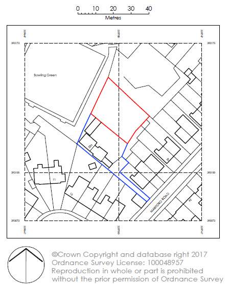

Ferdinand Posted July 25, 2017 Share Posted July 25, 2017 (edited) @Badger We need that location plan , otherwise you are about to get 137 ideas about your bungalow, of which at least 3 will be completely relevant . F Edited July 25, 2017 by Ferdinand Link to comment Share on other sites More sharing options...

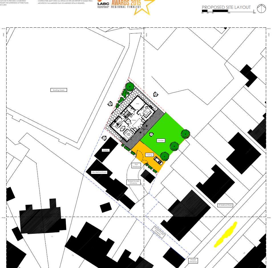

Badger Posted July 25, 2017 Author Share Posted July 25, 2017 (edited) I'll take a photo of tge scale drawing of the plot when i get home. This is an old google earth photo so doesnt give a true representation of the site. Edited July 26, 2017 by Badger Link to comment Share on other sites More sharing options...
Jeremy Harris Posted July 25, 2017 Share Posted July 25, 2017 That road looks pretty straight, plus the pavement looks to be pretty wide, so I'd be surprised if the existing visibility to each side wasn't pretty close to the requirement. Check on your local authority planning website for the planning policy that applies (there should be a reference to it on the Decision Notice), and see what they have to say about the distance from the centreline of an exit on to a highway for that category of road, then draw lines from the distance back from the edge of the road to the centre of the exit, at the distance proscribed, out to the edge of the road for the visibility distance and see what obstacles, if any, are above the minimum height allowed (often around 1m or so) along those lines, or between those lines and the edge of the road. Link to comment Share on other sites More sharing options...
Ferdinand Posted July 25, 2017 Share Posted July 25, 2017 (edited) Here are the large and small scale plans that Badger sent me. Have sightly anonymised, but @Badger posted the full location information previously so not much point. F Edited July 25, 2017 by Ferdinand 1 Link to comment Share on other sites More sharing options...
Ferdinand Posted July 25, 2017 Share Posted July 25, 2017 May you have an issue with Fire Engines? It looks more than 45m from the road and I am nto sure than drive is over 2.75m wide or that there is space for an appliance to turn around inside. 1 Link to comment Share on other sites More sharing options...
Badger Posted July 25, 2017 Author Share Posted July 25, 2017 Hi Ferdinand the access road is 3m wide at the post entrance then goes to 3.7m width further down and an underground dry fire main will be fitted that negates this. Link to comment Share on other sites More sharing options...
