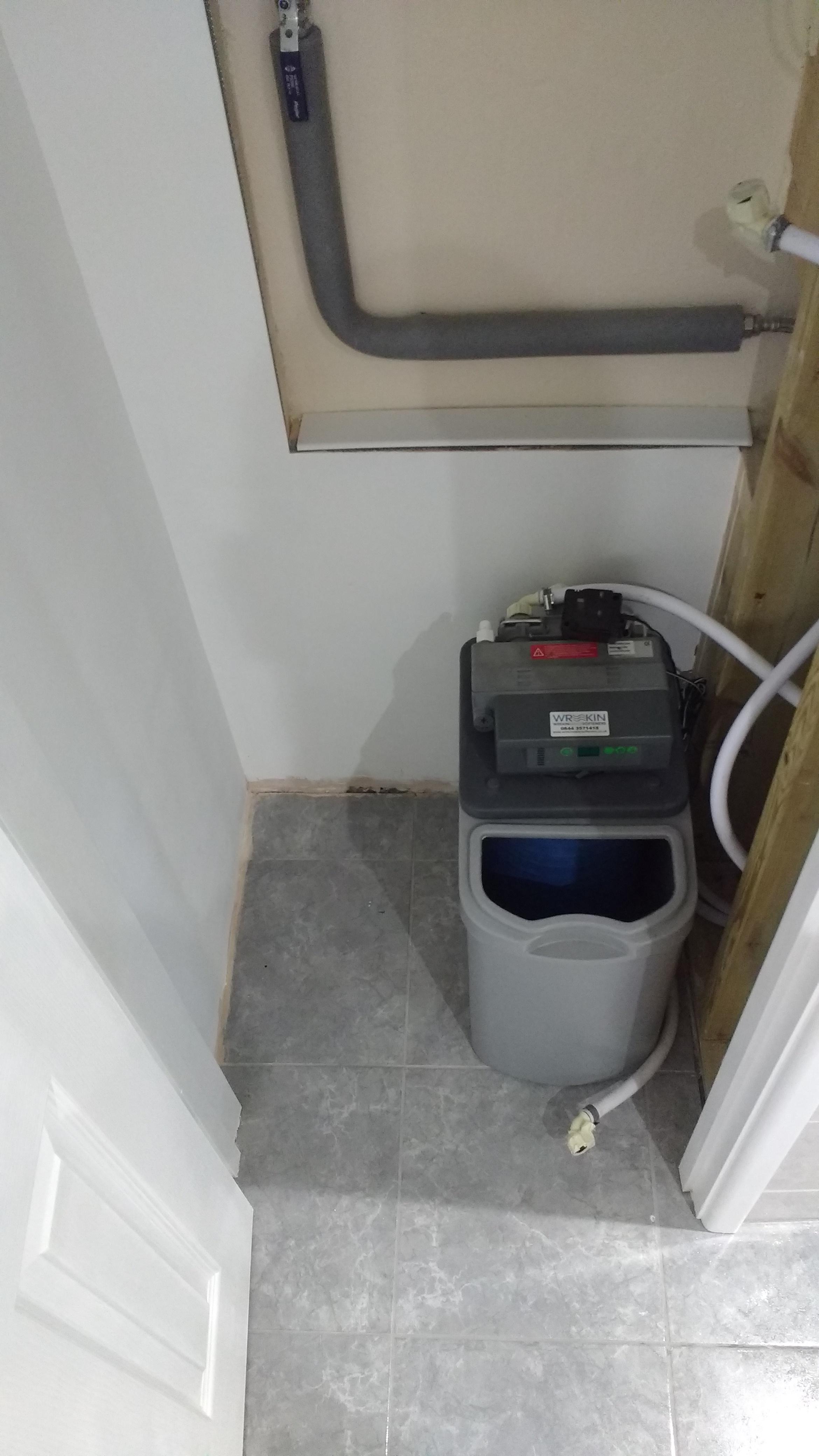

Gone West Posted July 28, 2019 Share Posted July 28, 2019 8 minutes ago, Onoff said: I can either rip the back wall out and redo or run new 22mms up inside the stud wall. It's going to be less work to take two new 22mm pipes up the stud wall if connecting at the top is straightforward. Link to comment Share on other sites More sharing options...
Onoff Posted July 28, 2019 Share Posted July 28, 2019 (edited) 9 minutes ago, PeterStarck said: It's been sitting for over a year, have you tested it to check that it still works? Well it powers up... Guess take it into the garden and get the hose connected then run through the commission & start up and see what happens? 6 minutes ago, PeterStarck said: It's going to be less work to take two new 22mm pipes up the stud wall if connecting at the top is straightforward. Wondering if I could reuse the 15mm in the wall (goes up into the loft) as the drain? Then feed the WC off the new 22mm pipe? Edited July 28, 2019 by Onoff Link to comment Share on other sites More sharing options...
Gone West Posted July 28, 2019 Share Posted July 28, 2019 2 minutes ago, Onoff said: Wondering if I could reuse the 15mm in the wall (goes up into the loft) as the drain? IIRC the waste pipe is quite a small diameter so using 15mm might cause problems with pressure. Could you feed the waste pipe through the 15mm pipe? Link to comment Share on other sites More sharing options...
Onoff Posted July 28, 2019 Share Posted July 28, 2019 39 minutes ago, PeterStarck said: IIRC the waste pipe is quite a small diameter so using 15mm might cause problems with pressure. Could you feed the waste pipe through the 15mm pipe? I'm thinking 15mm might not actually be big enough! Just roughly measured the waste run and it's about 6m up out of the cupboard, across the loft to the eaves. Thereafter, where it'll go I don't know. Thinking a larger bore drain pipe down to a drain. As it's draining hard elements could you get a "stalactite" issue at the exit pipe? Link to comment Share on other sites More sharing options...

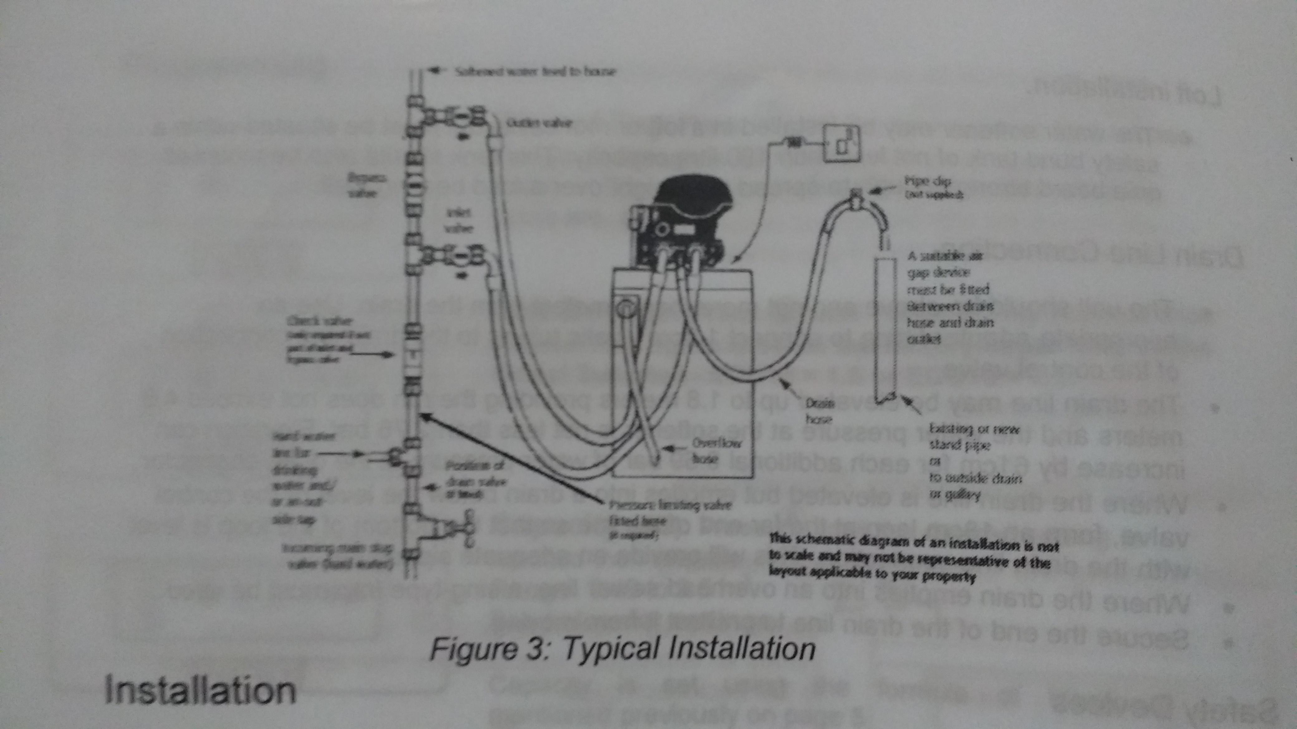

Onoff Posted July 28, 2019 Share Posted July 28, 2019 The print quality on this diagram 3 in the Wrekin manual is dire. I can't read what it says ref the check valve. As best as I can decipher it says: "Check valve <something> required if <something> part of <something> and bypass valve". I suppose I could email Wrekin. Link to comment Share on other sites More sharing options...
Gone West Posted July 29, 2019 Share Posted July 29, 2019 9 hours ago, Onoff said: I suppose I could email Wrekin. Before I bought it I telephoned them and there is an old chap there (probably younger than me), who was very helpful. Could be worth a call. Link to comment Share on other sites More sharing options...
