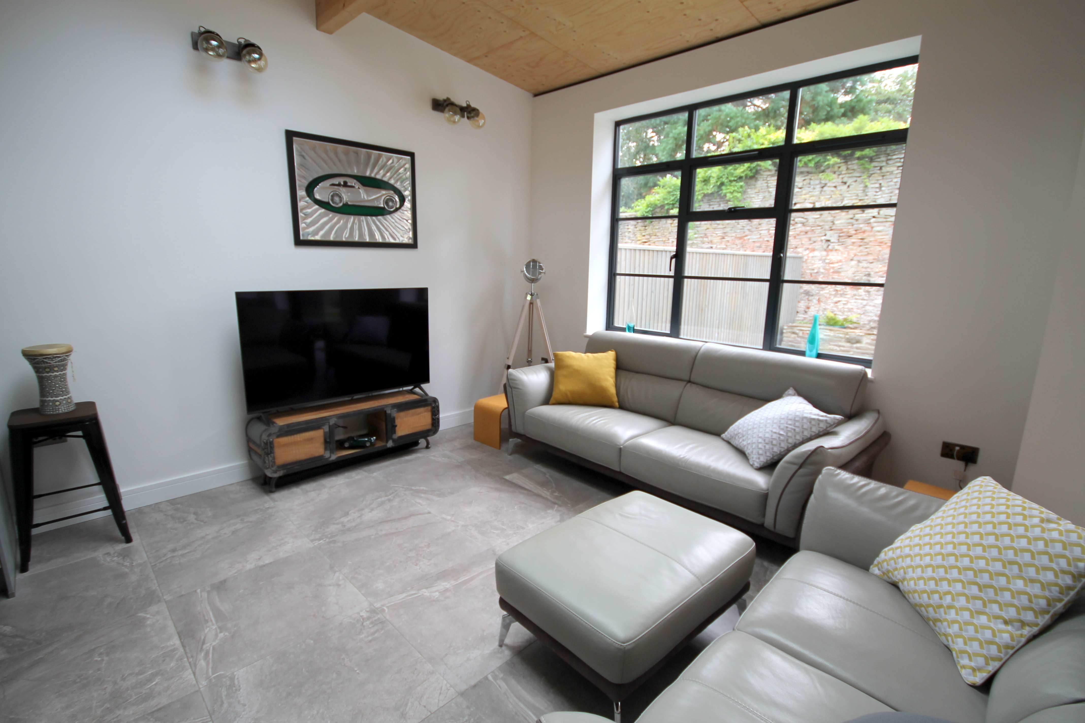

DrewG Posted March 6, 2023 Share Posted March 6, 2023 I'm going to use SIPS for my roof and have decided on Nudura XR35 for the walls (going to do this myself even though no previous experience of icf). Hopin to find a SIPS manufacturer who will do birch ply for the inner face of the SIPS to have as my finished ceilings upstairs (have done this before with UNILIN (no longer supply the UK). Link to comment Share on other sites More sharing options...
Conor Posted March 6, 2023 Share Posted March 6, 2023 1 hour ago, DrewG said: I'm going to use SIPS for my roof and have decided on Nudura XR35 for the walls (going to do this myself even though no previous experience of icf). Hopin to find a SIPS manufacturer who will do birch ply for the inner face of the SIPS to have as my finished ceilings upstairs (have done this before with UNILIN (no longer supply the UK). How are you going to run your services? E.g. MVHR ducts and electrics? We went for a panel roof (thermohouse) and battened down 50mm to make the void. You need even more for spot lights. Link to comment Share on other sites More sharing options...
eandg Posted March 6, 2023 Share Posted March 6, 2023 You might be doing well to find m/any that'll change their processes just for a one off roof ob with birch ply and would expect those that do to charge a premium for the hassle. Would presume you'd need a new assesment of build method etc too as their certification for warranties based on OSB. Likely easier just to get standard SIPS, batten out and sheet as you like. Link to comment Share on other sites More sharing options...
DrewG Posted March 6, 2023 Share Posted March 6, 2023 2 hours ago, Conor said: How are you going to run your services? E.g. MVHR ducts and electrics? We went for a panel roof (thermohouse) and battened down 50mm to make the void. You need even more for spot lights. The plan is not to have any services in the upstairs ceilings i.e. wall lights and there's no MVHR...just good old fashioned trickle vents on the windows (planning on Alitherm 300 with I think Planitherm glass due to the new Part L Regs). Link to comment Share on other sites More sharing options...
DrewG Posted March 6, 2023 Share Posted March 6, 2023 23 minutes ago, eandg said: You might be doing well to find m/any that'll change their processes just for a one off roof ob with birch ply and would expect those that do to charge a premium for the hassle. Would presume you'd need a new assesment of build method etc too as their certification for warranties based on OSB. Likely easier just to get standard SIPS, batten out and sheet as you like. You could be right and I may need to decid how I feel about OSB celing...keen on the industrial look so considering having exposed Universal Beams downstairs and use the bars on the Alitherm 300 windows for the Crital Style. Have attached a photo from my last house built in 2019 (Blockwork walls with SIPS roof). Link to comment Share on other sites More sharing options...
