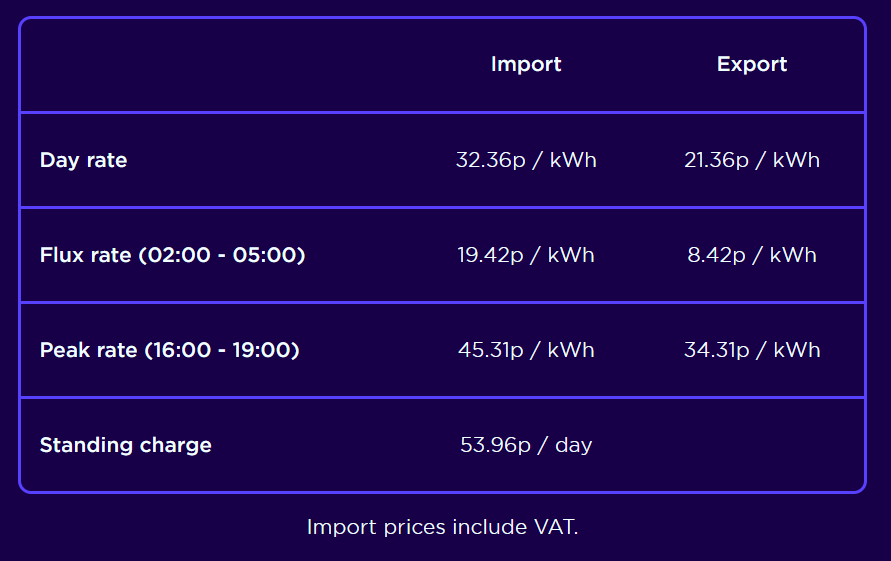

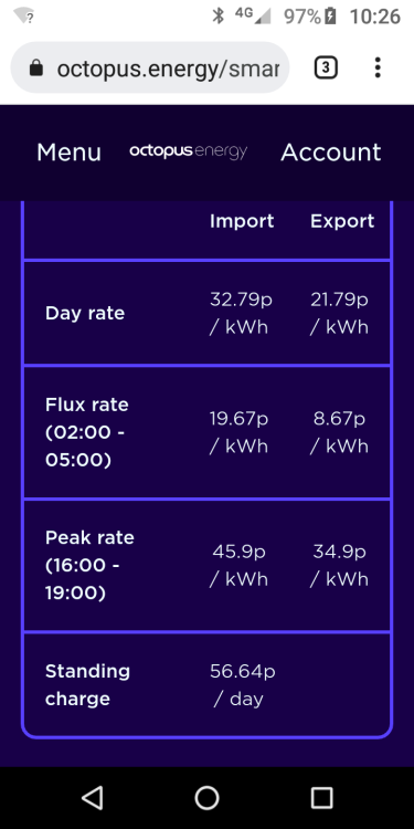

1 hour ago, Dave Jones said:
do read this correctly, you are paid 34.9p kw/h if you export during peak rate ?
Why not arbitrage it with a battery, charge at cheap export at peak ?
greenenergy uk off peak is 9.52p kw/h which is what i ise to charge up the powerwall if it needs it.
Yes, but you have to be on Flux import too, so the cheapest you can buy it in is 19.67p. You can still profit of course, just a smaller gain.

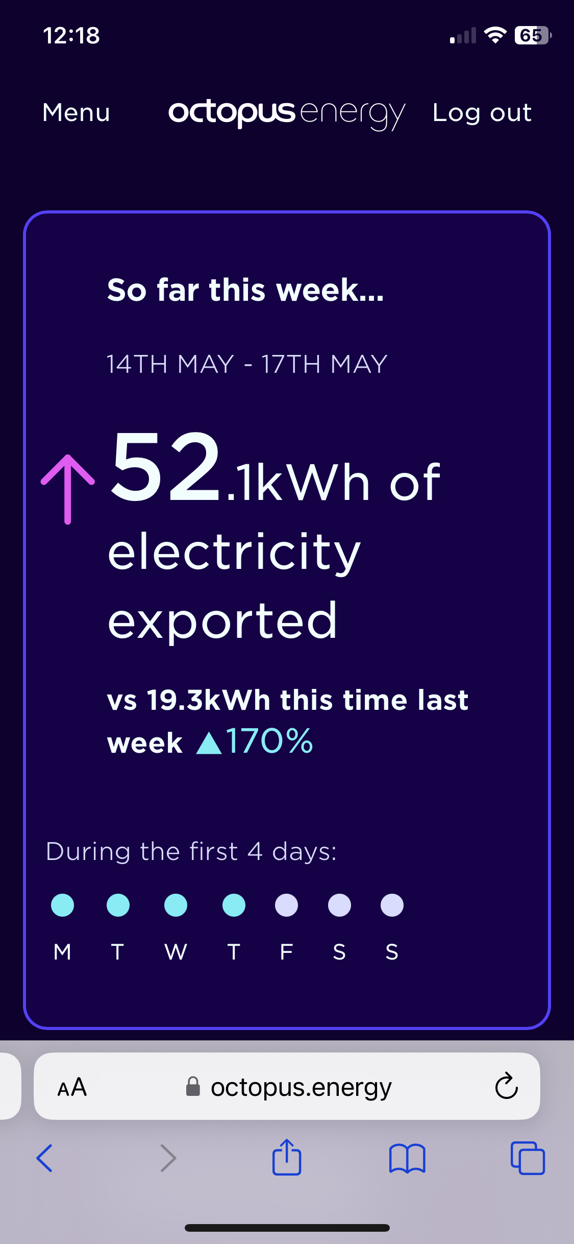

Enjoying flux
35p ( ish ) for 52kwh = £ 18.20
When you factor in the ‘earnings ‘ , the fact it’s powering your house , charging an EV ( only 4000 miles per yr ) . ROI ( as some of you are obsessed with that ) gets considerably better .
