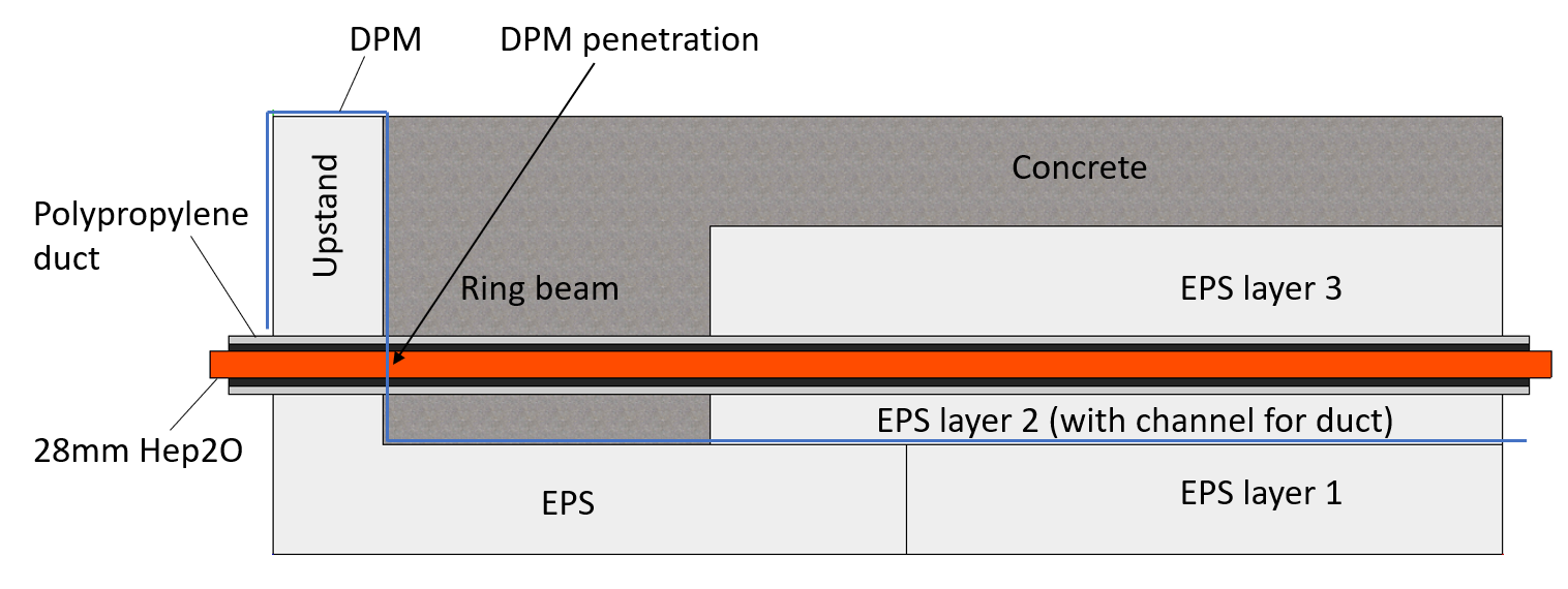

jack Posted February 15, 2023 Posted February 15, 2023 On 12/02/2023 at 19:58, JackofAll said: Hi, for those who have fitted an ashp on an insulated raft what way did you route the pipes, down and under eps coming up inside or through the wall? We had to route our ASHP pipework from one side of an attached double garage (on a raft) to the other and then a couple of metres through the house (also on a raft) into the plant room. The insulation under the slab is 3 x 100 mm EPS, so I got the guys doing it to leave a pair of channels in the middle layer. I laid some cheap drainage pipe (50 mm?) in the channels and used some expanding foam to hold them in place. They then did the last layer of EPS and proceeded as normal. I used a block of offcut EPS where the duct came into the plant room to keep the concrete away from the duct when it was poured. Once the concrete cured, I broke out the EPS, leaving me with a duct entering an open chamber in the slab at the edge of the plant room. When it came time to install the heat pump, I threaded 32 28 mm Hep2O (with oxygen barrier) piping through the duct. A 90 degree elbow in the chmaber and we had our flow and return in the plant room. At the ASHP side, I used elbows to come up the side of the garage wall. This is one detail I don't think I gave enough thought to at the time. I should probably have converted to copper right as the pipe came out of the EPS, and done everything from there in copper and then stainless braided flex, but we went with plastic. I was concerned about rodents etc, but it's pretty well wrapped in insulation and nothing's ever shown any interest in it. 1

JackofAll Posted February 15, 2023 Author Posted February 15, 2023 4 hours ago, jack said: We had to route our ASHP pipework from one side of an attached double garage (on a raft) to the other and then a couple of metres through the house (also on a raft) into the plant room. The insulation under the slab is 3 x 100 mm EPS, so I got the guys doing it to leave a pair of channels in the middle layer. I laid some cheap drainage pipe (50 mm?) in the channels and used some expanding foam to hold them in place. They then did the last layer of EPS and proceeded as normal. I used a block of offcut EPS where the duct came into the plant room to keep the concrete away from the duct when it was poured. Once the concrete cured, I broke out the EPS, leaving me with a duct entering an open chamber in the slab at the edge of the plant room. When it came time to install the heat pump, I threaded 32 mm Hep2O (with oxygen barrier) piping through the duct. A 90 degree elbow in the chmaber and we had our flow and return in the plant room. At the ASHP side, I used elbows to come up the side of the garage wall. This is one detail I don't think I gave enough thought to at the time. I should probably have converted to copper right as the pipe came out of the EPS, and done everything from there in copper and then stainless braided flex, but we went with plastic. I was concerned about rodents etc, but it's pretty well wrapped in insulation and nothing's ever shown any interest in it. @jack so your flow and return comes out the side of the upstand?, that seems a good idea rather than digging down like IanR did.
jack Posted February 15, 2023 Posted February 15, 2023 3 minutes ago, JackofAll said: @jack so your flow and return comes out the side of the upstand?, that seems a good idea rather than digging down like IanR did. I knew I'd done a sketch, but apparently I did one in quite a lot of detail! You do need to think about how you're going to neatly finish this area, as well as ensuring the EPS is protected from rodent attack. 1
