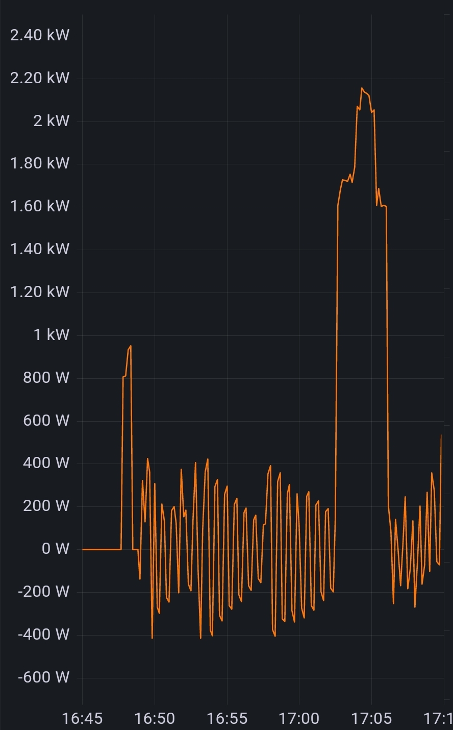

Hi all - I've had my system since 25 October, and with all the sun this week I've been looking at the figures. I get that you always get small imports from the grid, even if it in theory doesn't need to happen (as the battery + solar have enough power), but today the figures look odd.
The data as per the snip suggest that I've imported 1kw today, but there has been lots of solar and the battery is almost full. This looks like it was mostly between 2pm and 3pm when I was cooking, but shouldn't the battery have been used then?
Can I also check my understanding of the figures that the inverter produces: I'm assuming that the generation will be correct (as everything flows through the inverter), the battery figures are probably accurate, but all others are only estimates? It beats me how the inverter knows if I'm using a hair dryer in a bedroom as it's in a garden room, but it seems to have some idea. The inverter figures don't quite add up in that they say: solar 407, import 669 and consumption 1003. Even allowing for efficiency this makes the import look too high for that consumption but the actual import (as per the meter) is about 579, so way lower than what the inverter says. Saying that, I think that there was a draw today but maybe I just need to keep checking the meter as it's the only way I can know what it being drawn (it's not a smart meter).

It looks like there's an issue with your settings - there's three x 2+kW consumption spikes, but no battery assistance in the first two, only the third one shows 100% battery support. Post a screenshot of your charge/discharge settings so we can see what's going on.

Your settings are in the default "self use" state, which seems to be working ok apart from one consumption spike not supplied by the battery just after 14:00 (which could be a blip). For what it's worth, my On Grid Cutoff SOC is set to 5% and Off Grid 3%, which is what the installer set based on advice from the supplier.

Are you cooking with an induction hob, or just a simple resistive load like an oven?
21 minutes ago, S2D2 said:
Yes, this CT clamp detects the import/export power to a given accuracy. The arrow is to ensure it is installed the correct way as reversing the clamp will reverse the polarity of the reading.
Funnily enough, the spike at 2pm was when I was cooking and part of that was using an electric hob that we just never use. We use the gas hobsusually but I thought I'd use an electric hob as I knew I'd have excess today. It's probably over a year since it's even been switched on. I think it's an induction hob in that it gets hot very quickly and seems to click off if there is nothing on it. I just did a test now and put it on for 5 mins, and the spike seems to be covered by the battery. Could the type of appliance make any difference?
The induction hob switching can confuse the inverter, here's my grid usage when pulling an average of 900W to the hob but oscillating around this point as the inverter tries to keep up:
This would probably explain your messy spike just before two, but it does not explain why the inverter didn't pull from the battery at all for the spike just after two. If your installer is slow to respond you can try the inverter/battery manufacturer directly.
