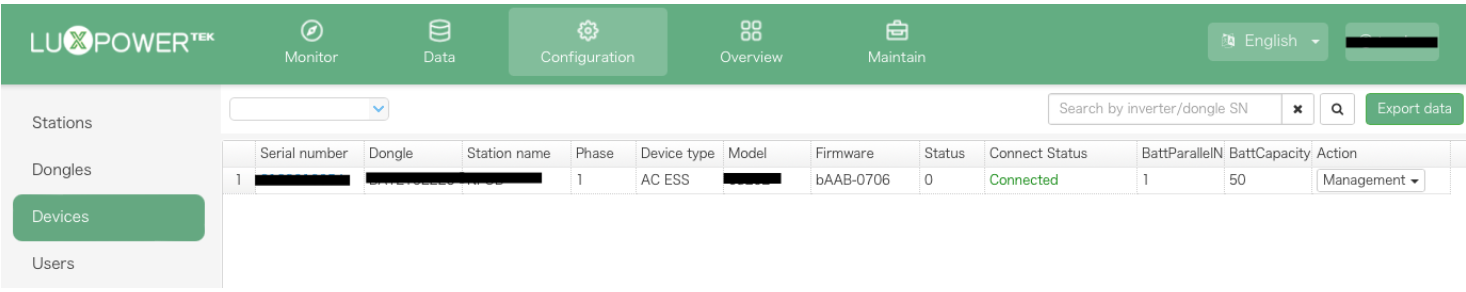

you can see your current firmware version from the web browser:
Ah thanks, I missed that. Do you know if there is a way to find out if this is the latest version? I can't see anything online.
No clue sorry!
lol fair enough. It's still useful though as I've noted it and if it ever changes then at least I'll know that the installer updated it.
