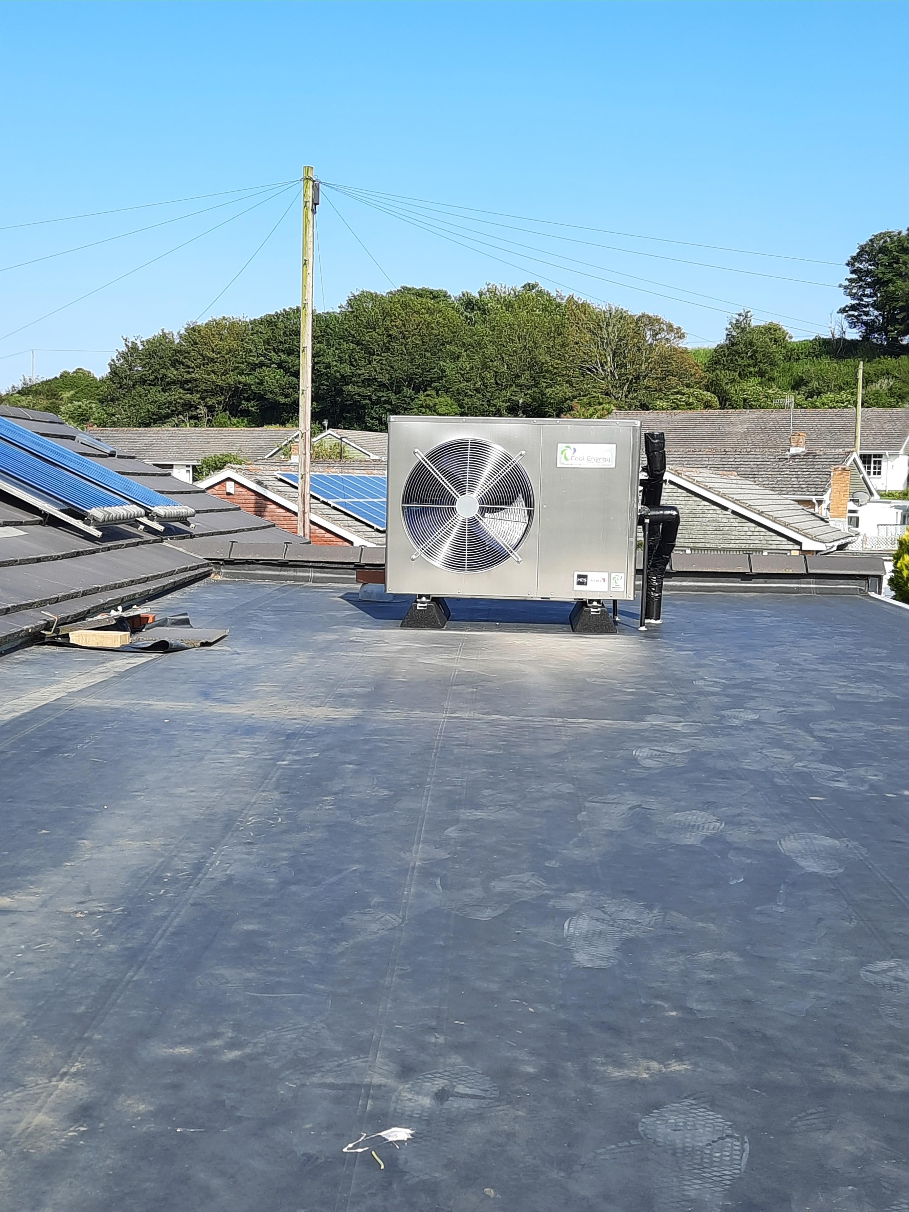

Marvin Posted February 2, 2023 Posted February 2, 2023 On 02/02/2023 at 15:45, HughF said: Paging @Marvin who has a cool energy 9kW unit on his flat roof. Expand Only about 88kg though.

JamesPa Posted February 2, 2023 Author Posted February 2, 2023 On 02/02/2023 at 21:39, Marvin said: Only about 88kg though. Expand Thanks. Any problems with vibration or noise transmission to the inside? What's below?
Marvin Posted February 2, 2023 Posted February 2, 2023 On 02/02/2023 at 21:53, JamesPa said: Thanks. Any problems with vibration or noise transmission to the inside? What's below? Expand Hi @JamesPa Below is the utility room housing the buffer and hot water tank etc, and the end of the kitchen. Its been up there about 18 months. No vibration problems at all. Went for widest rubbery feet to absorb any vibration (but I must say even when running there seems to be none) and to distribute the load of a wide area. Wife considers the noise level to be similar to the old gas boiler. Marvin
