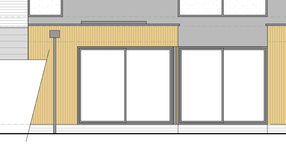

Christ, don't put doubt in my mind. Our elevations are quite forgiving so we think it looks pretty good;
The section with the downpipe is existing. Everything to the right will be a new extension.

Why should you be the only one here not burdened by doubt?🤣 ...Just forget I ever mentioned it!
That picture doesn't give a particularly clear overview of the design overall but I'd say there's promise. What's it like in plan?

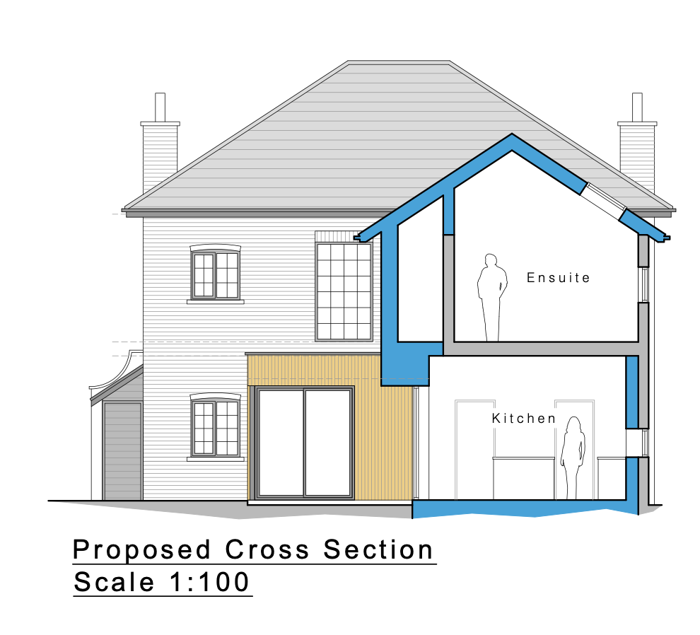

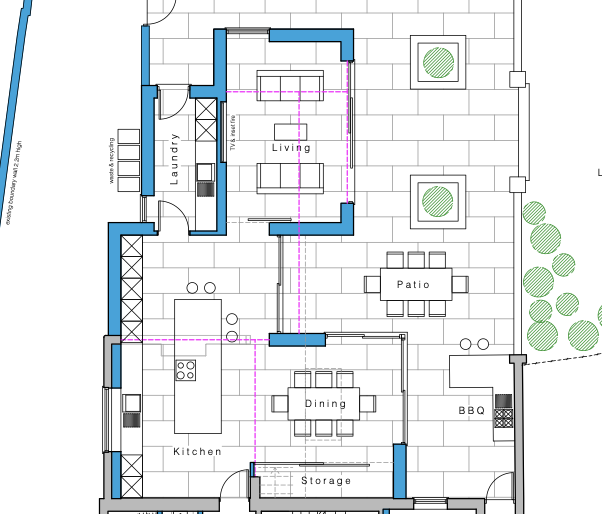

It's the dining area shown here. Also including a cross section as this area is masked on the elevation.

OK, in context, that actually looks pretty good to me. This is all very subjective of course. But I think you know what I was referring to with flat warm roofs. Your design is strongly influenced by set of cubic modules so the higher elevations lend to this goal. All this talk of aesthetics isn't helping your original question about construction method though!
