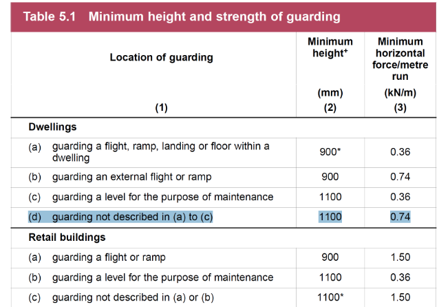

Conor Posted February 1, 2023 Posted February 1, 2023 (edited) Hi, We've a first floor (3m drop) balcony and are planning on frameless glass. The prices from local companies have been utterly absurd, so we've found a company then directly imports glazing products from Eastern Europe. Supply only so I'd be fitting. What would the BCO usually ask for? I know the NI regs state that he structure needs to withstand a force of 0.74kN at 1100mm. Will they ask for documentation to support this? Supplier says product (20.76mm toughened laminated glass) complies with equivalent European standards. Is this likely to be enough? Can't see any reference to a BS standard in the BC docs. (cant ask BCO as we've not put the application in yet) Edited February 1, 2023 by Conor

George Posted February 2, 2023 Posted February 2, 2023 So a normal framed glass balustrade has the supporting structure (i.e. uprights and handrail) which would need to comply with Part A - the 0.74kN/m and (technically) PD6688-1-1 requirement of 0.5kN/m^2 over the whole area. If the supplier of that uprights and handrailing structure doesn't provide that calculation and BC want it, then a SE will need to demonstrate it complies. The glass infill itself needs to comply with Part K, which would mean glass meeting the BS EN 12600 standard... Class 3... I think. This will mean it has been tested with the pendulum test to resist a given impact force and if it does break, breaks 'safely'. The system of securing the glass (beads or clamps) would also need to have been designed. Now... with a frameless system I believe you would need to get the supplier to demonstrate BS EN 12600 compliance and give calculations that as a cantilever it can withstand the 0.74kN/m & 0.5kN/m^2 requirement. It would be relatively trivial for a SE to calculate the load capacity of the glass pane as a cantilever at a given thickness. The challenge is what do the support look like and can that be proven by calculation or whether load testing would be needed. 1
