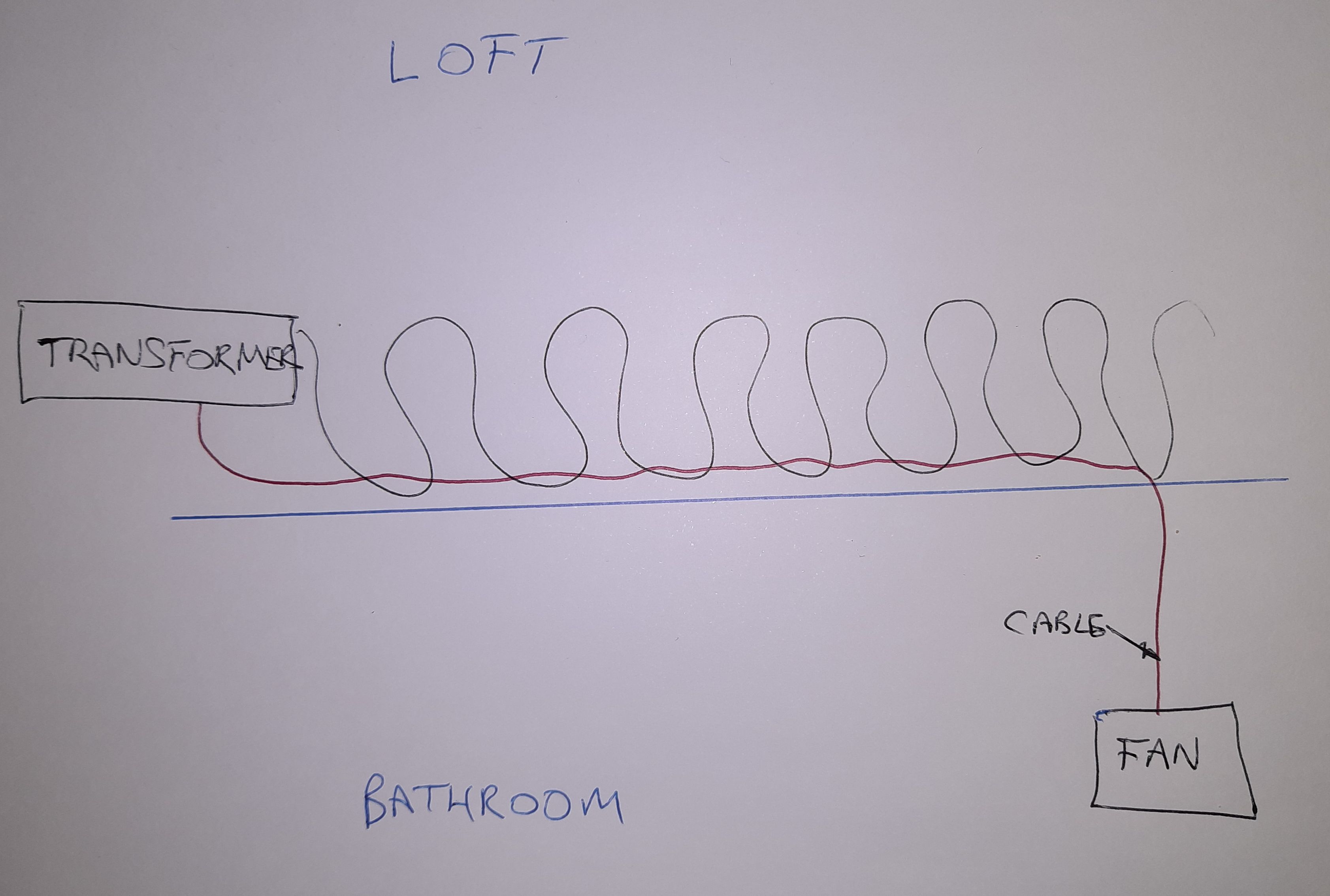

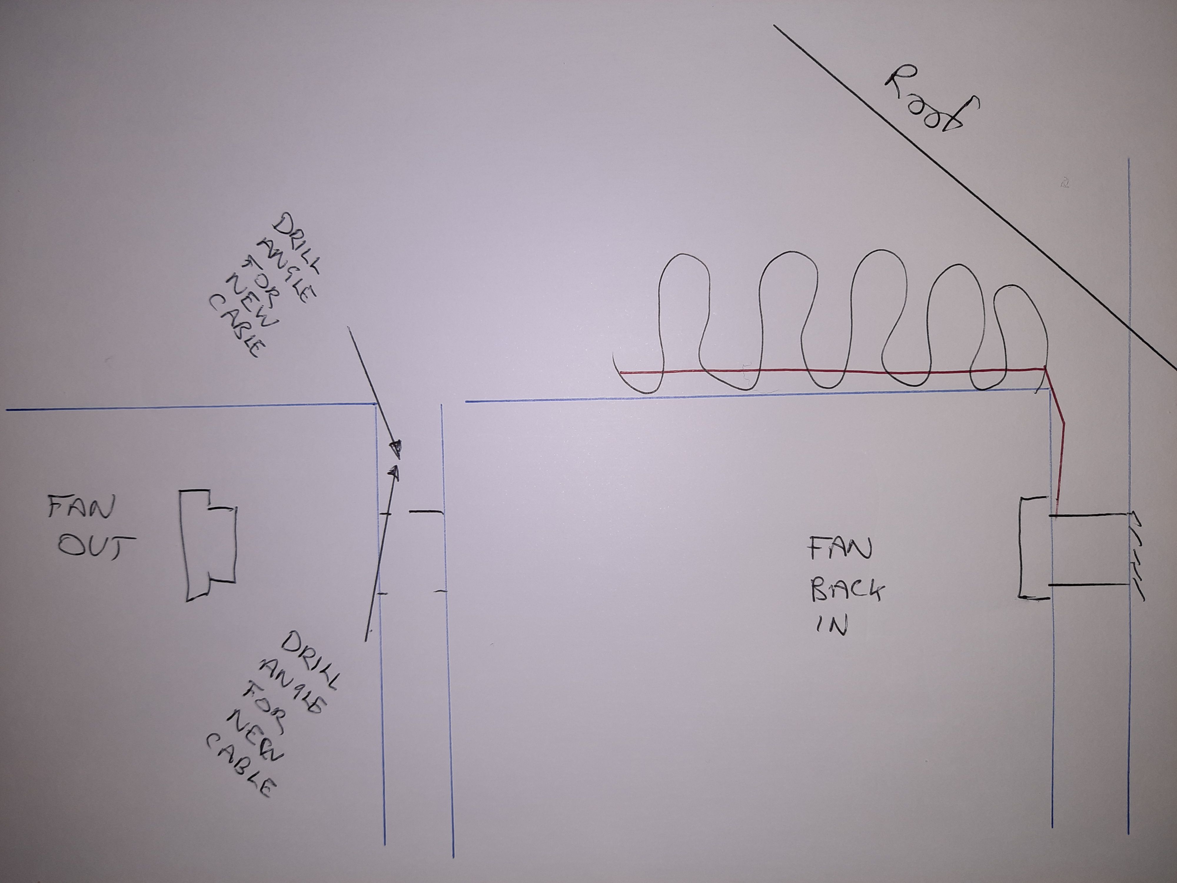

WWilts Posted January 28, 2023 Author Share Posted January 28, 2023 Will this solution work? If so, can propose to builder as a mitigating measure acceptable to us. Link to comment Share on other sites More sharing options...
Marvin Posted January 28, 2023 Share Posted January 28, 2023 If the existing wire is under fluffy in the loft, it is accessible. I did this last week for a client. I assume the fan is in the wall, so cable down wall. The only problem, based on your information, is how tricky it is to install the new cable up the wall. The way to install a new cable behind a tiles wall.... If you live on the isle of wight, I will come over and do it for you free. 1 Link to comment Share on other sites More sharing options...
