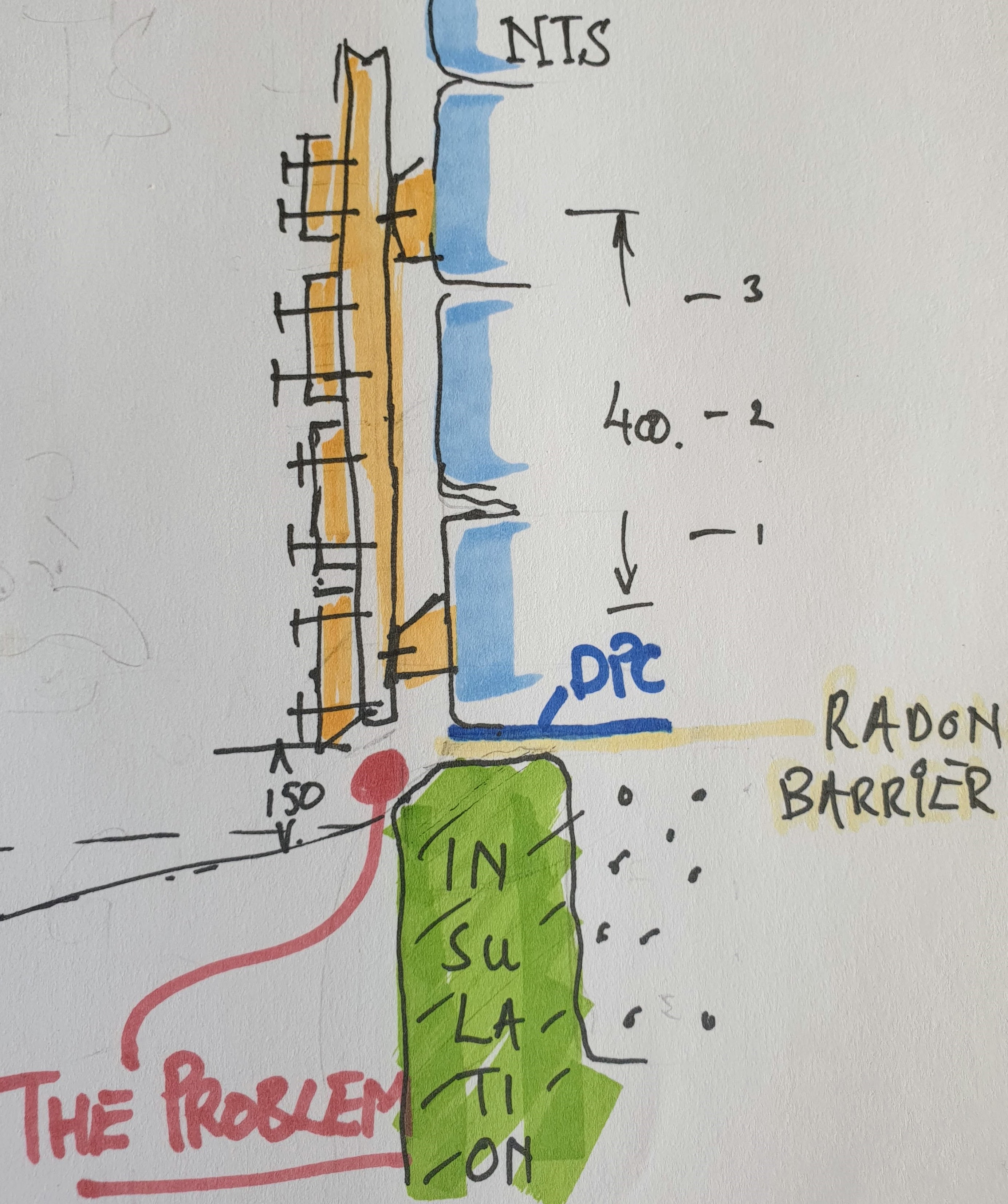

ToughButterCup Posted January 26, 2023 Share Posted January 26, 2023 Is this the problem you need to solve..... ? How to seal - waterproof - the gap between the bottom of the cladding and (probably) the path round the house We used Ubiflex. Its good stuff. Bit expensive, but cheaper than lead. 1 Link to comment Share on other sites More sharing options...

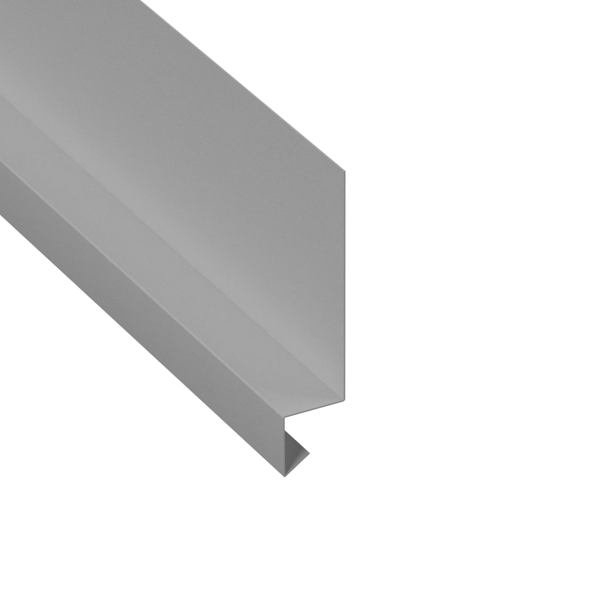

markharro Posted July 24, 2023 Share Posted July 24, 2023 I have a similar question. On parts of our wall we will have open vertical cladding above a lower section of render. The top half of the wall has black waterproof UV resistant membrane fitted so that rain passing through the gaps in the cladding will drain down without soaking the timber frame. The issue is how to stop this water then draining down behind the cement boards that will take the render? I guess having permanent moisture behind this boards will be sub-optimal? Do we need some sort of metal cill to deflect the water out and over the face of the render? thanks 1 Link to comment Share on other sites More sharing options...
ToughButterCup Posted July 25, 2023 Share Posted July 25, 2023 14 hours ago, markharro said: ... On parts of our wall we will have open vertical cladding above a lower section of render ...The issue is how to stop this water then draining down behind the cement boards that will take the render? I guess having permanent moisture behind this boards will be sub-optimal? Do we need some sort of metal cill to deflect the water out and over the face of the render? thanks Design the battening such that the lowest batten supports some sort of valence (such as the one in the image above). We were supplied with a special glue (but I suspect many other generic mastics will do ) that sticks the membrane to the valence. I'll dig around and see if I can find a spare tube. It won't hurt to tape the membrane to the valence as well. I'll look in our stillage to see if we've some left over. Link to comment Share on other sites More sharing options...

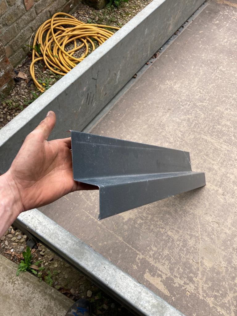

Temp Posted July 25, 2023 Share Posted July 25, 2023 21 hours ago, markharro said: I have a similar question. On parts of our wall we will have open vertical cladding above a lower section of render. The top half of the wall has black waterproof UV resistant membrane fitted so that rain passing through the gaps in the cladding will drain down without soaking the timber frame. The issue is how to stop this water then draining down behind the cement boards that will take the render? I guess having permanent moisture behind this boards will be sub-optimal? Do we need some sort of metal cill to deflect the water out and over the face of the render? thanks Can you run the render board up behind the cladding a bit so the membrane can overlap it without being seen? I used a strip of lead above a window on my outbuilding. The top edge of the strip goes behind the membrane, the bottom edge goes in front of the cement board (window head board in my case). There must be someone making aluminium sections that would do the same job. Link to comment Share on other sites More sharing options...
Temp Posted July 25, 2023 Share Posted July 25, 2023 This is the sort of thing I was thinking of. Its galvanised steel with a plastic coating.. https://www.southernsheeting.co.uk/categories.html?filter_set[]=285,310&name=drip+flashing&type=simple&perpage=76 Link to comment Share on other sites More sharing options...
