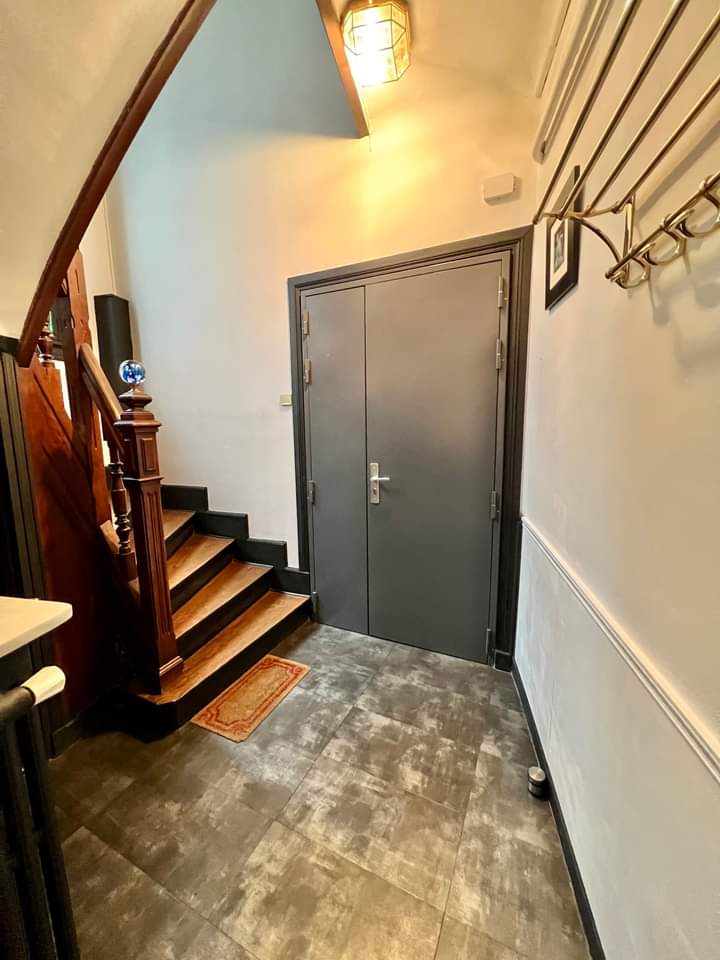

Garald Posted January 16, 2023 Posted January 16, 2023 Another chapter in the insulation saga! My ground-floor doors are metal security doors. Now, metal is of course a heat conductor, and I don't know what is inside the doors. So - what to do about this? My architect suggests adding fabric on the inside: https://www.futura-sciences.com/maison/comparatifs/meilleur-rideau-isolant-thermique-comparatif/ Does that really make a difference? Is it best?
Garald Posted January 17, 2023 Author Posted January 17, 2023 Follow-up question: The idea does seem to make sense - after all, why not treat a metal door as a bad window you don't mind not seeing through? But - does it make sense to have the back of the drape made of reflective material? Sure, it does, but: of the same kind of reflective material as an ordinary heat-insulating curtain? The heat radiated by the (dark grey) door won't be mainly in the visible-light spectrum. Should I focus mainly on having thick drapes?

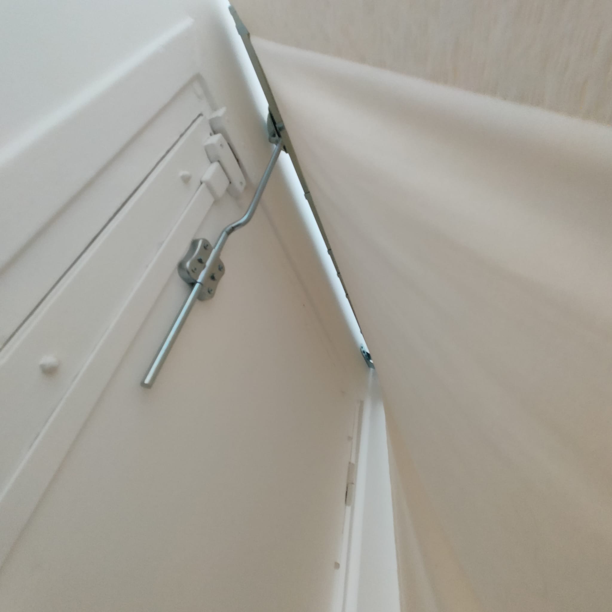

saveasteading Posted January 17, 2023 Posted January 17, 2023 First check that the door is not insulated. Metal doors are often filled with polystyrene. There is still a lot of conduction through the edges though. Fabric wont make much difference, but a heavy curtain could slow the flow of air. You could face the inner side with thin insulation. What is the context? Is that your door? It looks like a deep-freeze door.

saveasteading Posted January 18, 2023 Posted January 18, 2023 A photo of the door would help. If from a recognised uk suppler it is probably insulated. Reflective surfaces send some energy back where it came from. Indoors though, not a lot.
Garald Posted January 18, 2023 Author Posted January 18, 2023 (edited) I just got back, but here is a picture we took some time ago. The door is presumably from a recognised *French* supplier. Edited January 18, 2023 by Garald
saveasteading Posted January 18, 2023 Posted January 18, 2023 That looks like an industrial door (for a warehouse). Probably made of flat steel folded to shape, with a polystyrene core. So insulated, but with a lot of cold bridges at the circumference and some through the structure. Does it feel cold? Covering the inside would be feasible but ugly. I stick with the big curtain solution. It will isolate the room air from the door and reduce air cooling.
Garald Posted January 18, 2023 Author Posted January 18, 2023 4 hours ago, saveasteading said: Does it feel cold? Will check when I am back. I could ask the contractor. 4 hours ago, saveasteading said: Covering the inside would be feasible but ugly. Right, that's what the architect said. 4 hours ago, saveasteading said: I stick with the big curtain solution. It will isolate the room air from the door and reduce air cooling. So, should I go with one of the high-grade options, like https://www.moondreamwebstore.fr/rideau-thermique-82 (which are optimized for a windows or window-doors, anyhow)? Or would something like https://www.ebay.co.uk/itm/285026787569?hash=item425ceba0f1:g:qOsAAOSwh6tjZVF8 also be good?

Garald Posted January 18, 2023 Author Posted January 18, 2023 9 hours ago, saveasteading said: That looks like an industrial door (for a warehouse). Probably made of flat steel folded to shape, with a polystyrene core. So insulated, but with a lot of cold bridges at the circumference and some through the structure. Does it feel cold? The architect confirms: they feel cold. She also doubts they are industrial-grade, in spite of their industrial appearance.
Iceverge Posted January 18, 2023 Posted January 18, 2023 Could you glue some ply faced PIR on to the internal face and get your joiner to make trims to make it look good? One slight (maybe overthinking it) worry I would have is getting tangled in the curtain in a fire escape situation.
Garald Posted January 18, 2023 Author Posted January 18, 2023 26 minutes ago, Iceverge said: Could you glue some ply faced PIR on to the internal face and get your joiner to make trims to make it look good? You mean, on the inside of the door, or outside? The latter option may not be super for the pyroparanoid. 26 minutes ago, Iceverge said: One slight (maybe overthinking it) worry I would have is getting tangled in the curtain in a fire escape situation. Hm, that's right. Otoh the curtain would hang flat against the door, and there would be no cord to get tangled in.
