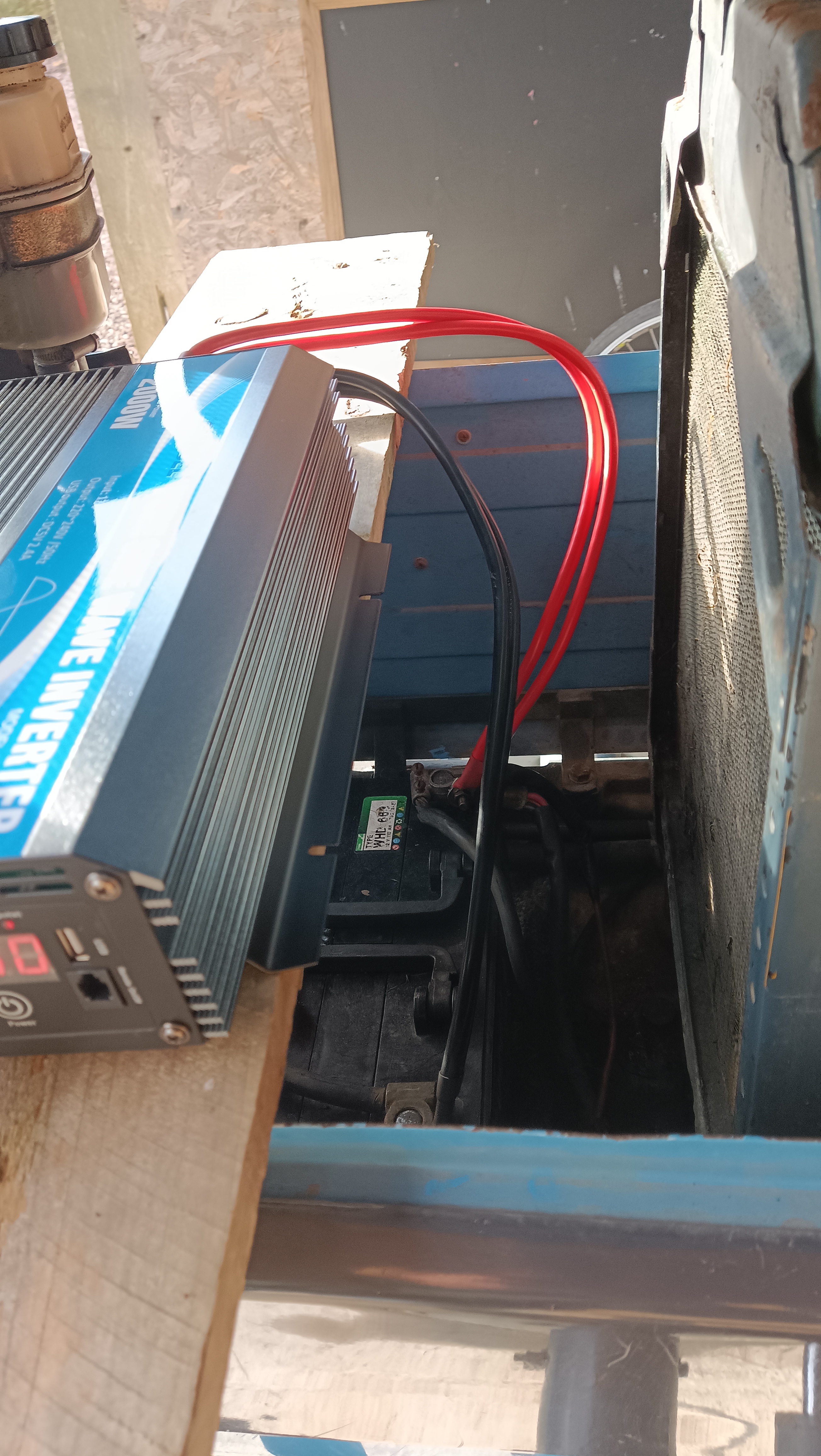

I'm waiting for a pure sine wave inverter to arrive from Amazon as a backup for the house via a changeover switch.
Wired to my car alternator of 150A it should be able to power the lights, TV, fridge, borehole pump without too much trouble.
I tried did try previously with a cheap modified sine wave inverter but it didn't play ball with the LED light bulbs, induction hob (ok that was pushing it) and the electric fence energiser.
It worked perfectly for any electronics's with a built in adapter/rectifier (TV laptop) and any dumb appliances like incandescent lightbulbs. It even had a good attempt at the 2kw kettle although when I tried this it must have really "squared" off the sine wave because all the LED bulbs went haywire.

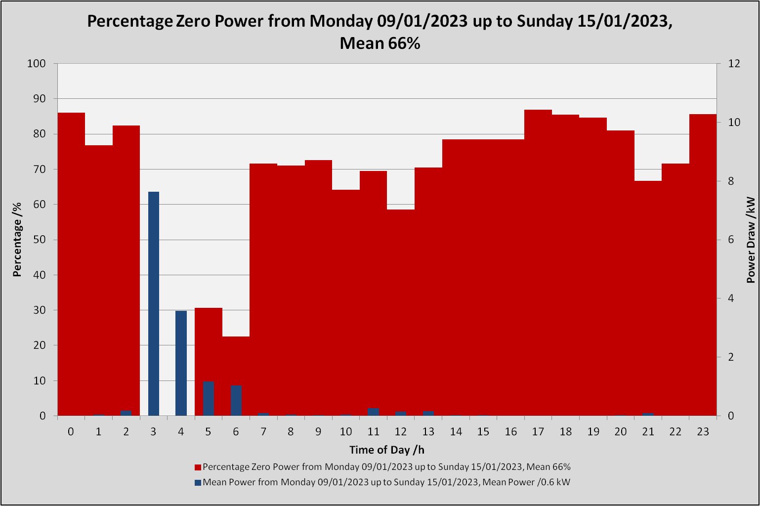

Please report back on how it goes.  I would quite like to run one ring on my induction hob and the grill on my oven at 15pkWh (plus conversation inefficiencies) rather than the over 56p/kWh (or whatever it is now) on the day rate.
Be a bit of fun to do as well.
Should be possible with my energy profile.  11, 12 and 12 are the lunch time hours.
Edited by SteamyTea
Reporting back.
I wired up the inverter today to the tractor. Nothing . Tried the car too but the same story.
It wouldn't power a 40w soldering iron via the 230v AC outlet. It did make one brief flash of a worklamp when I plugged it in on one try.  The 5A USB outlet was working fine. The input voltage was a constant 14.4V.
I think it's bust so it's heading back to Amazon. Annoying for €300+
With a billion 5* reviews I assumed it would at least operate for a while. Reading the 1* reviews it doesn't appear to be an isolated problem. I am often suspicious of the Amazon reviews system, now even moreso.
Some of these inverters have a minimum load, wired in one that would shut down unless it was greater than 200W.
Try a heavy load on it.
