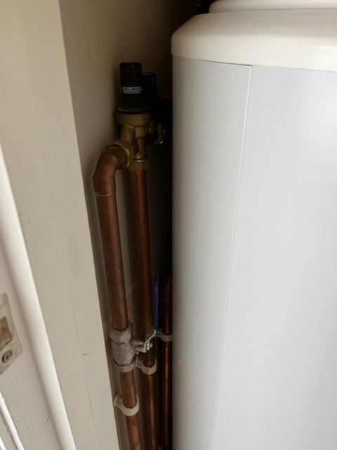

Alan Ambrose Posted January 14, 2023 Posted January 14, 2023 Hi, We live in a new barn conversion about 5 years old. It seems to be well built and by a good builder. About a year ago, we started occasionally getting a little 'water hammer' sound - a tapping about 1 once per second. This was relieved by turning on a tap for a few seconds. The sound might come back 10 minutes later, otherwise it would stay away for a day. OK I thought - the expansion vessel on the incoming main must have died. I'll replace it and the problem will go away. So, I replaced it with a like-for-like vessel - an 'Aquasystem 18 Litre Potable Expansion Vessel'. From memory, I think I checked the preset pressure etc. But the problem hasn't gone away... Any ideas? TIA, Alan

Alan Ambrose Posted January 16, 2023 Author Posted January 16, 2023 >>> Do you have a water tank in the loft or a header tank for the heating? No, this is a modern-ish set-up with UVC and expansion tank on the incoming main - at least, I think so - it's a bit difficult to see where everything goes as some of it is hidden at the back of the airing cupboard. I think I'll take it apart again and maybe install a surge arrestor and some pressure gauges and see how we go from there. The curious thing is why it happened after 3-4 years from new? I guessed 'fault on expansion tank' which seems to be wrong. The only other possibility I can think of is that mains pressure has gone up over that time - which seems possible but unlikely.
Alan Ambrose Posted March 2, 2023 Author Posted March 2, 2023 (edited) OK I finally found time to pursue this. I measured the pressures and did a bit more examination: The incoming pressure is 6.1 bar and, after the cold water shut-off ball valve, goes straight into a Reliance CWIC355090 Monobloc ( https://www.reliancevalves.com/sites/rv/files/2022-06/Reliance Valves 22mm Compact One Piece Inlet Control Group Data Sheet.pdf ) 3.5 bar PRV with 6 bar relief. This also has a 'balanced cold water take off'. The expansion tank air pressure was about 2.5 bar (with the hot water pressure released) and I topped that up to 3.5 bar. I see the hot water pressure itself is 3 bar normally. About 0.2L of hot water comes out when I shut off the incoming water pressure and open a hot tap. I sort of convinced myself the hammer was less when I topped up the expansion tank a bit. I see that some of the pipes could be better supported and I ordered this kit ( https://www.amazon.co.uk/dp/B0956LDKSQ ) which should arrive today. Then I had a bit of a brainwave - the hammer is largely coming from the cold tap but the expansion tank is on the hot circuit. Duh. So, its likely the HW set-up is fine. I should say that it's hard to see the exact pipe routing and connections as the pipes are mostly behind the HW tank. So, I may need a low volume expansion tank / arrestor on the cold side? The only problem is that it may be very difficult to fit with the pipes where they are. Edited March 2, 2023 by Alan Ambrose
