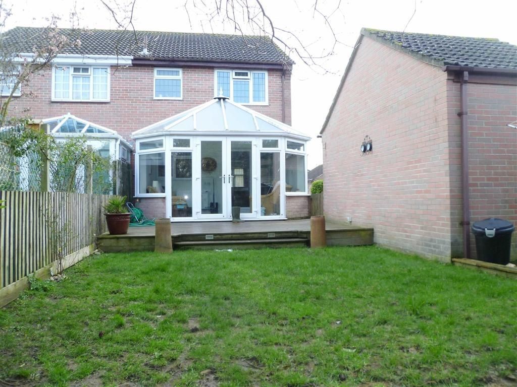

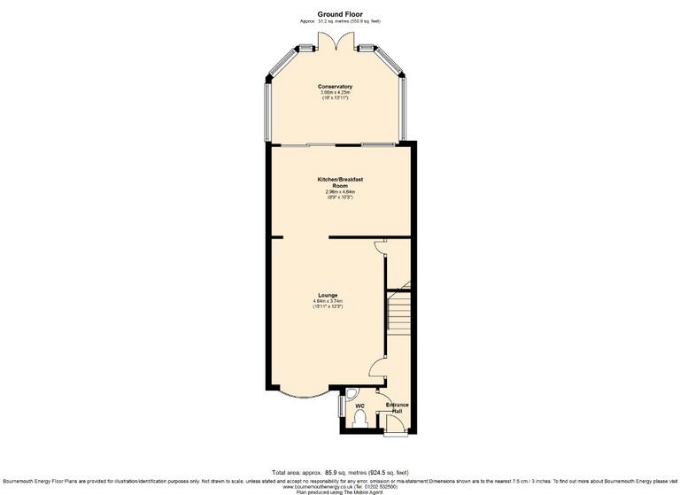

NickK Posted January 12, 2023 Share Posted January 12, 2023 Hi, Although self-build will always be a dream, we need to make the current place work for us as much as possible and spend as little as possible :-). Plan is to get rid of old leaky conservatory and put up rectangular 4.5 x 2.3 extension in its place. Huge supporting column between conservatory and kitchen will need to stay to make it affordable. With that in mind, what roof type and window would be best solution to bring in as much light as possible. The garden is west facing so my gut tells me pent roof with velux style windows so we can control solar gain in summer with either internal or external blinds. Floor plan and picture from when we moved in hopefully attached. Thanks Link to comment Share on other sites More sharing options...
Radian Posted January 12, 2023 Share Posted January 12, 2023 Not sure about pent roof. Do you mean with the highest side adjacent to the garage? Is it your garage? I think I'd go with a flat roof (warm buildup) and plain rectangular skylight. Any reason you're not using the full footprint of the old conservatory (3m)? Link to comment Share on other sites More sharing options...
NickK Posted January 12, 2023 Author Share Posted January 12, 2023 Hi. Highest point would be on the back of the house (see pic). Garage is ours yes. Not using the whole footprint if just for simplicity and therefore cost reasons. There is less than meter between conservatory and garage which I want to keep for access to the garden. Idea is to have a smile single glazed door and then largish window that would double us as bench seat for dining table. Link to comment Share on other sites More sharing options...

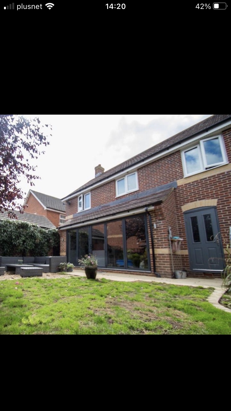

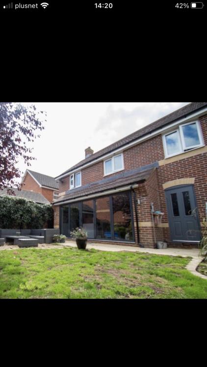

ProDave Posted January 12, 2023 Share Posted January 12, 2023 For maximum light I suggest a normal ridge roof with big windows, not unlike my sun room perhaps? Link to comment Share on other sites More sharing options...

NickK Posted January 12, 2023 Author Share Posted January 12, 2023 39 minutes ago, ProDave said: For maximum light I suggest a normal ridge roof with big windows, not unlike my sun room perhaps? We did consider this option but being semi detached we want to get all rain water going to towards the garage and down the drain. Link to comment Share on other sites More sharing options...
