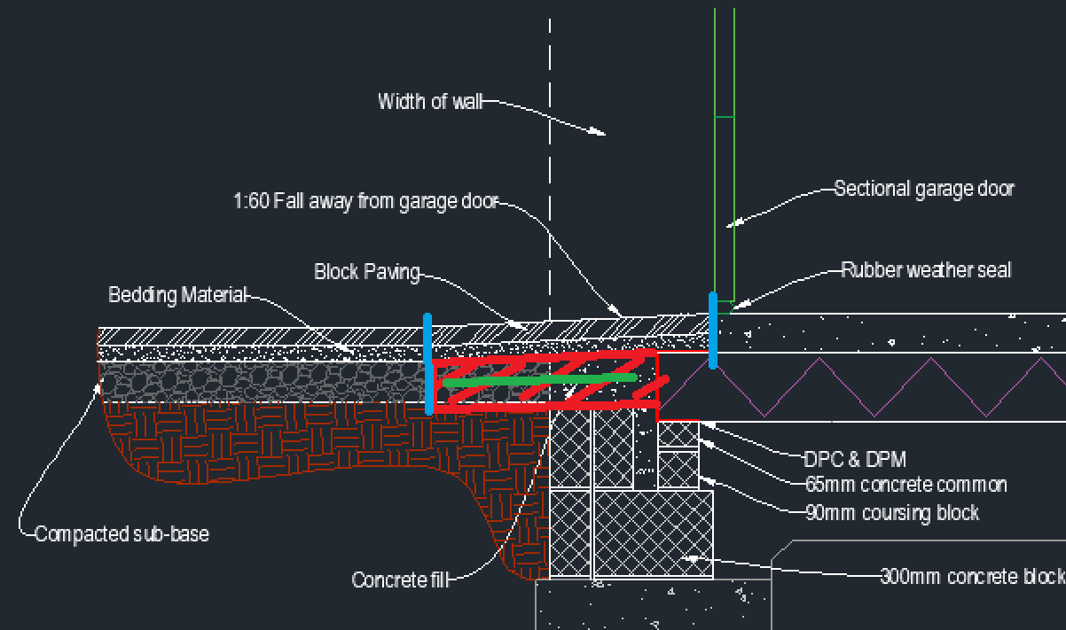

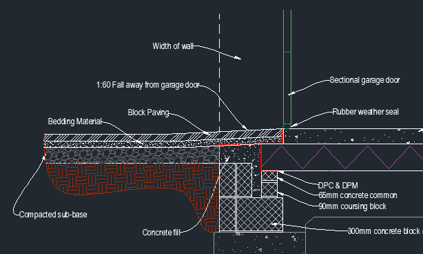

benben5555 Posted January 8, 2023 Posted January 8, 2023 (edited) Hi, Has anyone got a foundation detail through a garage door opening. The below is what I have come up with. We want block paving up to the garage door (which sits on the inside face of the garage wall) rather that seeing a 300mm wide strip of concrete. I've added an extra DPM (red line) to direct any water that falls in the doorway out to the sub base of the driveway. The purple hatch is the beam and block floor with a 100mm reinforced concrete topping. The blocks on the outside of the trench block are a continuation of the footing for the brick plinth either side of the garage door opening. I thought I might as well leave these in rather than miss them out and then try and fill with tonnes of concrete. Thanks Edited January 8, 2023 by benben5555
George Posted January 10, 2023 Posted January 10, 2023 (edited) Concrete run-on slab and a movement joint in the block paving. Basically what you'd normally do but set 100mm lower so you can block pave over the top of it. Red = concrete Green = steel mesh Blue = movement joints I agree with running the foundation and blockwork through, too. Edited January 10, 2023 by George
Canski Posted January 10, 2023 Posted January 10, 2023 Or a chamfered kerb on edge lining up with the front of the garage door ?
HHHAMSTA Posted June 17, 2023 Posted June 17, 2023 Just to continue this thread, does it not matter water can get behind the DPM at the door opening (as it's a garage) or does this need to be considered? Appreciate the door is on the internal side of the reveal and likely also covered by the soffit at the eaves.
Dave Jones Posted June 18, 2023 Posted June 18, 2023 (edited) what we are doing with ours. Concrete it to the outside of the pillar either side. When we ready to pave, cut a nice straight line (even with shuttering you wont get this straight to the mm) ready to take the paving. We also have a linear drain across the front. Can run a length of 900 dpc along the join if you really want to but cant see it doing much really, im not bothering with it as damp will never be an issue at that junction. I would up the fall as well from your 1 in 60 which will be 1mm of fall over that 550/600 width. Id make it 5mm over such a short distance. Another case of an architect drawing utter nonsense. Edited June 18, 2023 by Dave Jones
dpmiller Posted June 18, 2023 Posted June 18, 2023 3 hours ago, Dave Jones said: I would up the fall as well from your 1 in 60 which will be 1mm of fall over that 550/600 width eh?
saveasteading Posted June 18, 2023 Posted June 18, 2023 I always assume that the rubber won't work and the wind will blow water under. Therefore I continue the slope fior about 200mm past the door. Then the wind struggles and the water just runs back. I tried to patent this but was told it was too obvious.
