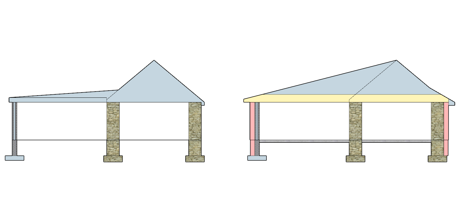

Here's a quick drawing I did of a section through your plans to demonstrate what I was thinking re a really good renovation.
On the left is before and on the right is after.
The lead flat roof is removed and it is pitched to the apex with a substantial overhang and a raised wall plate detail.
Similarly the existing pitched roof is given a bellcast and overhang.
You can see how the roof insulation ( loft roll is about £10/m2 at 400mm) joins up with the external wall insulation to mitigate any bridging at the wall/roof junction.
The EWI runs outside all the existing wall outside the troublesome steel and solid walls. EPS runs at about £35/m2 for 300mm. It is cheap VS the time and render cost so do as much as you can.
Take it right down to the foundation and your heat loss thought the uninsulated(??) floors will be minimal and you won't have to disturb the inside of you nice house at all.

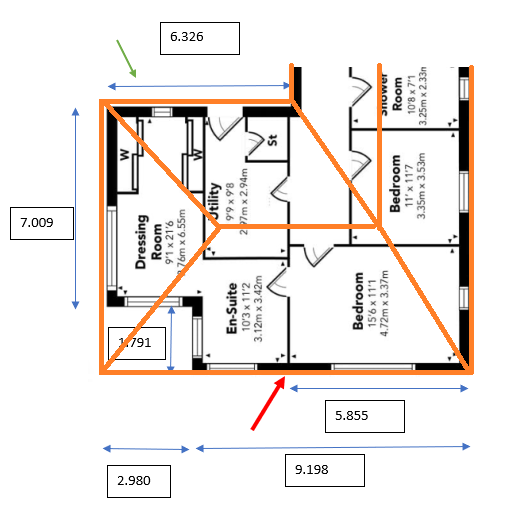

7 hours ago, Iceverge said:
Can you post accurate external dimensions of the house and I'll throw together a sketch if I get a chance
So these are the wall dimensions, there is a 250 overhang of the roof on all sides apart from the side with the green arrow, it is only about 100mm
Where the red arrow is there is a step out for the main bedroom wall approx. 100mm , but I thought that i could use this space for external insulation and render. taking it out to the main body of the house.
the height of the roof along the bedroom wall is lower than that of the flat  roof as there is a slope in that see attached photo. this difference is about 680mm.
the gable end of the main house (bedroom wall) has a triangular sloped roof, sorry I don't know the correct name for this.
I know this is vague, but to do an apex roof, what would you expect the cost to be?
Any idea on what planning would be required? or would it just be a building warrant. Remember we are in Scotland.

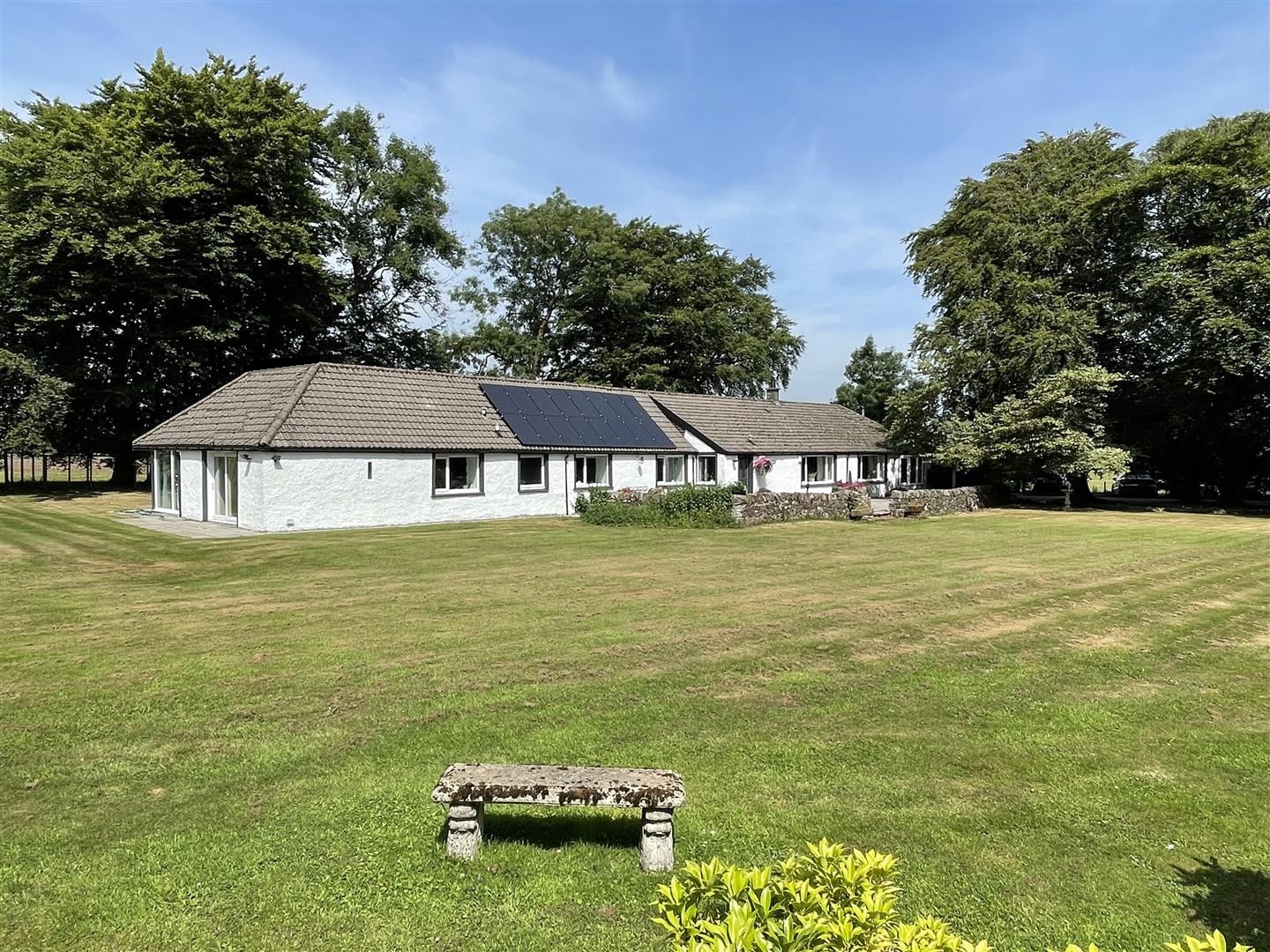

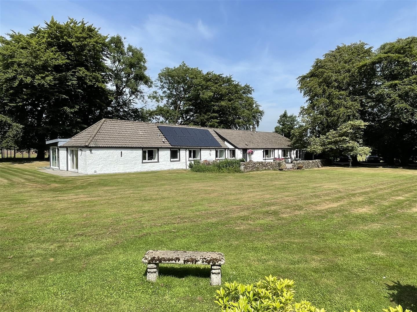

Looking at the agent's photos you linked to, the language of your property permits the use of shallow pitched roofs:
267747640_6613159535421892_8095503751456960481_n.thumb.jpg.05a017e26b5a700d1395d987d4c1ffee.jpg
268110422_6613154782089034_4433321768793961692_n.thumb.jpg.db32ae8d0d84b4ad1ca8959ddec46a37.jpg
This may help inform a suitable design. Harmonising the hipped edge section over the bedroom with its lower soffit level is one of the main challenges. By the looks of it though, the soffit line might just continue along forming a slight brow over the glazing (which is set back a little way). The pitch of this roof section would have to drop sufficiently to span the extension which is getting on for 9m! I estimate the pitch would have to be 33o on these three new planes:
  • Like 1
Posted
@Radian thats great, i actually had to double take and spot the difference there. it would be far more fitting with the house I agree.
On 26/01/2023 at 22:46, Radian said:
Only had M$ paint to hand 😂 but,
only issue i see is without changing the pitch angle of the roof over the bedroom we would have to alter the bedroom roof as well on the main house.
great idea though.

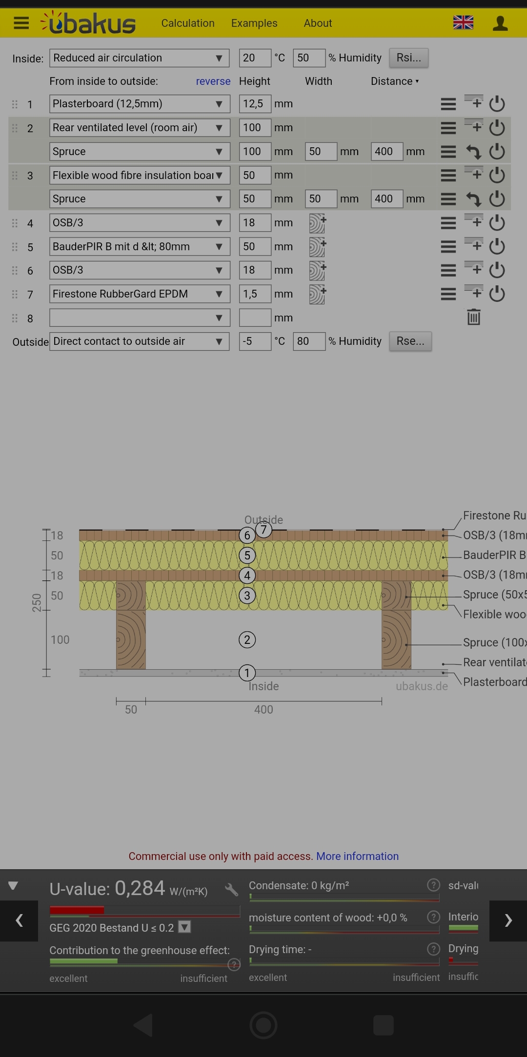

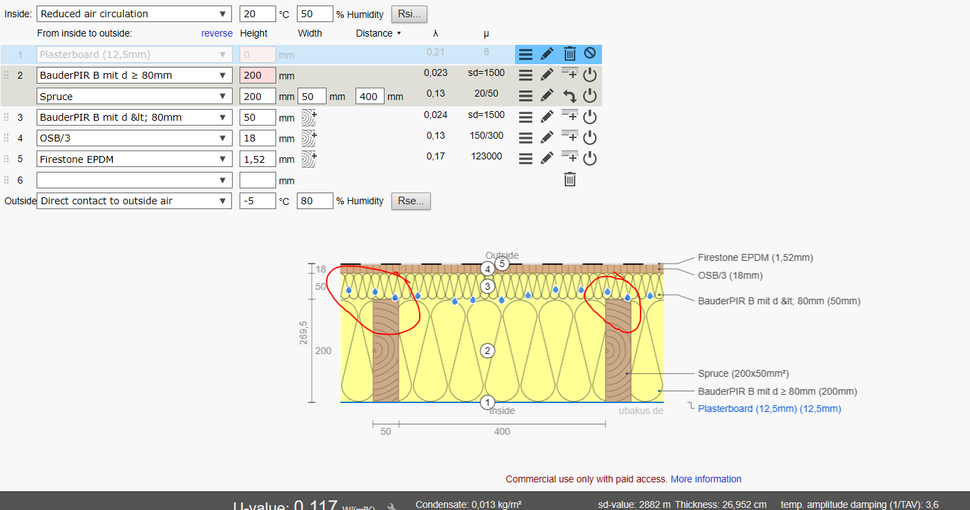

Screenshot_20230312_224536_SamsungInternet.thumb.jpg.03bc062678f809b7239fc24b4cb54ff2.jpg
Ok so I have had a look at this and I'm not 100% what I'm reading.
What I have tried to put in from unknown plasterboard there is about 200mm air before the structural timbers and osb on top.
Max osb I could build a warm roof with would be 50mm as the build would be
Plasterboard , structural rafters ,18mm osb, membrane, 50mm PIR boars insulation, 12mm osb3 and then rubber. Giving me about 10mm clearance from the tiles on the main roof.
In theory I could reduce tge slope of the last tiles so as to Rais the bottom edge or would cutting them be an option? Would rather not....
If I some how raised them then I could get 100mm insulation in there....
Posted
Screenshot_2023-03-12-23-01-26-500-edit_com.android.chrome.thumb.jpg.b2d47d270d9779bd04e8f52b5c837bcf.jpg
How about that if you can make it out.
With a warm roof and such a thin layer for insulation you'll be at poor U value.
That's why I think a metal panel might be better.
Posted
I think I'm understanding now. Thank you.  No matter what we do here with such a small insulation is going to be poor.
Absolute out the box thinking here.
If I place the osb to the underside of the structural beams... damp membrane over and in-between completely sealed off.  insulate between rafter and 50mm on top. 18mm ply and Firestone rubber.
Leave the gap below the rafter essentialy not Insulated but make a sandwich of insulation in the roof as such...
Whats the thoughts here. Stupid idea?
Posted
With insulation in between the rafters the dew point will be much nearer the inside of the house in cold weather, the roof timbers will get damp and especially when they are almost completely surrounded by impermeable PIR they will stay wet.
The DPM is really a mute point in the case above as the moisture comes from the house.

Interesting comment on the page
“In a compact roof assembly featuring Majrex®200, and using a high quality rigid insulation with a lambda value of < 0.026 W/mK, you may only need as little as 60 mm of insulation above the roof deck to ensure a safe construction. We see this as a safe solution, and are happy to write a warranty for our product, and to perform condensation risk calculations for our customers.”
In essence this is what I've been looking for. I have contacted a building contractor to get them out for costing a pitch roof. Slowly seeing the benifit.
Would like to know how the condensation calculations work. Ie first principles.
Such a difficult place to be as we have a leaking roof. Want to do the best job, but stuffed for the cost of repair.
Does annoy me when people cover up mistakes like this as I just couldn't bring myself to sell a house with this problem.

I suppose there is situation where you could just put the Siga majrex /Intello plus etc membrane inside your current ceiling, ensure the RH in the house is low, let the roof slowly dry to the inside then pump something moisture resistant and permeable like EPS beads behind the membrane.
I think it theoretically should work, again if you again have a totally sealed membrane, but I very much doubt anyone is going to offer you a warranty.
