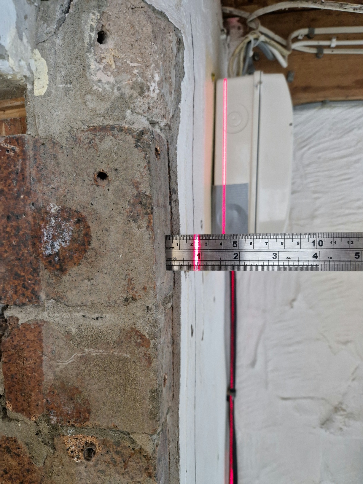

My issue is that both side of the opening are not Plumb or level.
One side you place the guide rail to the bottom brick and it runs out by arround 20mm
And the other side is the same but runs out at the bottom
I am not sure what would be the best way to attach the rails so they are plum as its quite a big run out.

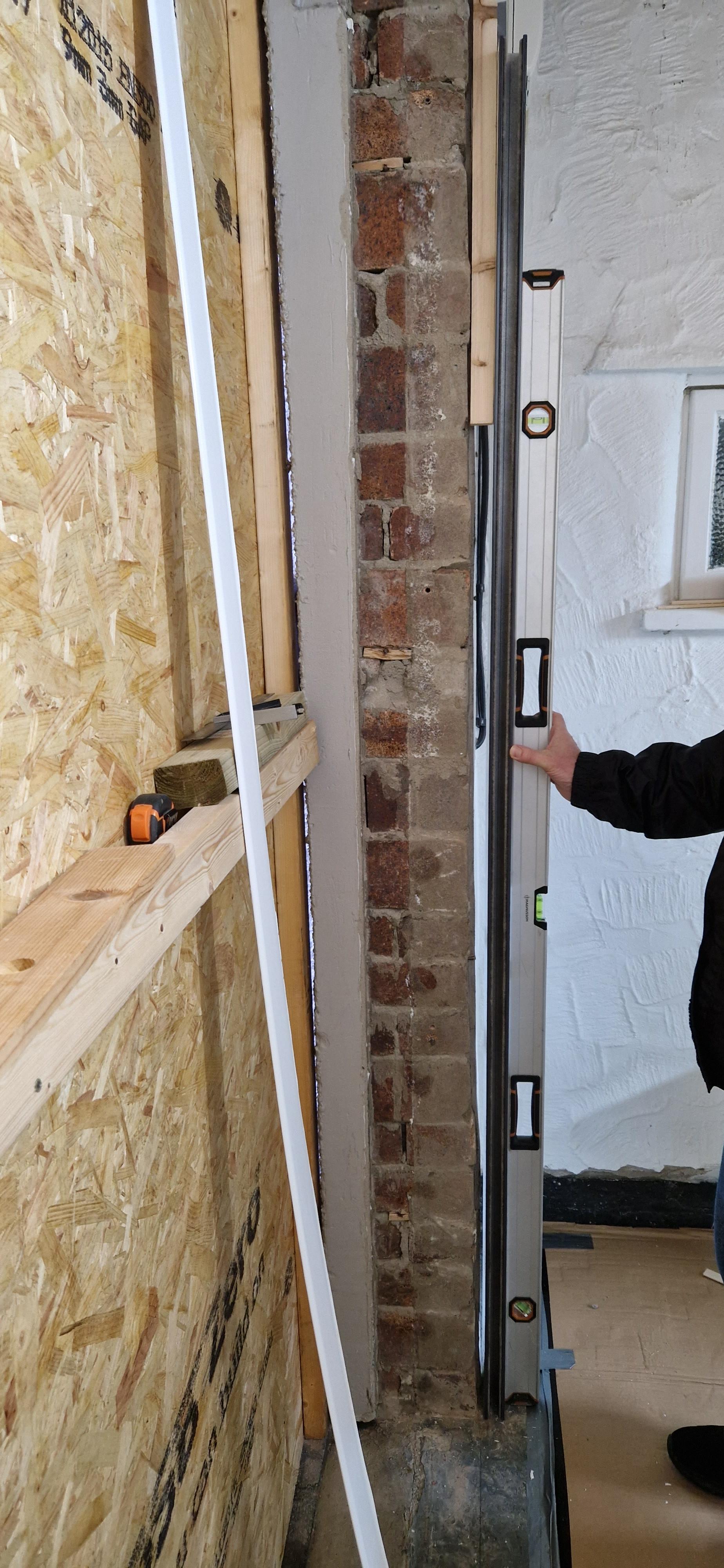

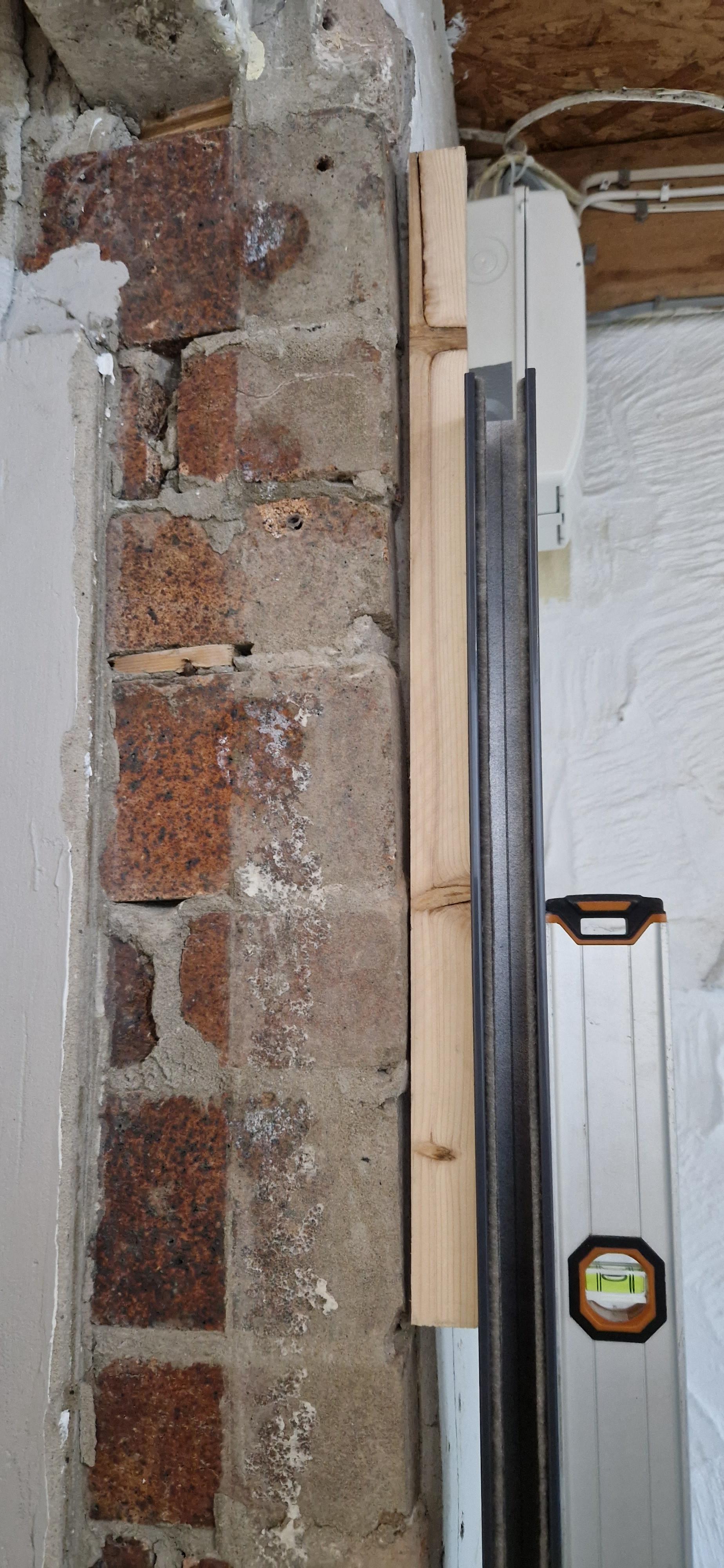

Was thinking of placing a piece of wood the hole height and packing out allowing the rail to be attached to a plumb service
Attached some photos

They don't need to be truly plumb, I would fit as best match to the brickwork as you can without bending the track to the point it kinks.
  • owen83 changed the title to Garage electric roller door installation, plumb level issues
It is essential that the top of the door is horizontal, otherwise it will twist in use and gradually distort.
Also that the runners are parallel all the way down (in the width of the door), or it will stick.
Not lining up with the walls is unimportant.

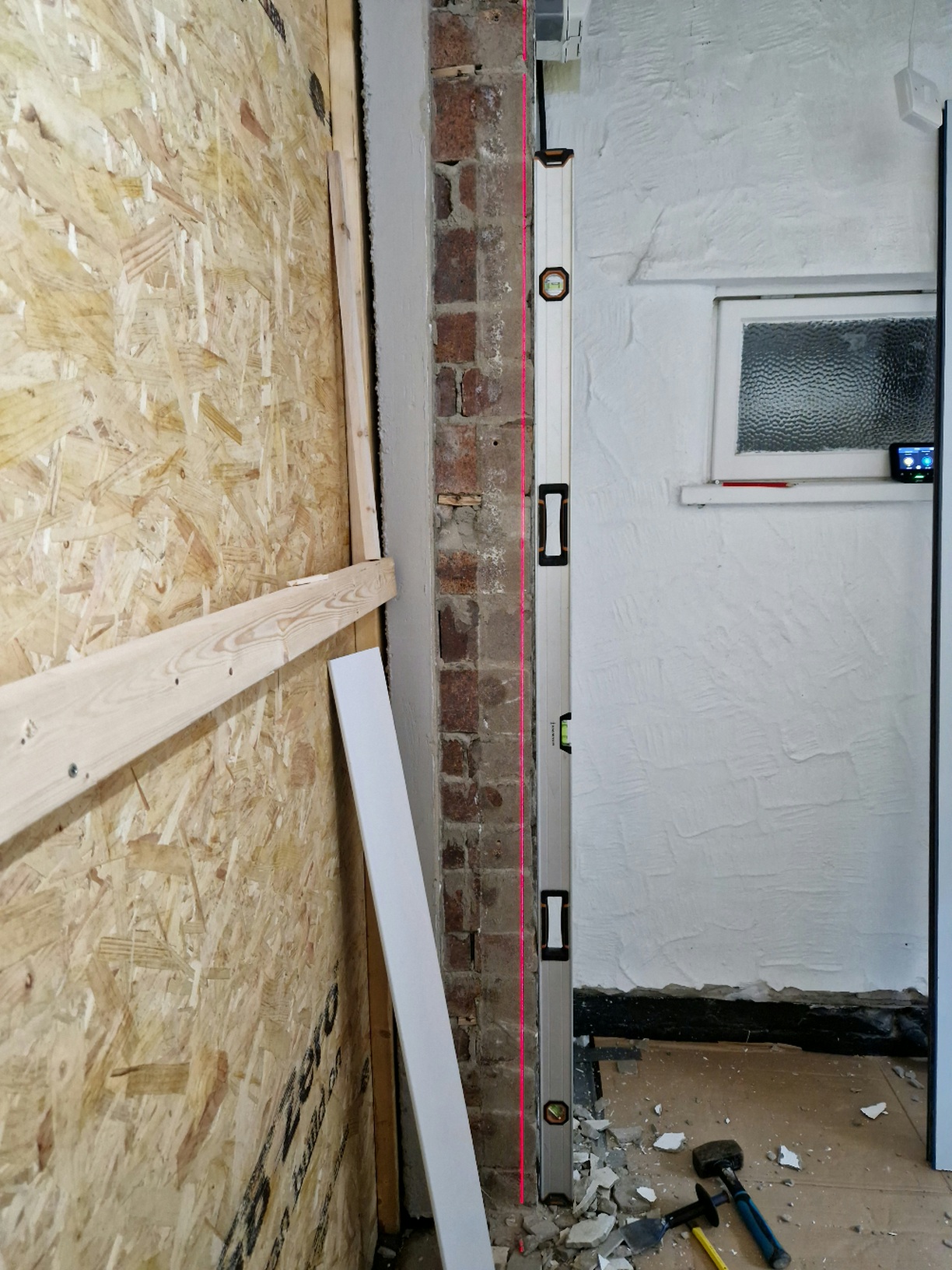

Silly question, how reliable is your assessment of 'out of plumb'? If it's just using a spirit level on end I'd get a second opinion from an actual plumb line and bob weight. Or a self levelling laser.

Thanks today I used my self leveling lazer level which showed it runs out by 24mm

Thanks this photo shows the actual run out
Don't get fixated on being plumb. As already stated it is vital the roll is dead horizontal, and it is vital the guides remain a constant distance apart and 90 degrees to the roll, so nice and plumb in that plane, but the plane you are looking at with your level does not really matter.
