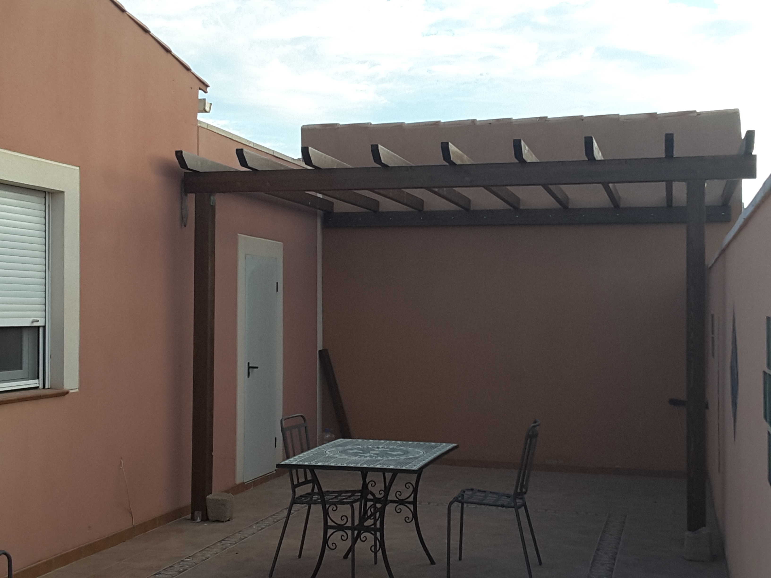

saveasteading Posted January 15, 2023 Share Posted January 15, 2023 I made my own using laminated timber, cut to size by the manufacturer. Then erected it single handed in one day. About 3m x 4m. The materials cost much the same as for a very flimsy kit. About £800 I think. On its own as a skeleton it is a feature without a purpose. Do you want shade or waterproof? Just for shade, lovely as it would be to pick grapes, any plant will drop stuff and need maintenance. But a solid roof ends up having to be a proper roof, waterproofed, otherwise it will drip and get slimy. We wanted shade so fixed rolls of sticks on top. Link to comment Share on other sites More sharing options...
saveasteading Posted January 15, 2023 Share Posted January 15, 2023 1 minute ago, puntloos said: the feet would be "in the grass" I would definitely keep the feet apart from the grass, by fixing them on plinths. This keeps them away from rot, insects and lawnmowers. For a blind system as shown, I think you have to commit to a full kit. 1 Link to comment Share on other sites More sharing options...

saveasteading Posted January 15, 2023 Share Posted January 15, 2023 38 minutes ago, Bozza said: saveasteadingany chance of a photo I meant to but couldn't find them on my phone. Will look again. Link to comment Share on other sites More sharing options...
saveasteading Posted January 16, 2023 Share Posted January 16, 2023 Found. The rafters are screwed down with very long screws. dont seem to have a photo with the covering. Link to comment Share on other sites More sharing options...

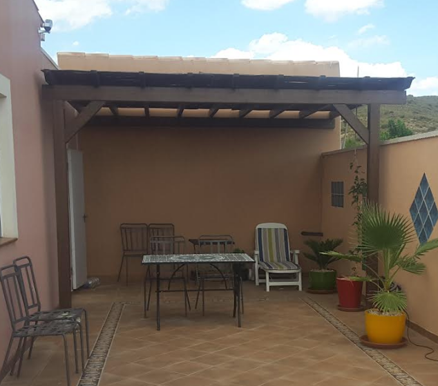

saveasteading Posted January 16, 2023 Share Posted January 16, 2023 found it. Diagonal braces added, which makes it very much stronger and improves the appearance. And stick cover for shade. like this, tied down by wires onto screws .this sort of stuff Link to comment Share on other sites More sharing options...
