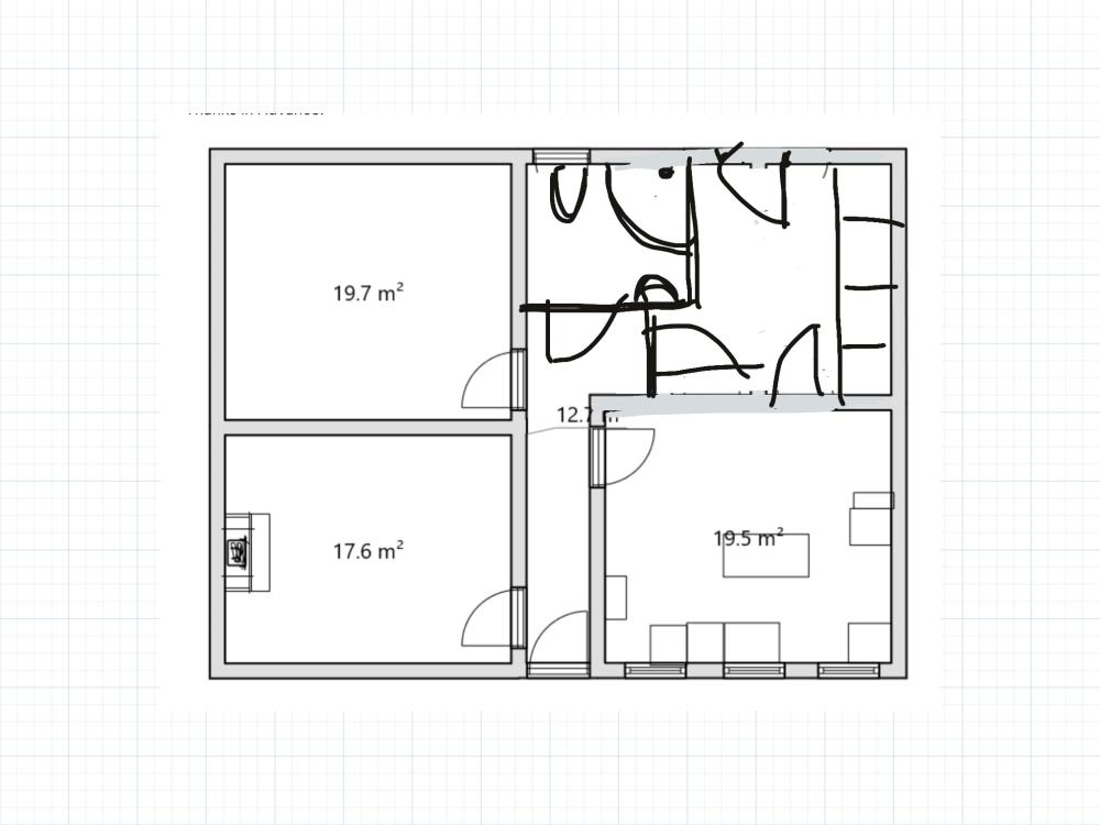

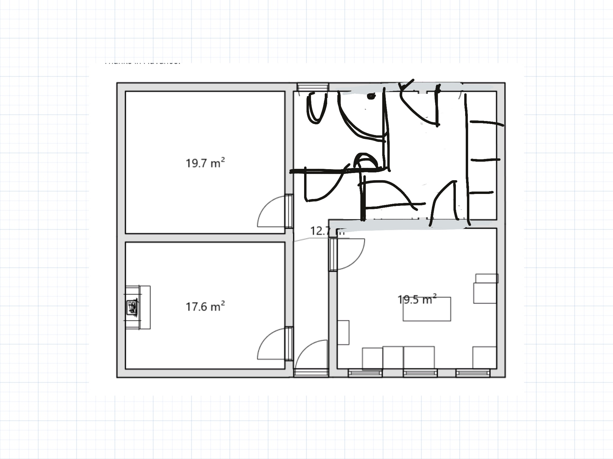

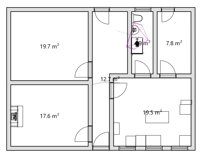

I am in the process of trying to nail down the layout for our property. To give some context the front of the property is south facing but their is no front garden and sits directly on a footpath before some parking bays and then the road. The traffic is relatively low volume however we do have large trucks and some speed bumps so even with triple glazing some noise makes it way into our lounges currently at the front of the property.
My proposal is to move the Kitchen currently back left in the pictures attached to the Front Right. This will enable us to utilise the natural light from the 3 windows and move the lounge to back left.
The area in the pictures attached which is back right is currently or was an ensuite which currently serves as a utility room/bathroom.
i would like to redesign this area to have a separate toilet and shower room and then a utility/boot room. Currently we have waste and hot and cold feeds in all 3 corners aside from the doorway.
any input is welcome. I am trying to avoid moving the toilet away from this room as we have all the services in there and can't see an issue accessing the toilet from the kitchen.
Thanks in Advance.

Hello, I wouldn’t have a WC off a kitchen!
if the other room is a bedroom, wouldn’t you want to access the bathroom from the corridor?
my other thoughts is the long corridor is not that necessary and wasted space.

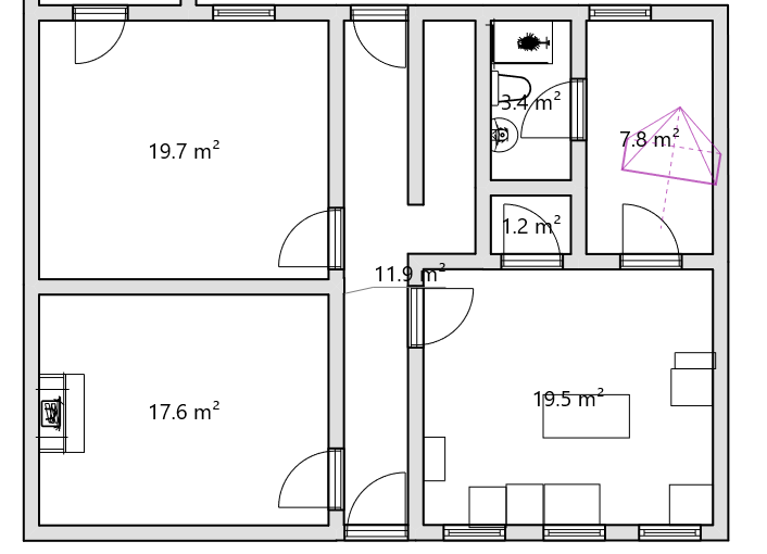

here are two options. One where the bathroom and shower is off the corridor, the other it’s off the utility.
I’d need to see your elevations to know if the doors and windows can line up nicely.
Is that what you meant?

Hi Papillon,

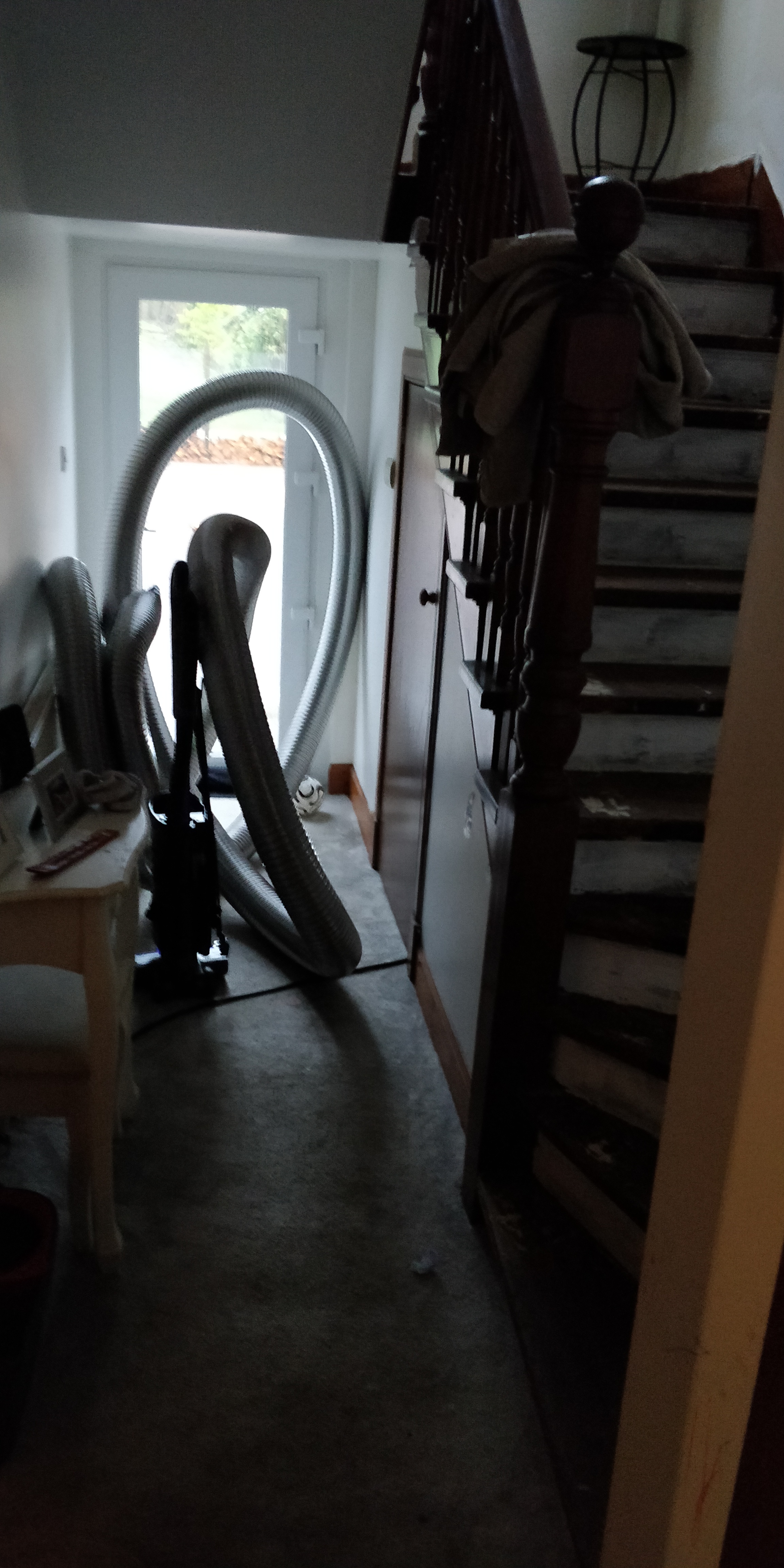

The back hallway is where the staircase is. The hallway is just over a meter wide from front to back and the staircase comes down to face the back left room. I had thought about blocking up the rear door and using that space plus what is under the stairs to have the bathroom however it would mean bricking up the doorway relocating the boiler and potentially the consumer board under the cupboard. Plus it would cut out light for the hallway. Ignore the flue liner ha.
Also we will have two lounges a kitchen and the utility room when finished.
Oh lol, I didn’t get there were stairs there, scrap that then!
but I would have the wc/shower across the back wall, accessed through the utility room. You don’t need so many back doors anyway, and it’s more hygienic than off a kitchen.
The most important thing in any house design is not the house : it's the inhabitants.  Think about their needs, and potential needs over time.

Probably not the best idea to have a loo directly accessible from the kitchen
So budget is loose but I am not trying to reinvent the wheel.
1918 Georgian Style House. Two Adults 1 toddler 1 cat and a dog.
We have capacity for guests but currently do not entertain as such but may change in the future.
We have 4 bedrooms upstairs so 2 guest rooms.
Noise from internal is not bad but during renovations insulation will be placed between floors.
Our main bedrooms are at the rear of the property another reason to move the kitchen to the front.
Kitchen Light will be vastly improved.
Ventilation will be provided via 3 tilt and turn windows.

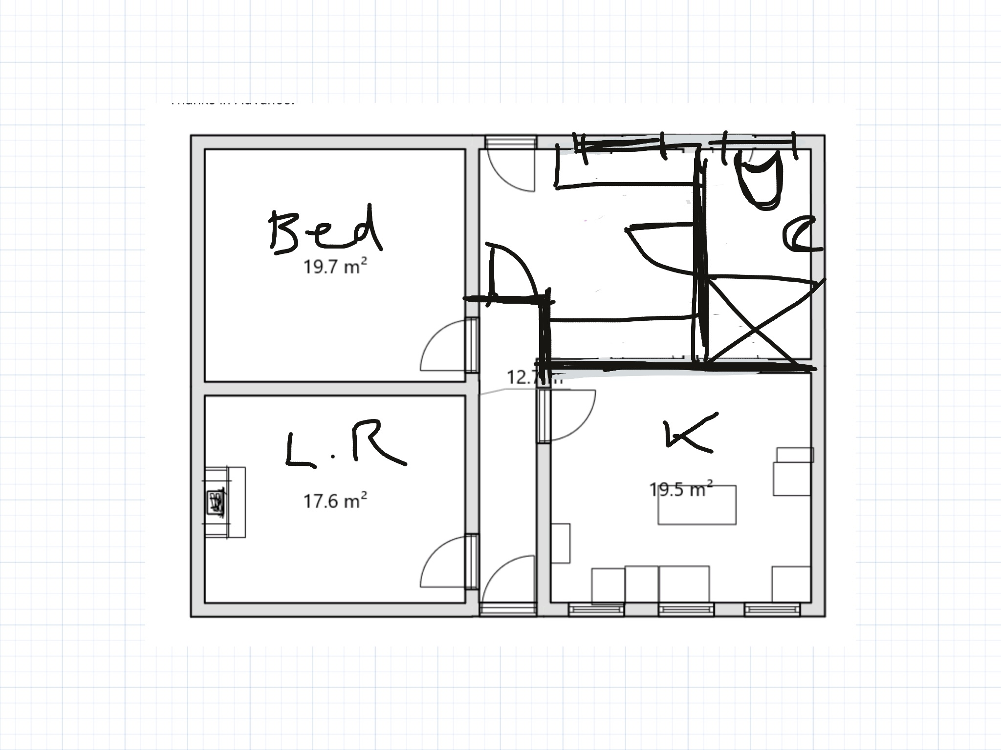

I have attached a redesign of the layout.

So from the layout as much future proofing has been included. The front left room would be our daughters lounge for when she is a teenager and has friends over. She would have access to the kitchen and bathroom. There is a middle door across the hallway before the back area which my wife and I could close over and sit in our lounge in relative peace. Cat 6 cable would be great however with the improvements in WiFi and currently using power lines we do not have any issues streaming through firesticks or TV etc. We also work from home over WiFi with no problems. Our doorways are currently 850mm wide so accessible for most wheelchairs.
So now we know is is a house, not a small bungalow.
I would hate a north facing living room that never gets the sun. So even if you want to move the living room to the back, I would knock through the two left had rooms to have dining area at the front, close to the new front kitchen (but move the doors so the dining area door is opposite the kitchen door to save an irritation)  and living area at the back, further from the noise of the road and overlooking the garden, but still able to see the sun.  You might well want to change what doors / windows open to the back garden.
That would be a hell of a treck from the living room to the downstairs WC, you would be more likely to go upstairs from the living room.

I will design out this suggestion as I believe this was one original plans with the kitchen and other front room having double glass doors facing each other to provide more light to the hallway and give the feeling the rooms were connected when the doors were open. My only stumbling block with this is management (wife) is not so keen on knocking walls through.

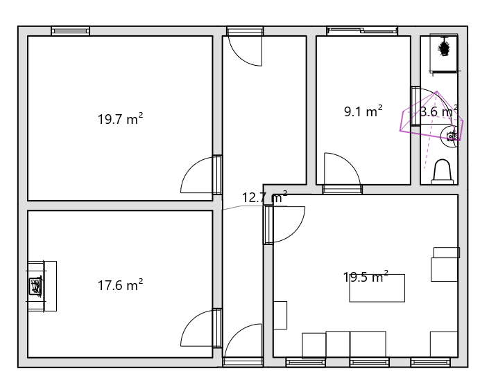

How about this?
Utility accessed via the Kitchen along with a rear door. Worktop within Utility indicated in blue. W.C. or Shower room accessed via the Utility. Within the Shower room, you could have the shower on the right (backing onto the Kitchen), a washbasin on the side wall and then the W.C. to the rear with a window above.
