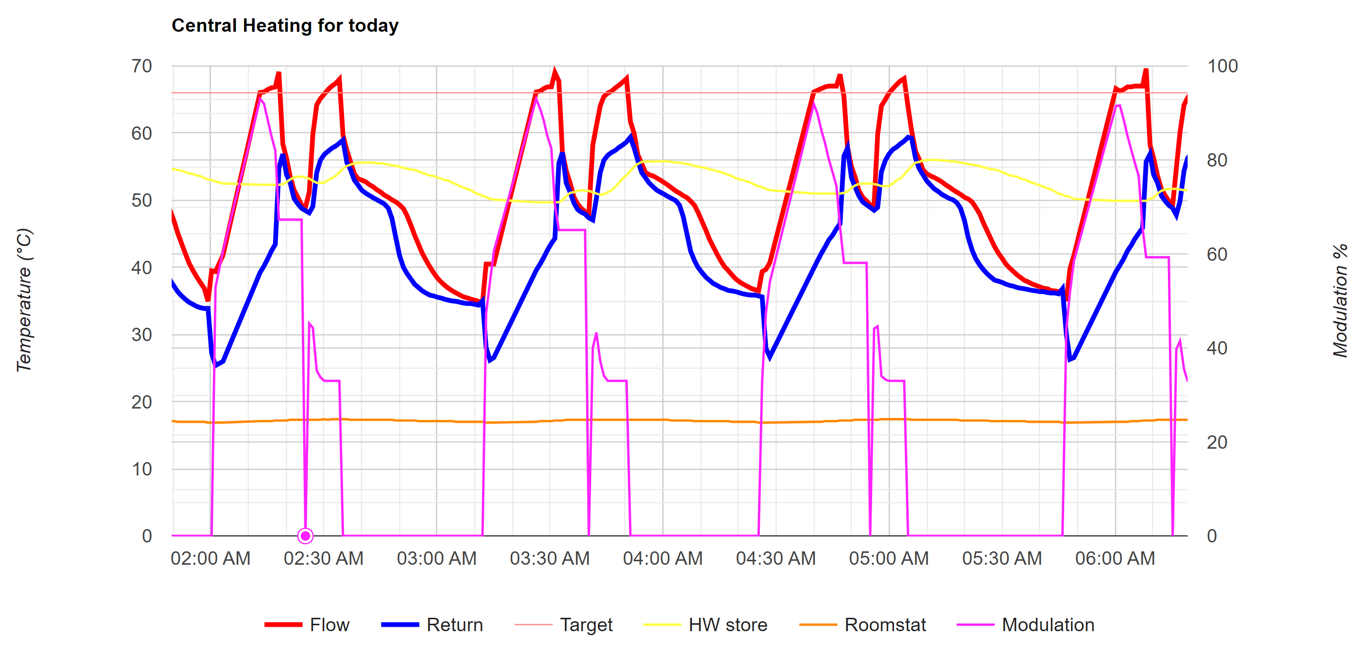

Radian Posted January 25, 2023 Author Share Posted January 25, 2023 On 04/01/2023 at 10:07, Radian said: I wish I knew the exact algorithm used by my boiler. Still not cracked the proprietary ebus protocol to monitor flow & return temps and adjust it for separate HW and radiators. Last ditch will be to A/D convert the thermistor connections so I can at least log the most significant behaviour. No need for the last ditch measure of using an A/D. ebusd and a RaspberryPi to the rescue... So now I've got a better handle on the boiler algorithm and I'm close to dynamically setting the flow temperature. But the first thing I see today is how there's still a short cycle while heating my UFH buffer (HW cylinder): The UFH has constantly been cycling the HW store all night (-5oC outside) so when the roomstat for the radiators in the house calls for heat at 2AM, the boiler fires-up and the radiators begin restoring the temperature to the overnight setback value. When the roomstat goes off, and the zone valve for the radiators closes, there's a big spike in the return temperature as all the circulation is now only flowing around the UFH/buffer combo. Modulation rapidly drops at this point but it's too late in responding and as the differential between flow and return drops to nothing, the only thing the boiler can do is shut off entirely. What I don't understand is why the boiler starts up again within a couple of minutes presumably at the expiry of the Anti cycling period (although I can't see this parameter in the big list I have, and 2 minutes seems very short) but when it does, modulation is a lot lower <40% and the UFH buffer is brought nicely up to temperature - at which point demand goes off ant the UFH freewheels around the HW cylinder for over an hour as intended. I didn't expect to see this brief boiler shut-off glitch as I was only plotting demand before. I need to figure out a way of getting a softer landing when the roomstat goes off and circulation is restricted to the UFH. Of course all this was predicated on having a single, relatively high, set-point for boiler flow but now I may be able to reduce that for the radiators - given that I can have independent flow temperatures for radiators and hot water. Link to comment Share on other sites More sharing options...

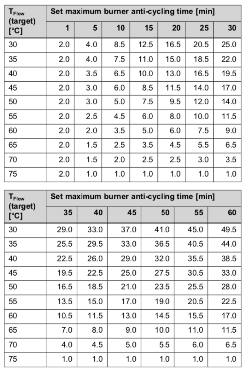

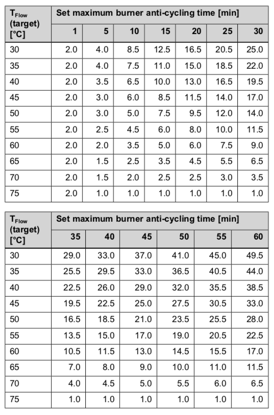

Radian Posted January 26, 2023 Author Share Posted January 26, 2023 15 hours ago, Radian said: (although I can't see this parameter in the big list I have, and 2 minutes seems very short) Vaillant say "If you are an engineer, the maximum anti-cycling time can be adjusted under the setting D.002 using the following table to produce the desired lockout time." reading the parameter D.002 that I already thought was the right one I see: bai BlockTimeHcMax minutes0=20 min [max. burner anti cycling period at 20°C Flow temperature setpoint] d.02 Which is why I expected 20 minutes but that's for a 20oC flow setpoint. This table sort of explains why I'm only getting something like 2 minutes as the setpoint at the time was 66oC Link to comment Share on other sites More sharing options...

Radian Posted February 3, 2023 Author Share Posted February 3, 2023 On 27/01/2023 at 18:06, SimonD said: @Radian, I'm looking at this with interest. You're not the only one to find a glitch with Vaillant modulation and anti-cycling - a discussion you may have already come across http://vaillantcyclingproblem.blogspot.com/2012/01/anti-cycling-mode-and-d2-parameter.html. There is clearly a link between the flow & return delta, but I'm interested to understand the size of your buffer and volume of ufh system. It would also be interesting to know actual room temp, plus the time points of motorised valve on/off switching for ch. How have you set up the valves? E.g. when calling for heat does your system provide heat to both ufh/hw and ch, or do you swtich between the two? I somehow missed the latest activity in this topic. I think the behaviour I've logged is to be expected - there's nothing for it but to shut down the boiler when the modulation bottoms out (10kW in my case) but the return keeps climbing. There's evidently a couple of degrees of grace allowing the flow temperature to exceed the setpoint - but then enough is enough and cycling begins. What threw me was the expectation I had before I looked at the table. Quoting the delay for a flow temperature of 20oC is always going to be unrealistic. As for my setup, it's constantly evolving 😃 The plot above was just for the UFH zone which runs of the 160L 'buffer' of my HW cylinder per: Somewhat unconventional but it works for me! Link to comment Share on other sites More sharing options...
