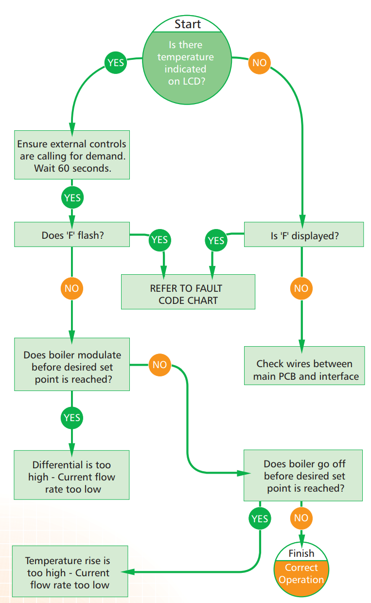

Radian Posted December 25, 2022 Share Posted December 25, 2022 Looking at the Glow-worm technical guide that applies to my condensing boiler, I'm not sure which set point they're referring to in the following flowchart: "Does boiler modulate before desired set point is reached?" "Does boiler go off before desired set point is reached?" Which set point? The demand thermostat or the boiler flow temperature? Because the boiler can have load/weather compensation the boiler flow temperature might be variable so how would you know what the setpoint was? I'm guessing it must mean the external heating controls. Incidentally, I'm poking about in this area to make sure that I have the optimum setting for my circulating pump head. Link to comment Share on other sites More sharing options...
JohnMo Posted December 26, 2022 Share Posted December 26, 2022 Not got the same boiler, but have found on mine, the following. On the controller there is a user menu and an installer menu. In the installer menu under the info tab, can see what the set point is for the boiler. Ours is running WC, and when I looked last the set point was 30. The heating pump runs all the time in WC, when the return temp has dropped a couple of degrees below set point, the boiler fires up. On mine I can set what is called the gradient, this is how quickly the boiler gets up to temp, I have set this as low as I can, so the boiler run time is high. Once the boiler has got to the set point temperature on the return water or if the max supply temp has been reached the boiler switches off. My max is set to 40, so boiler either goes to 40 or a return temp of 30 which ever occurs first. 1 Link to comment Share on other sites More sharing options...
SimonD Posted December 26, 2022 Share Posted December 26, 2022 (edited) 16 hours ago, Radian said: Which set point? The demand thermostat or the boiler flow temperature? In this instance I believe that the flowchart is referring to the room thermostat set point rather than the flow temperature set point. Ideally you want to see the programmer/boiler modulating before this set point is reached. (Interestingly on my Honeywell Evohome setup it tells me the percentage modulation compared to the boiler flow set point, which as you say will vary according to how close the room is to its set point and weather conditions) It seems, however, that the flow chart is a troubleshooting one that looks at diagnosing problems with modulating or cycling of the boiler due to flow rate issues within the heating system? I've seen this recently where low flow rate causes a too high flow/return temp differential (e.g. more than 38C and thus eventually throws a fault at the boiler), or that flow temp rises too fast so the boiler has to switch off (flow temp rises above the flow temp set point and too quickly), again due to low flow rates. With the new building regs I reckon there's going to be far more head scratching going on with Delta T/Flow Rates/Modulation/Cycling - in the real world it's turning out to be a time consuming process to get right! I'm finding quite a few issues setting all this up with new boiler installations on existing heating systems. Does your boiler have a flow rate sensor and a way you can access this information? Then put in a phone call to Glow worm customer technical support and see if they can give you specific flow rate figures to work by (Sometimes they don't like giving out too much info mind you). Alternatively, there's a straightforward calc given by Grundfos: https://www.grundfos.com/sg/learn/research-and-insights/calculation-of-flow. Or there's the CIBSE Domestic Heating Design Guide that has a more detailed section on flow rates: https://www.cibse.org/knowledge-research/knowledge-portal/domestic-heating-design-guide-2021 Edited December 26, 2022 by SimonD 1 Link to comment Share on other sites More sharing options...
Radian Posted December 26, 2022 Author Share Posted December 26, 2022 7 hours ago, SimonD said: It seems, however, that the flow chart is a troubleshooting one that looks at diagnosing problems with modulating or cycling of the boiler due to flow rate issues within the heating system? Yes, as I don't have a flow meter I'm only able to use approximations like the grundfos link provides. Having very little confidence with that I was looking at the modulating behaviour of the boiler. 7 hours ago, SimonD said: With the new building regs I reckon there's going to be far more head scratching going on with Delta T/Flow Rates/Modulation/Cycling - in the real world it's turning out to be a time consuming process to get right! I'm finding quite a few issues setting all this up with new boiler installations on existing heating systems. Now you're talking about something very dear to my heart! I'm highly intrigued by the recent changes to Part L covering the replacement of boilers and the requirement for radiators to be sized for operation at 55oC This is very eye-catching for people like me with a 14 year old boiler expecting it to be pushing up the daisies any day now. I've read interesting discussions in social charity circles about the impact this change in legislation will have on home owners. The stats on boiler replacement show that many are carried out in emergency situations - AKA distress purchases where loss of heating and hot water are serious events requiring rapid solutions that need to place a minimal cost burden on low-income families. Then along comes the heating engineer obliged to meet Part L in whatever way they can. On the menu will potentially be expensive high efficiency radiators to replace ones that only worked adequately on 75oC flow and expensive heating controls to tease out the last few drops of efficiency (or in the case of heat-only or regular boilers with HW cylinders, external controls to provide separate flow temps for CH and DHW (e.g. another ~£500 to get this functionality out of my current boiler)). I'd love to know your experience of this? Link to comment Share on other sites More sharing options...
