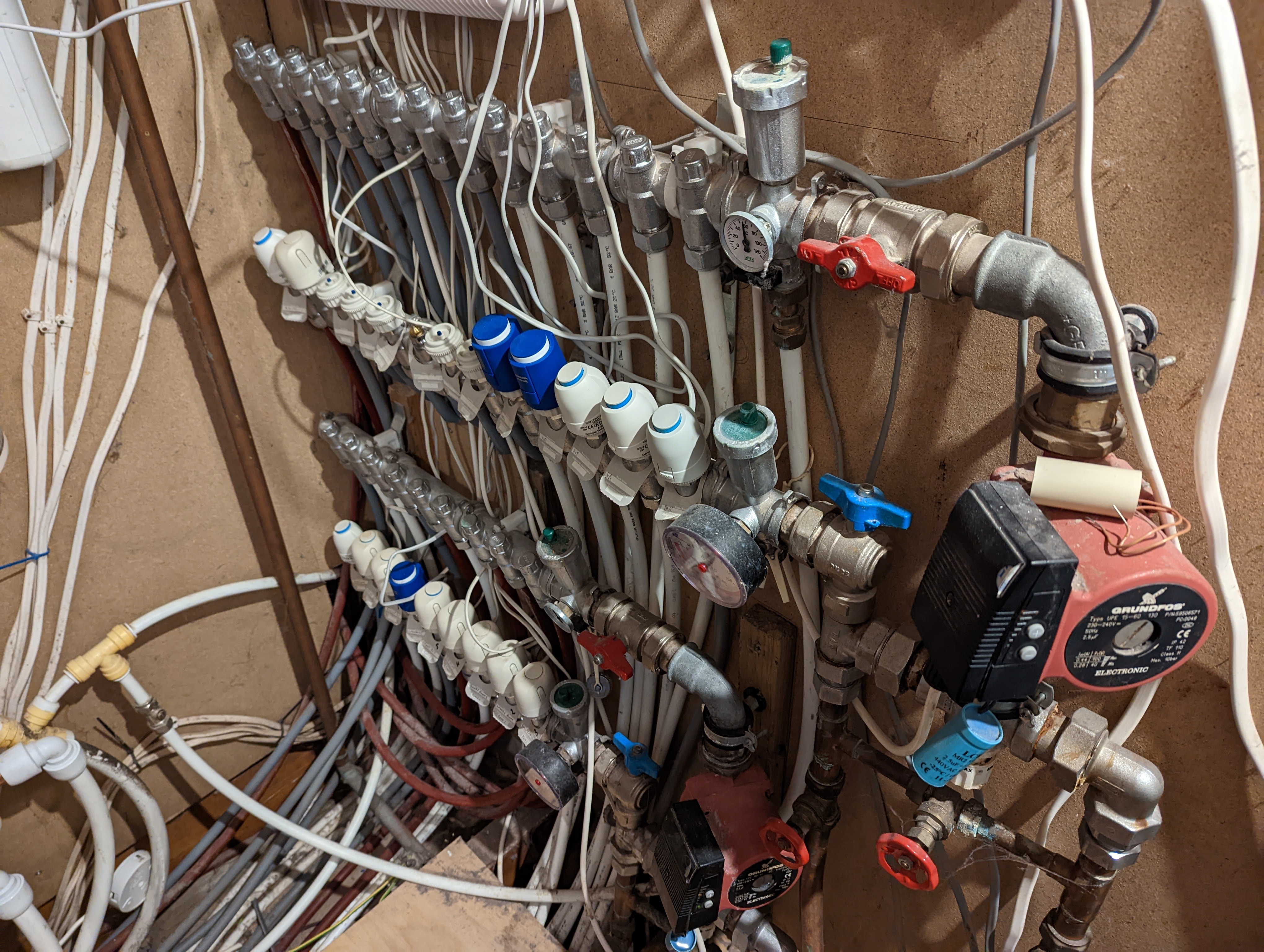

We moved into a property back in May and are now finding that the cost of heating it has been more than we anticipated, even with the price hikes.
I started checking out the 20 year old UFH system and uncovered half a dozen duff actuators (which I've replaced) and six circuits where the actuator pins are solid (again replaced). All circuits and zones are now functional. What I have found though is that the manifold pressure isn't constant, on even close.
I'm learning about UFH as I go, terminology and methods easily throw me but, I'm gaining knowledge, but it's taking time.
The system to me is a rather untidy mess. Nothing was labelled, no design documents. I've documented as I go. As far as I can tell, the whole system is fed via a Grant Eco Vortex oil boiler. It does a great job at providing heat and there appears to be plenty of water pressure - it being a closed pressurised system as far as I can tell (the thermal store being on the first floor and shower roses at equivalent top of tank height). In terms of UFH topology, it seems like a common inflow and outflow to two Far manifolds, one driving the top floor, one the bottom floor. Each manifold has a Grundfos pump and there is one additional pump (not sure what that does tbh). Each circuit is controlled via mechanical blending valves.
The top manifold drives the ground floor, the bottom, the top floor. Each has a separate wiring centre with wired 240v thermostats.
Having replaced the actuator pins (some on each manifold), I've done my very best to bleed everything using the inflow and outflow ports on each manifold. After one false start, I'm now pretty confident that the bleeding has done a reasonable job. All room circuits now get warm and the thermostats demand heat as and when necessary with the associated actuators doing their job and, the rooms get warm!
All of that said (and pressures and temperatures were working as expected before I meddled) I now find the following:
- Zero heat demand for several hours and the manifold pressure gauges drop to almost zero - the top manifold being worse than the bottom one. The inflow manifold temperatures drop down to 20 or 30c (not unexpected with no heat demand) and the outflow temperatures are a little below that (again expected).
- If a demand is made in a circuit, the associated pump energises, the associated actuator begins to open, the inflow manifold temperature starts to increase and the pressure gauge starts to rise.
- At some point demand will cease, the pump will turn off and pressure on the gauge will slowly fall, quite slowly.
- Over many cycles the manifold pressure will get to between 1 and 2 bar and cycle up and down as heat is demanded.
- If no demand is made for a lengthy period (I don't know how long - certainly hours) the gauge pressure will gradually fall away and finally go back to the state described in the first bullet.
I think I'd expected the pressure to remain relatively constant all the time - but maybe it shouldn't?
I haven't touched any of the flow adjusters and have no plans to go near them. I have played, a bit, with the inflow, outflow and mixer settings - the manifold temperatures being about 55 when I started (but less now). I don't know if I've upset something there - we got a bit desperate over the weekend when we had zero flow under any circumstances, thankfully addressed the next day with more copious system bleeding.
Our property gets it's cold supply from a bore hole that we own. The mains is pressurised using a big blue space rocket like thing in the cupboard above the manifolds. I found this pressure vessel by the thermal store
I don't know if this pressurises the hot water for personal use of for the central heating. I struggle to see where the pipes go - and again, no documentation.
So, is the variability in pressure on the gauges normal? If not, any suggestions as to what I have done wrong or simply haven't done at all?

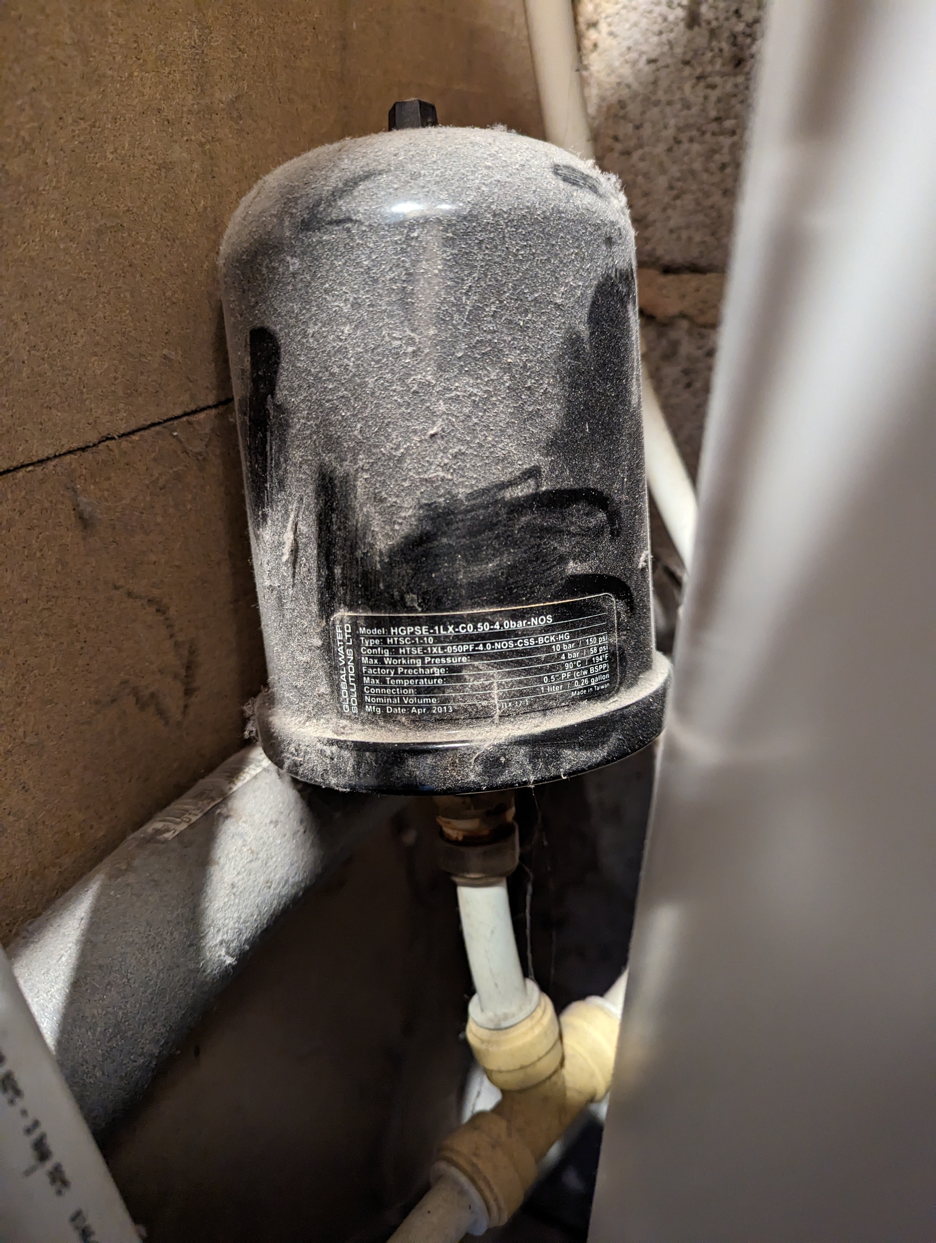

I've looked far and wide but haven't found a red or white one - just the black one, with a factory set pressure rating of 4 bar (but I haven't checked it functionally). I assumed that the CH pressure setting would be around 1.5 bar anyway.

Your gauges are showing how much pressure the pump is having to develop to pump water around.  As the heating demand is switched off the drop is just pressure depleting to show the system head from thermal store header tank.  10m of head is 1 bar pressure on the gauge.
If your UFH is taking it's feed from the thermal store, your pumps may need to be turned down. Keep reducing its speed until you see a change on the flow gauges, then take up to next speed.

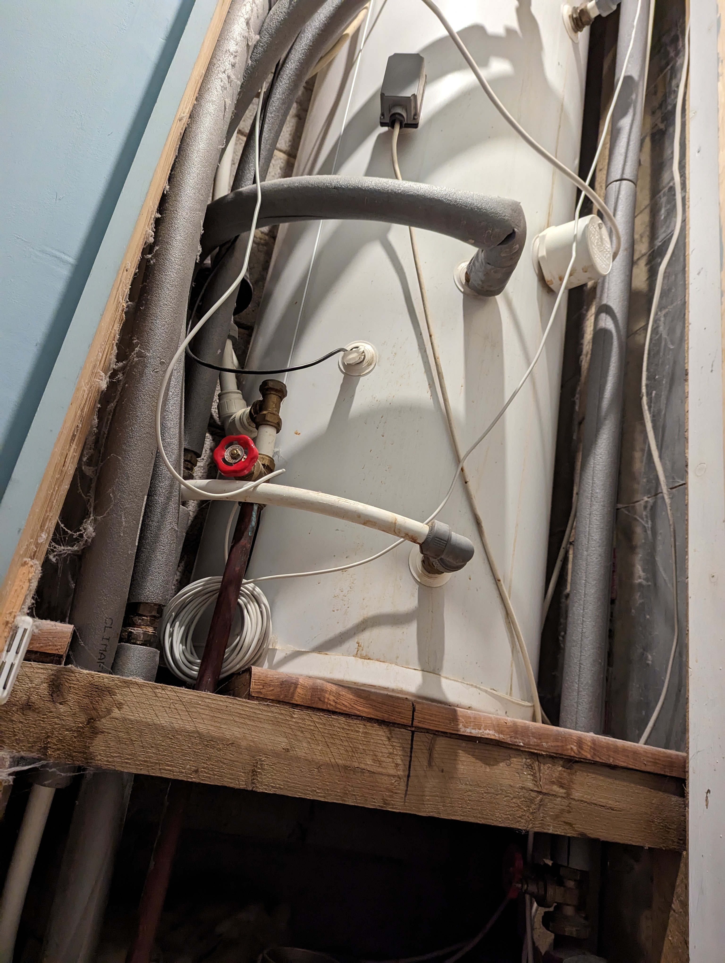

Can you post some pictures of your hot water tank and pipework and other gubbins around it?
I think the black vessel is the expansion for the DHW ( domestic hot water ) coil inside the thermal store. If all taps are closed and you heat that from cold, the water held within the DHW coil needs to expand somewhere, and that is where it goes. Very difficult to comment without seeing where every pipe goes to / from in detail of course.

I think the same. The static head ( gravity pressure ) is displayed on the gauges and then that value rises when the pumps force water into the manifold rails. As there are differing values of resistance, with x number of actuators open / closed, those values will be variable but will reflect the pump creating pressure between itself and the available runoff into the loops of UFH. Rolling back down to zero / near zero says this is indeed likely to be a gravity based heating system vs sealed and pressurised. I assume you have not had to top up via a filling loop and have a gauge and ( typically ) red heating expansion vessel ( as Dave asks )?
A sealed and pressurised system kit would look like this ( LINK ) so if this is not present you are on gravity, also if you've been venting a lot you would have run out of stored pressure by now and would have had to 'top-up' via the flexible silver hose ( as seen in the image ) so this further reinforces the gravity assumption here.

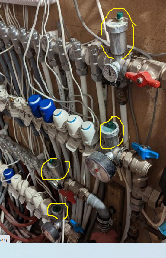

Air in the system is a killer of UFH as the flow rates around the loops are sub 5l/p/m, so they are just not flowing fast enough to 'blow' the air out by the force of circulation. I would recommend getting these all purged properly, and having the automatic air vents replaced without hesitation. The items circled in yellow here;
These automatic air vents simply unscrew from a 1/2" BSP thread and can be bought from most local plumbers merchants, albeit they will likely come in brass then and not chrome. The ones you have may well have a black rubber o-ring for hand tight installation so you may want to order the same again, or the brass ones will work with a few turns of PTFE tape on them. Here's a link to suitable replacements if you want to order online ( LINK ) vs the "buy local and PTFE them" option ;)
This fix will allow the air to be expelled without you constantly monitoring / babysitting them, and work automatically to release the air whenever it presents itself. Without these functioning properly it is likely you are missing air which then gets sent back around the loops, infinitely.

Remember that the thumb cap on top of the new vents stays OPEN, and do NOT shut them after installing them. These are designed to be left open for life, so venting air in your absence.

The black expansion vessel is about a third of the way down the picture on the left hand side of the store. The coil of wire isn't part of the thermal store - it's part of a temperature monitoring system for something else. Not shown here is the expansion tank. This is stored on a platform above the ceiling of the walkway through and sits above the tank thus confirming what has been suggested : this is a vented system. There is no red pressure vessel, anywhere, as far as I can tell.

With regards to bleeding, and the automatic air vents, certainly, I'll have these looked at (there's no way my wife will allow me to do this right now!). The affected manifold is on floor one and the circuits are below on the ground floor. When I bled the top manifold, I did the following: I connected a mains feed to the inflow (just below the top inflow temperature gauge - just as in the picture) and a garden hose to the outflow manifold. Then I closed the inflow and outflow gate valves. I then made sure each of the circuits was closed and opened just one (at the far end). I opened the gate valves on the hoses (inflow first) and ran water through the circuit for about 10 minutes. I lost the will to live waiting any longer. Some air came out at first but, after that, it was just a gentle flow of water. I then closed off that circuit and moved to the next one, repeating the process. Once complete I closed off each of the gate valves on the hoses.
