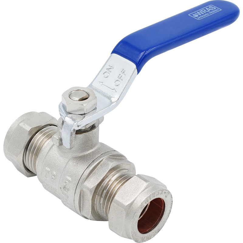

Radian Posted December 15, 2022 Share Posted December 15, 2022 So it's all internal. Did the plumber use any isolators beyond the main stop valve? Link to comment Share on other sites More sharing options...
recoveringbuilder Posted December 15, 2022 Author Share Posted December 15, 2022 3 minutes ago, Radian said: Very important this! I don't know what your system is like but It sounds like the cold taps and hot water cylinder are gravity fed from storage tanks in the loft. If you've had -14oC the problem might be a frozen pipe in the loft. When this thaws it could mean a leak. If you do have pipework in the loft you really need to have it inspected for splits. If your system is gravity fed from the loft there should be an isolating valve somehwere accessible i.e. in an airing cupboard on a pipe going up to the ceiling. Seeing as you have no water except for the kitchen tap, as a precaution I suggest you turn off any isolating valves. Again, if it's gravity fed from a storage tank in the loft then there may be an isolating tap near where the water comes out from the bottom of the tank. This would also be wise to close as the tank could still empty through a burst pipe when thawed. All the above is moot if you have direct water fed to an unvented hot water cylinder and to cold taps - with all pipework in heated spaces but there should still be an isolator somewhere. As a final thought, your household insurance firm might help you get a plumber as they will understand the importance of containing this potential problem. No tanks in the loft and no pipework, tank is a megaflo and it’s on the ground floor. Something in the back of my mind tells me we had this problem a couple of years ago but something else is telling me it was an air lock but I’m damned if I can remember and unfortunately my hubby is in no fit state to remember, I think he’s actually forgotten all about home and is in his own little world of the hospital, it’s so frustrating because in normal circumstances he could have sorted this! Link to comment Share on other sites More sharing options...
recoveringbuilder Posted December 15, 2022 Author Share Posted December 15, 2022 2 minutes ago, Radian said: So it's all internal. Did the plumber use any isolators beyond the main stop valve? What are they?? Link to comment Share on other sites More sharing options...
Radian Posted December 15, 2022 Share Posted December 15, 2022 Something like Link to comment Share on other sites More sharing options...
recoveringbuilder Posted December 15, 2022 Author Share Posted December 15, 2022 2 minutes ago, Radian said: Something like Where would these be? Link to comment Share on other sites More sharing options...
Radian Posted December 15, 2022 Share Posted December 15, 2022 In the kitchen near where the cold main comes in. Your plumber would know if he used any. It's not mandatory though. I really can't see an airlock completely shutting off mains pressure water. Too much of a coincidence in this unprecedented cold spell. At the very least I would suggest you turn off the main stop tap for the house before going to bed tonight. fortunately any leak would be limited to the small quantity of water in the pipework with the main water turned off. 1 Link to comment Share on other sites More sharing options...
