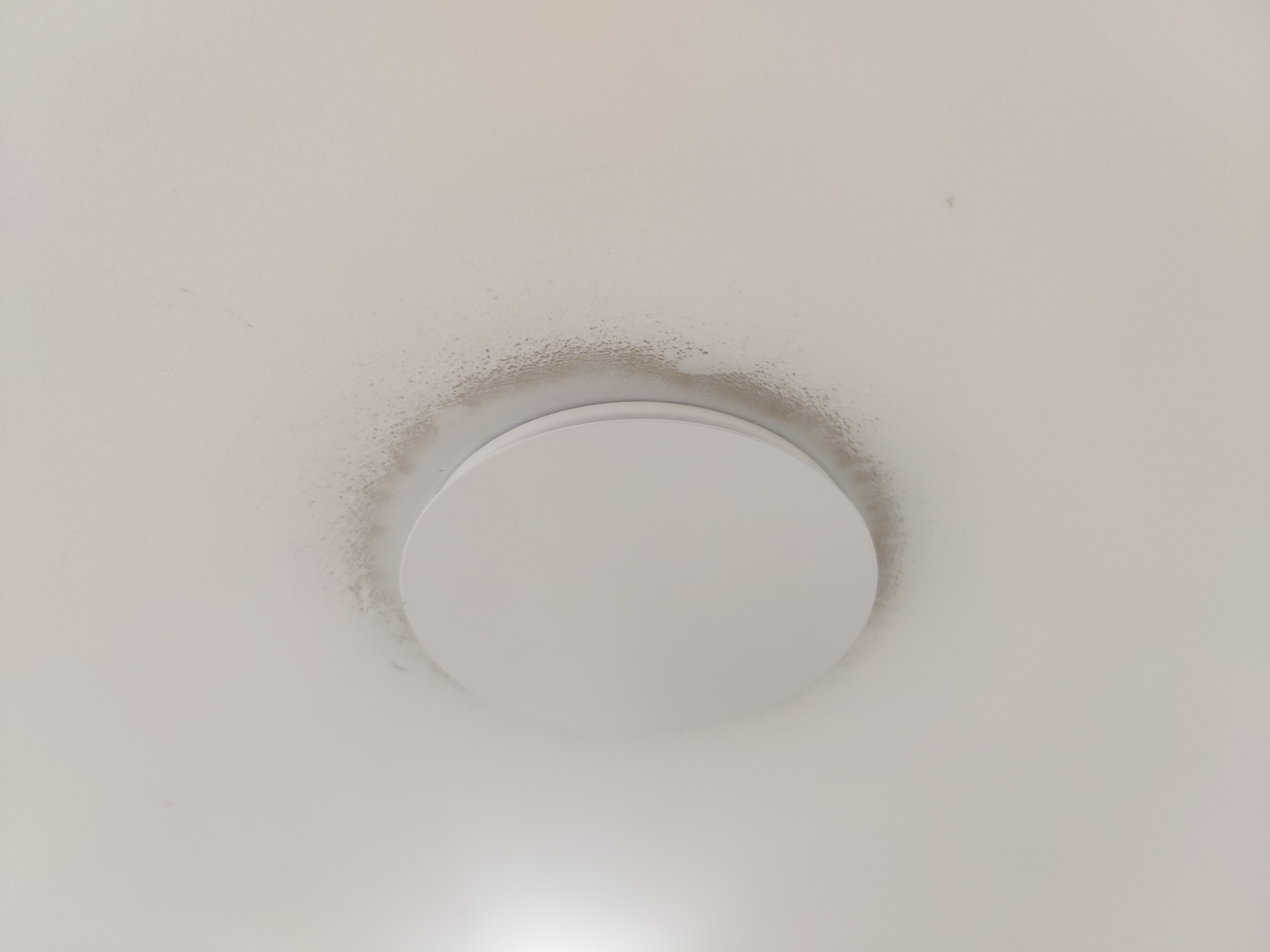

Patrick Posted December 12, 2022 Share Posted December 12, 2022 Been running mvhr for around 4 months now . Vacuuming the filter and cleaning it regularly (1nce a month) and still there is this dirt circle building around the mvhr outlets. Any one else had or has that problem? Link to comment Share on other sites More sharing options...

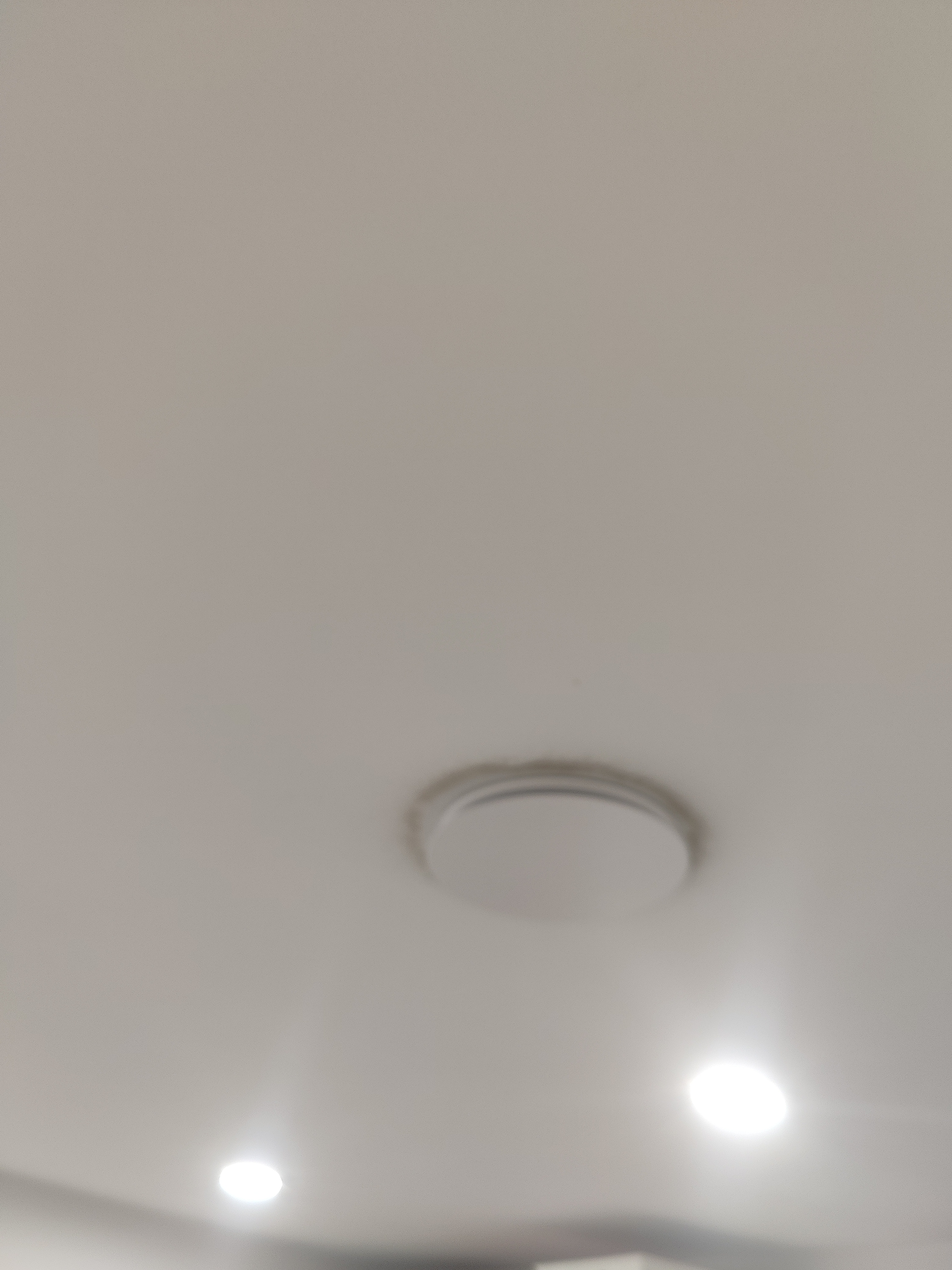

MJNewton Posted December 12, 2022 Share Posted December 12, 2022 (edited) I haven't, but then my vents don't fire out quite as close to the ceiling as yours appear to. That said, I don't get much (if any?) dust/dirt building up inside the vent and its supply pipe as the air being pumped in is reasonably well filtered. Do you have a filter installed in the MVHR unit? (Edit: Sorry, you quite clearly referred to the presence of a filter!) Edited December 12, 2022 by MJNewton Link to comment Share on other sites More sharing options...
Marvin Posted December 12, 2022 Share Posted December 12, 2022 No problem here. Four years now and no marks. Is the insulation tight against the ceiling and pipe? What are the filters like? Where is the MVHR drawing fresh air from? Link to comment Share on other sites More sharing options...
Marvin Posted December 12, 2022 Share Posted December 12, 2022 1 minute ago, MJNewton said: I haven't, but then my vents don't fire out quite as close to the ceiling as yours appear to. Nor do ours. Link to comment Share on other sites More sharing options...
Patrick Posted December 12, 2022 Author Share Posted December 12, 2022 3 minutes ago, Marvin said: No problem here. Four years now and no marks. Is the insulation tight against the ceiling and pipe? What are the filters like? Where is the MVHR drawing fresh air from? Insulation is cellulose blown into the ceilings. Filters are original ones from ubbink Fresh air drawn from outside -close to the gutter... Not specifically dusty or dirty there. Link to comment Share on other sites More sharing options...
Roundtuit Posted December 12, 2022 Share Posted December 12, 2022 Yes, similar to yours; a really fine dust that seems to stick by static. It comes off easily enough with the brush attachment on the hoover. Filters are changed every 6 months. 1 Link to comment Share on other sites More sharing options...

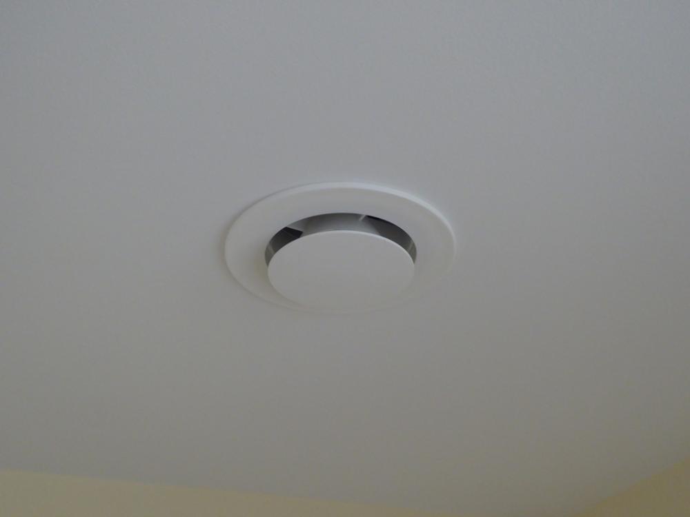

MJNewton Posted December 12, 2022 Share Posted December 12, 2022 (edited) Maybe we all get it, but only certain types of vent that blow the air against the (slightly rough) ceiling surface end up 'catching' it. Here's my type, which whilst intended to throw air sideways by virtue of the internal profiling, won't ever throw it towards the ceiling so my dirt/dust is probably just landing elsewhere in the room! Edited December 12, 2022 by MJNewton Link to comment Share on other sites More sharing options...
j_s Posted December 12, 2022 Share Posted December 12, 2022 Same issue here but only on a couple of inlets. 1 Link to comment Share on other sites More sharing options...
