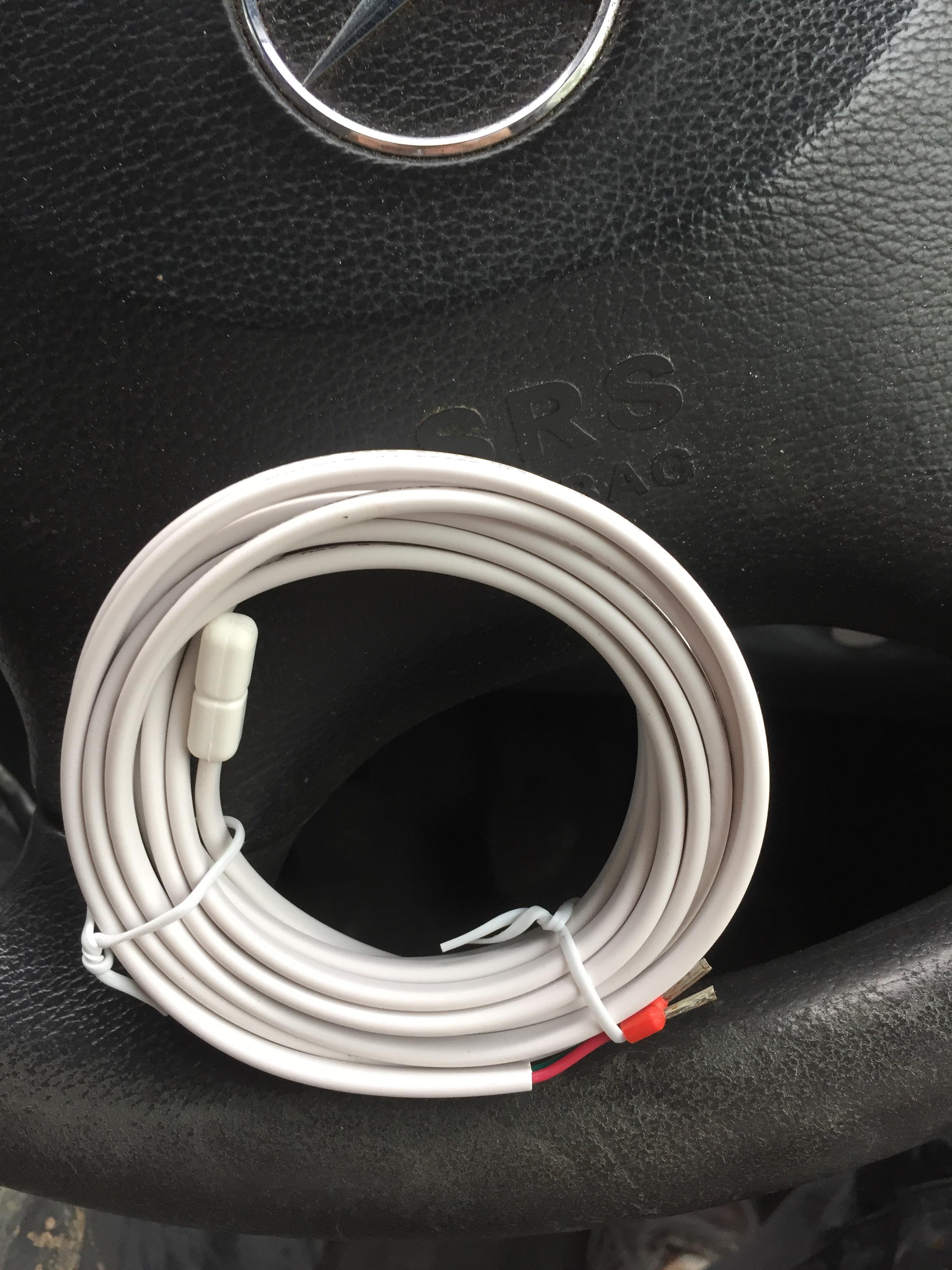

Onoff Posted July 7, 2017 Posted July 7, 2017 (edited) Erm... Don't tell me you've NOT got something like this knocking around: https://www.victorianplumbing.co.uk/warmup-replacement-floor-probe-for-3ie-4ie-thermostat-2015-upgrade?campaign=googlebase&gclid=CNr0r-fd99QCFcEp0wodGAQAqA As in its a 10K NTC sensor. Available at Topps Tiles, Eurocell, Trading Depot etc. Edited July 7, 2017 by Onoff 1
Nickfromwales Posted July 7, 2017 Author Posted July 7, 2017 2 hours ago, Onoff said: Erm... Don't tell me you've NOT got something like this knocking around: https://www.victorianplumbing.co.uk/warmup-replacement-floor-probe-for-3ie-4ie-thermostat-2015-upgrade?campaign=googlebase&gclid=CNr0r-fd99QCFcEp0wodGAQAqA As in its a 10K NTC sensor. Available at Topps Tiles, Eurocell, Trading Depot etc. That's a result right there. I'll see if I can grab one tomw morning and report back here. Tres bien x2 ? Thanks everyone for the input, much appreciated as always ?

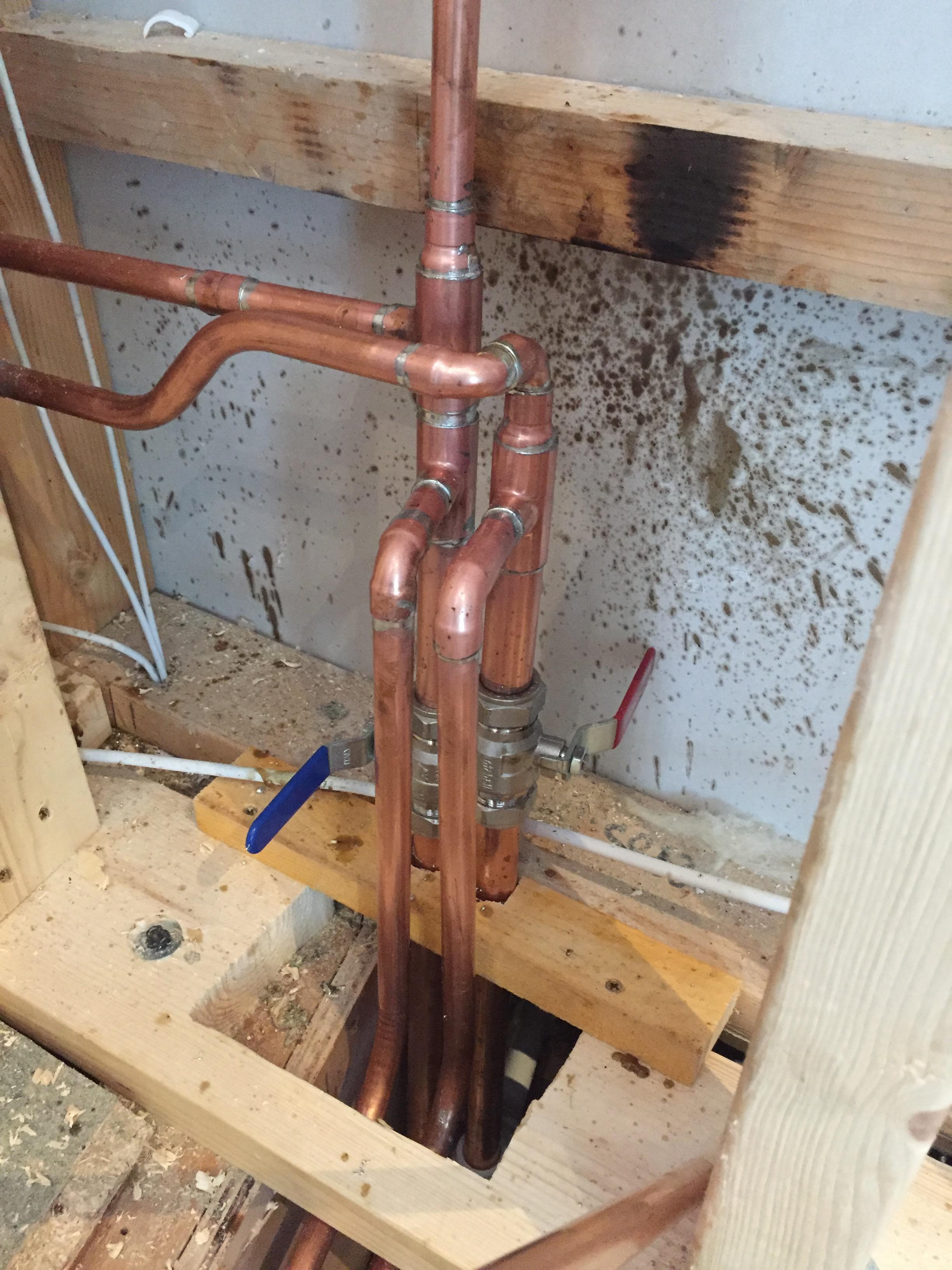

PeterW Posted July 8, 2017 Posted July 8, 2017 If it's speedfit pipe then can you not take a section out of it @Nickfromwales and stick a bit of copper in ..?? Would have thought it would heat up/ respond quicker ..? 1
Nickfromwales Posted July 8, 2017 Author Posted July 8, 2017 Its going down in that void. I can just about get the pipe stat springs on . The idea being if the thermistor fails the landing carpet is the other side and can be taken up to get to it in the next life. The white square is the SPEEDFIT pipe with the sun shining on it. 1
Onoff Posted July 8, 2017 Posted July 8, 2017 (edited) 36 minutes ago, Nickfromwales said: Its going down in that void. I can just about get the pipe stat springs on . The idea being if the thermistor fails the landing carpet is the other side and can be taken up to get to it in the next life. The white square is the SPEEDFIT pipe with the sun shining on it. So what are you going with now? The kit I linked and a UFH probe? I wonder if a Tenby would do as a clip? For repeats of this again I wonder if Ezybond clips would be nice and quick? I've them in 15 & 22, could send you a few. Thinking the UFH probe might be about the same dia as a stripped bond? Edited July 8, 2017 by Onoff
Nickfromwales Posted July 8, 2017 Author Posted July 8, 2017 I'm going with the UFH probe as they're nice and robust. Next time I'll not have this dropped in my lap so late in the job and it'll be a copper pipe . Ill order the PCB that you linked @Onoff as it's just a one trick pony. The eBay one seemed too complicated with its many buttons of tom-foolery and I'm not sure if it needs manual intervention after a power cut.

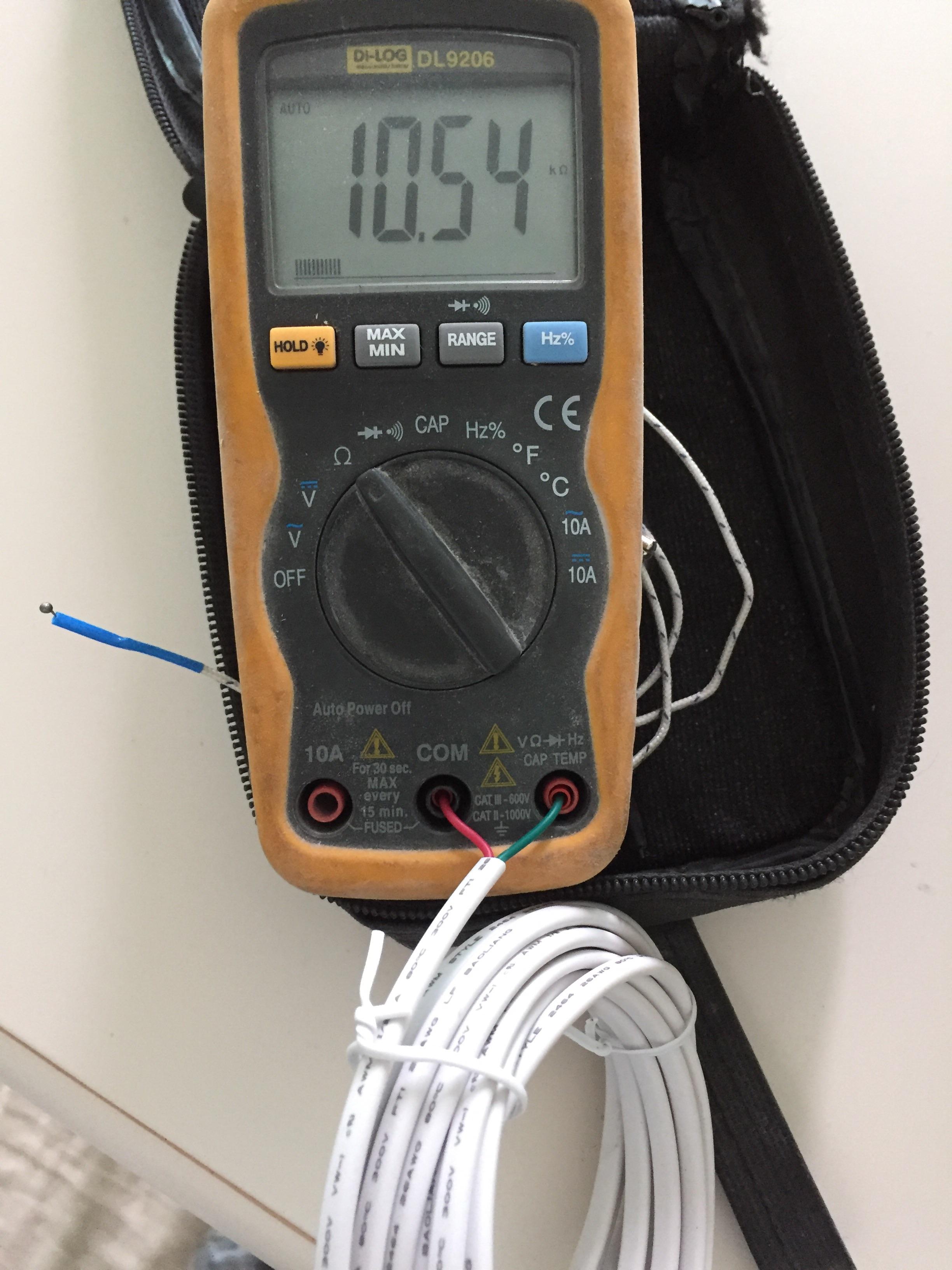

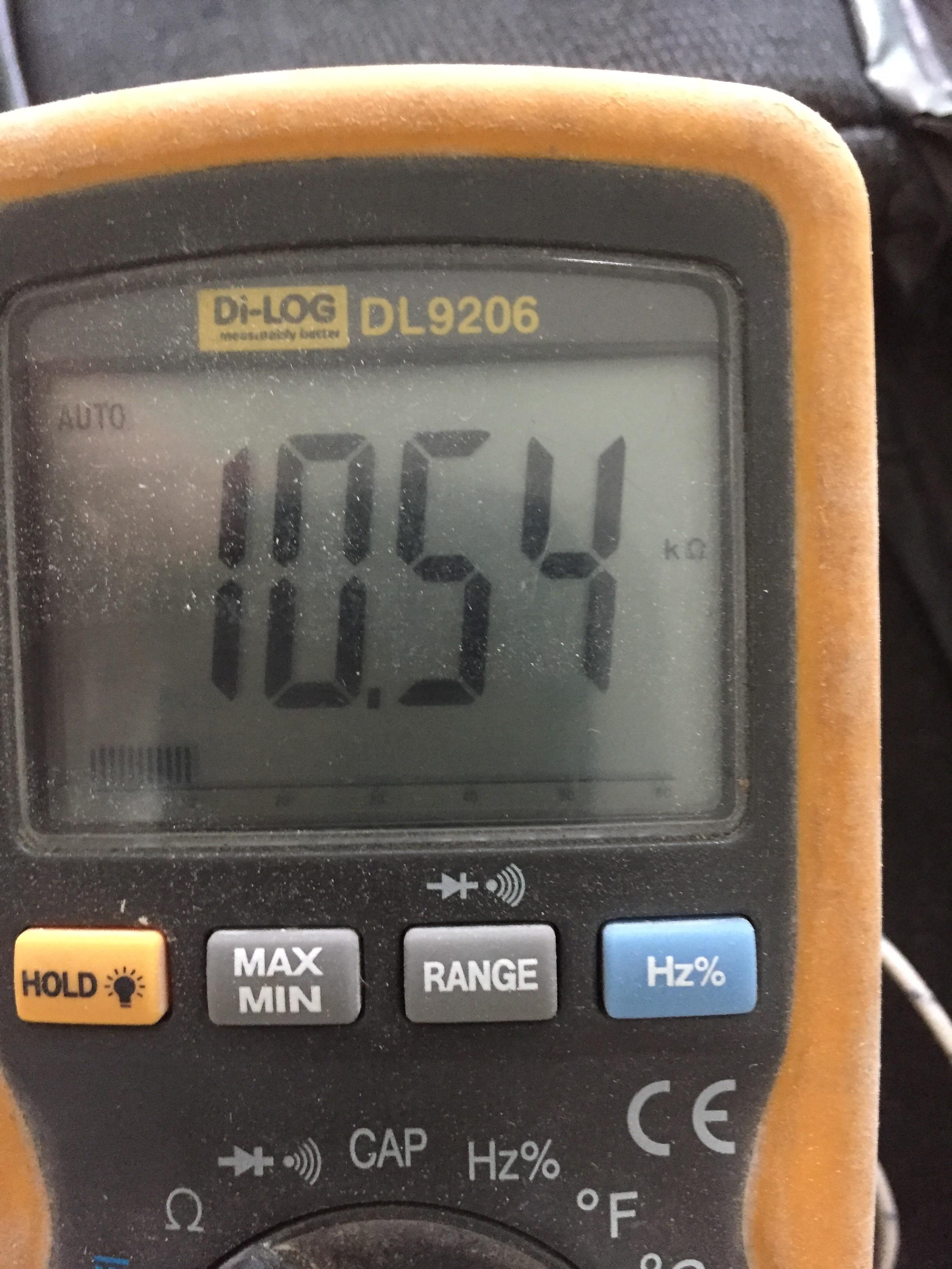

Nickfromwales Posted July 9, 2017 Author Posted July 9, 2017 Guess what I remembered I had a spare of in the back of the van this morning ? Bought 2 heat mats for a job ages ago and it came with a cheap controller so I shelved it in favour of a warmup 3ie. Multimeter time....fingers crossed. .
Nickfromwales Posted July 9, 2017 Author Posted July 9, 2017 Just ran it under hot water and resistance drops with heat. From 10k to around 3k.
Onoff Posted July 9, 2017 Posted July 9, 2017 11 minutes ago, Nickfromwales said: Just ran it under hot water and resistance drops with heat. From 10k to around 3k. Result! So it's deffo NTC and behaving as per the book: https://learn.adafruit.com/thermistor/testing-a-thermistor Don't forget you need to mount that Cebec module in something. 1G surface mount box? Grommets or small glands for in / out? 1
