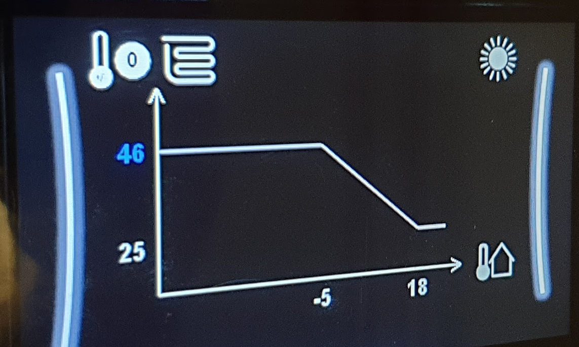

sirpatchuk Posted December 11, 2022 Share Posted December 11, 2022 Hi, I posted before about our ashp not getting up to temperature and it turns out a zone thermostat was in the wrong place. Now I would like advice on where to start with testing the settings. Granted, probably not the best time to test them with the current weather. Grant ASHP 17KW UFH downstairs (3 zones) 7 oversized radiators upstairs (all smart thermostats) We have a 1950s detached, 4 bed house in a village. No cavity wall insulation (but booked in to be done) Good loft insulation. - weather compensation on/off? - thermostats set high or temp we want to achieve? - we have two log burners… use them? Link to comment Share on other sites More sharing options...
sirpatchuk Posted December 11, 2022 Author Share Posted December 11, 2022 The minimum and maximum outside temperature for weather compensation what should these be? Link to comment Share on other sites More sharing options...
sirpatchuk Posted December 12, 2022 Author Share Posted December 12, 2022 I am thinking put the minimum and maximum flow rate at 35, turn weather compensation off and set the thermostats to 25. Then it will always be calling for heat and therefore be running constantly at the low flow rate. We can use the log burners in the evening for the extra heat… thoughts? Link to comment Share on other sites More sharing options...

Marvin Posted December 12, 2022 Share Posted December 12, 2022 9 hours ago, sirpatchuk said: The minimum and maximum outside temperature for weather compensation what should these be? Tricky. The minimum outside temperature we set ours at was -4 degrees centigrade (the coldest temp in the last few years where we are) and the heating water temperature 45 degrees centigrade The maximum outside temperature for our home is 10 degrees Centigrade and the heating water temperature 35 degrees Centigrade. These were based on estimates taken from our building thermal calculations spreadsheet. Link to comment Share on other sites More sharing options...

Ralph Posted December 12, 2022 Share Posted December 12, 2022 (edited) I think cold weather is probably the best time to try and set the weather compensation. I'm playing about with ours now. It's -7°C here and I have the Thermostat set to 23°C to act almost as a limiter and the weather compensation is set as below. It could be that the flow temp is a bit high so I'll bring it down over the next few days, depending on how it performs. Currently the house is at 22°C and I've burned 1KWh on heating since midnight. If I had a log burner it would be going when it's this cold for sure. Edited December 12, 2022 by Ralph 1 Link to comment Share on other sites More sharing options...
sirpatchuk Posted December 12, 2022 Author Share Posted December 12, 2022 14 minutes ago, Ralph said: I think cold weather is probably the best time to try and set the weather compensation. I'm playing about with ours now. It's -7°C here and I have the Thermostat set to 23°C to act almost as a limiter and the weather compensation is set as below. It could be that the flow temp is a bit high so I'll bring it down over the next few days, depending on how it performs. Currently the house is at 22°C and I've burned 1KWh on heating since midnight. If I had a log burner it would be going when it's this cold for sure. Wow, 1kw Link to comment Share on other sites More sharing options...
sirpatchuk Posted December 12, 2022 Author Share Posted December 12, 2022 17 minutes ago, crooksey said: My heatpump runs at 35-38 degrees normally, these last few days I upped it to 45 as 38 didnt give us enough heat for the rads (upstairs) but 38 was still plenty for the UFH. I turned off weather compensation as my lowest water heating flow temp is 35 degrees, which is fine all the time the outside air temp is above 0. But when it drops below, It takes me 10 seconds to increase it from my phone so more efficient to leave it off and run at the lowest flow temp I can. what have you got your thermostats set to? Are they always calling for heat? we have three zones downstairs for UFH and each room upstairs is it’s own zone with a thermostat radiator Link to comment Share on other sites More sharing options...
Ralph Posted December 12, 2022 Share Posted December 12, 2022 24 minutes ago, sirpatchuk said: Wow, 1kw I'm pretty sure that will get smashed in the next few hours and I'll be dropping the the flow temp to 40. Link to comment Share on other sites More sharing options...
