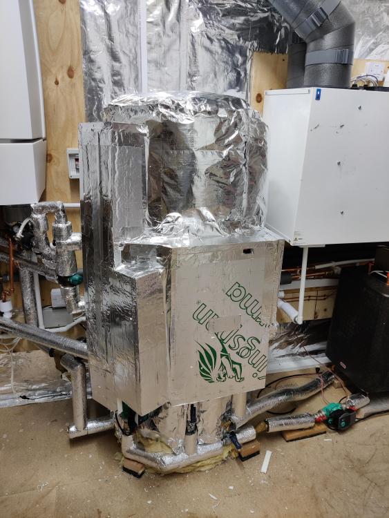

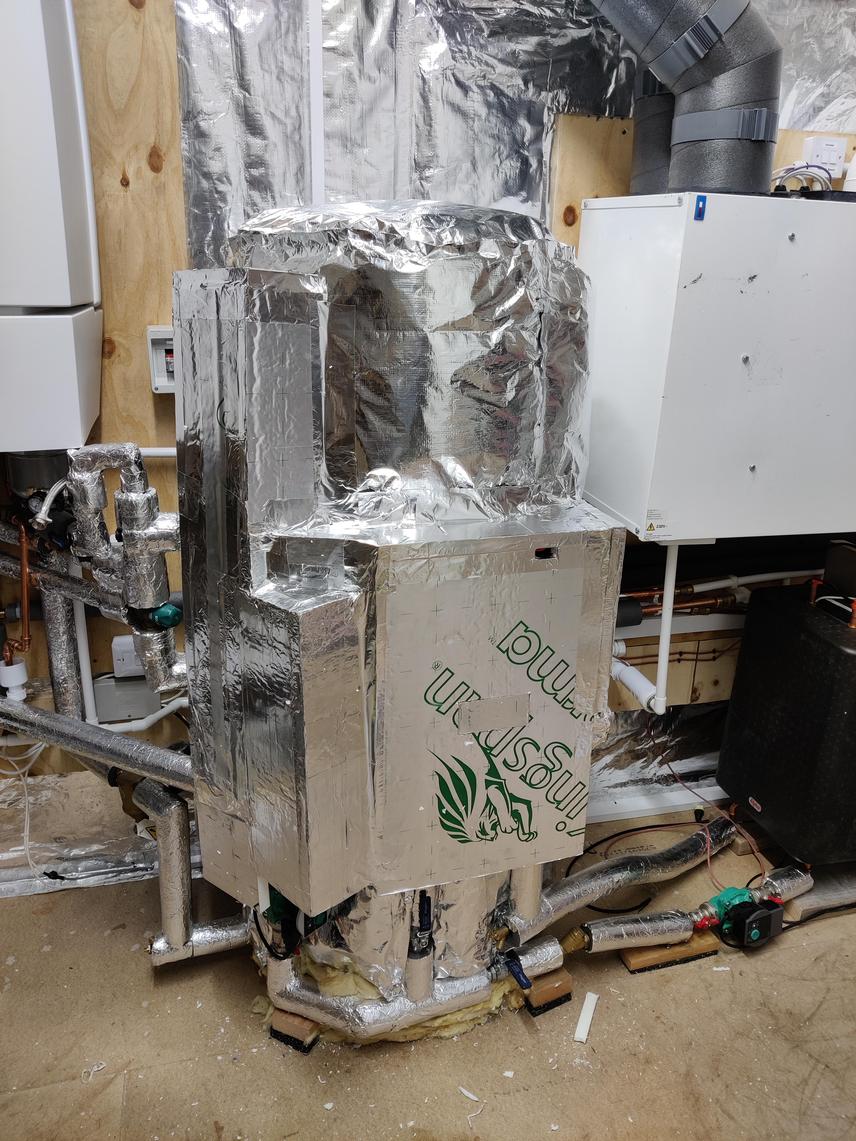

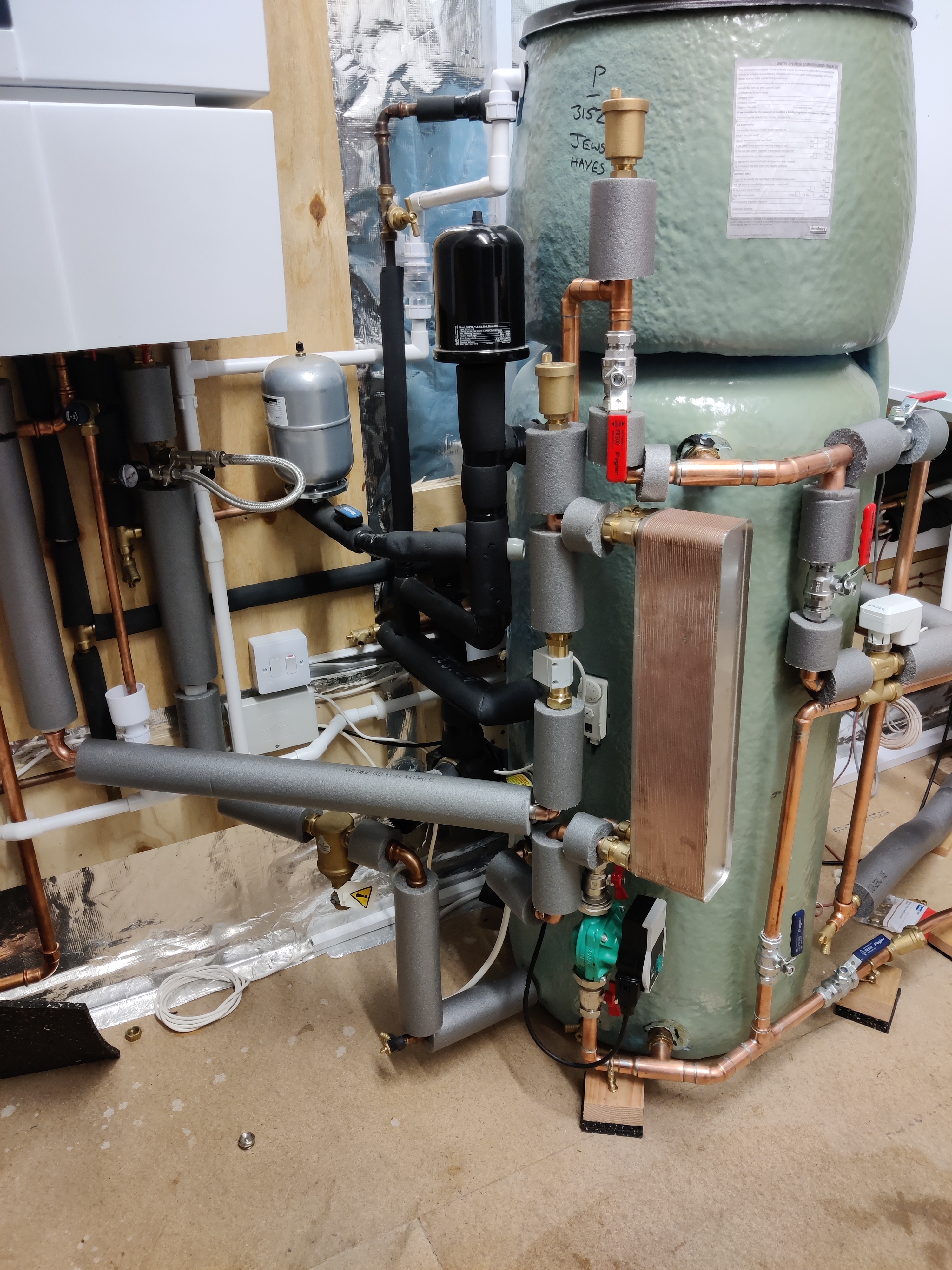

JohnMo Posted December 11, 2022 Posted December 11, 2022 I am actually using a combi thermal store, mainly because I got it new very cheap. It is indirect with a coil inside. The coil is way too small for low flow temps (designed 80 deg flow temp), so have added a large 40 plate PHE and pump. In the summer it is charged by excess PV and goes a long way to reducing DHW gas usage. Photo prior to and after insulation
