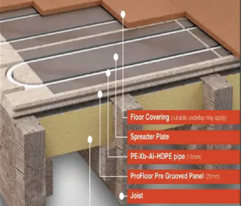

SanMan Posted December 11, 2022 Share Posted December 11, 2022 I have upstairs bedroom with UFH and it is struggling in this weather. Max room temp 18 degrees. The set up is: - suspended timber floor - ProFloor routered boards with spreader plates - Kahrs Tuplex underlay (recommended for UFH), then Kahrs engineered oak - subfloor void is insulated with loose fibreglass, avoiding downlights for room below, so somewhat gappy - room below is heated kitchen Yesterday, I removed a downlight and put my hand in the void. It felt very toasty. I could touch the underside of the ProFloor boards and these felt quite warm. So my suspicion is that the insulation is insufficient and I am losing a lot of heat downwards into the kitchen ceiling rather than into the room. Other info: - room has insulated cavity walls and new uPVC windows - bedroom ceiling void is insulated with 120 mm Celotex (cold loft above) The system settings are: - mixing valve set to 50 degrees - flow rate 1.4l/min - pump speed 3 - only circuit on manifold (70 m length pipe around the floor area of the room) - manifold only 3 m away from room, approximately 8 m between manifold and condensing gas boiler - all pipes to/from manifold lagged I was told by Building Control that insulation in internal floors between ground and first is not necessary, but as we are talking underfloor heating, I did it anyway. Well, I don’t think it is enough and I think it should have had 100mm rocksilk slabs or similar pushed right up against the underside of the ProFloor boards, to ensure heat travels upwards into the room and not downwards into the floor void. Yes, heat rises, but I think here it goes both ways. Thankfully, the ceiling below is due to come down and be reboarded/skimmed anyway as the downlights are all in the wrong place - so I can add the insulation from underneath. Can I have your views on this before commencing these works? Thank you. Link to comment Share on other sites More sharing options...
Olf Posted December 11, 2022 Share Posted December 11, 2022 10 hours ago, SanMan said: ProFloor routered boards with spreader plates This system seem to rely on good contact of spreader plate with the top of the pipe, if air gap is present you'll have only half of the pipe surface transferring heat, and that into the chipboard - not the best heat conductor. Anyway, it is what it is now. 10 hours ago, SanMan said: so I can add the insulation from underneath Definitely! The boards seem to receive heat from the pipes, by adding extra insulation you limit the flow downwards - so the only way is going to be up, where you want it. As a bonus improvement of acoustic properties. Of course that will reduce what the kitchen receives, will that be a problem? What is the temperature limit for the surface, are you able to increase flow temperature in that room? Link to comment Share on other sites More sharing options...
Nickfromwales Posted December 11, 2022 Share Posted December 11, 2022 This will be down to a lack of physical contact between the diffuser and the upper floor. I see this christ knows how many times. Did you witness this being installed, and do you know if the deck boards are sitting snugly against the UFH system? If there's even a couple of mm gap the results ( unless it was a passive style dwelling ) would be dramatically reduced. 1 Link to comment Share on other sites More sharing options...

SanMan Posted December 11, 2022 Author Share Posted December 11, 2022 Thank you @Nickfromwales. Yes, I saw it installed. The floor is Kahrs engineered floating on the spreader plates. Did not look like lack of contact - the fitter even screwed all the spreader plates down as they would otherwise have been a bit springy and that would have reduced contact. ProFloor don’t ask for this, but another well known manufacturer of the routered board/spreader plate system does. How do you overcome poor contact? ProFloor is sold as suitable for taking a floating engineered wood floor. Thank you. Link to comment Share on other sites More sharing options...

Nickfromwales Posted December 11, 2022 Share Posted December 11, 2022 (edited) 17 minutes ago, SanMan said: Thank you @Nickfromwales. Yes, I saw it installed. The floor is Kahrs engineered floating on the spreader plates. Did not look like lack of contact - the fitter even screwed all the spreader plates down as they would otherwise have been a bit springy and that would have reduced contact. ProFloor don’t ask for this, but another well known manufacturer of the routered board/spreader plate system does. How do you overcome poor contact? ProFloor is sold as suitable for taking a floating engineered wood floor. Thank you. Much higher flow temps. Problem being, is you’ll need to raise this incrementally in 2°C lifts until you’re at or around the max permitted temp stated by the flooring manufacturer. That’s usually 27°C. Beyond that, it’s failed by poor design / implementation. Edited December 11, 2022 by Nickfromwales Link to comment Share on other sites More sharing options...
SanMan Posted December 11, 2022 Author Share Posted December 11, 2022 21 minutes ago, Nickfromwales said: Much higher flow temps. Problem being, is you’ll need to raise this incrementally in 2°C lifts until you’re at or around the max permitted temp stated by the flooring manufacturer. That’s usually 27°C. Beyond that, it’s failed by poor design / implementation. Thanks. Flow temperature as in temperature selection at mixing valve? Doesn’t this just cause the limiting function to kick in sooner? Limit is set at 27 degrees. The mixing valve is presently set to 50 degrees, but I understand it can be increased to up to 55 for suspended timber floors, provided that you always have a working floor temp probe to protect the floor. I must admit it sounds like this spreader plate contact problem is an inherent drawback of this type of system because truly, I cannot see what could have been done differently. Thank you so much. Link to comment Share on other sites More sharing options...

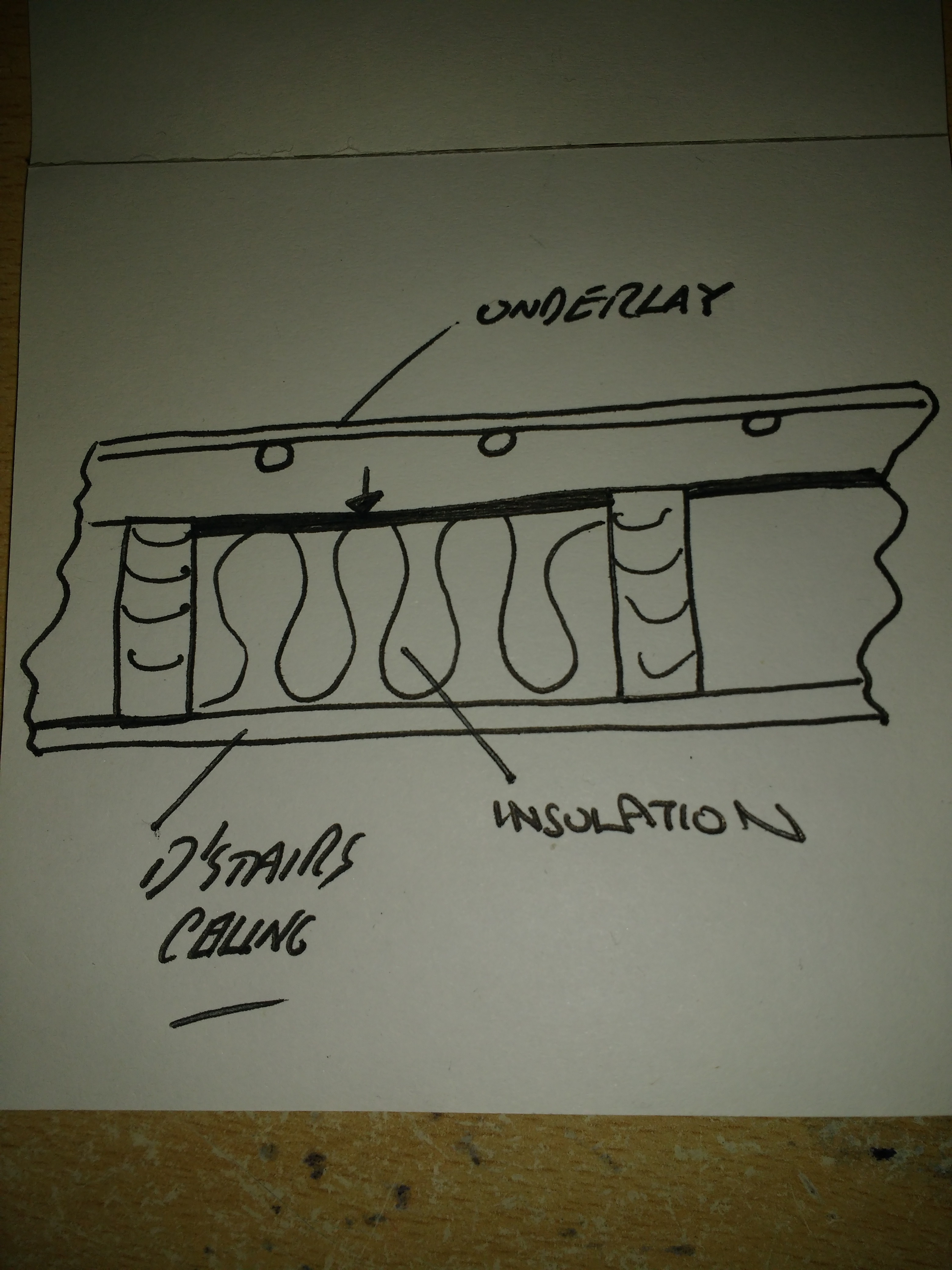

Onoff Posted December 12, 2022 Share Posted December 12, 2022 13 hours ago, Nickfromwales said: This will be down to a lack of physical contact between the diffuser and the upper floor. I see this christ knows how many times. Did you witness this being installed, and do you know if the deck boards are sitting snugly against the UFH system? If there's even a couple of mm gap the results ( unless it was a passive style dwelling ) would be dramatically reduced. So.....in the sketch below, if the black is the aluminium spreader, that has to be butt tight against the underside of the routed chipboard (where the arrow is)? Link to comment Share on other sites More sharing options...

SanMan Posted December 12, 2022 Author Share Posted December 12, 2022 5 minutes ago, Onoff said: So.....in the sketch below, if the black is the aluminium spreader, that has to be butt tight against the underside of the routed chipboard (where the arrow is)? Thank you for the reply. The layers are actually like this (starting from the bottom up - some insulation, routered chipboard, spreader plates, thin Tuplex underlay, Kahrs oak engineered flooring). In other words, the spreader plates are on top of/bedded into the routered chipboard, not the other way round. I attach a photo. The thing I am missing from that photo is a slab of insulation. My question is will adding insulation make much difference, given there is a heated room below. The floor joists are 200 mm tall, so the void is quite spacious. There is some insulation there, but only loose full fibreglass. And if I add insulation slabs, should they be pushed right up against the chipboard. And should they be foil face up? Thank you. 😊 Link to comment Share on other sites More sharing options...

Marvin Posted December 12, 2022 Share Posted December 12, 2022 Yes heat travelling down through chipboard or up through chipboard, underlay and floor covering... If the thermal resistance of these layers is more that the insulation below, and the underside of the routered chipboard is not touching all over the insulation below, then I think lots of heat will go down. Yes Celotex or similar underneath (touching the routered chipboard) is best. Another thing that can cause problems is if the joist ends are not sealed into cavity walls properly and the insulation below has a gap between that and the routered chipboard allowing air to flow... Link to comment Share on other sites More sharing options...
Marvin Posted December 12, 2022 Share Posted December 12, 2022 10 minutes ago, SanMan said: Thank you. Yes, that is a good picture, but my set up is like this…. Notice in the diagram the Insulation is fixed up tight to the underside of the floor makeup Link to comment Share on other sites More sharing options...
SanMan Posted December 12, 2022 Author Share Posted December 12, 2022 4 minutes ago, Marvin said: Yes heat travelling down through chipboard or up through chipboard, underlay and floor covering... If the thermal resistance of these layers is more that the insulation below, and the underside of the routered chipboard is not touching all over the insulation below, then I think lots of heat will go down. Yes Celotex or similar underneath (touching the routered chipboard) is best. Another thing that can cause problems is if the joist ends are not sealed into cavity walls properly and the insulation below has a gap between that and the routered chipboard allowing air to flow... That is really helpful. Thank you for your advice. 😊 Link to comment Share on other sites More sharing options...
SanMan Posted December 12, 2022 Author Share Posted December 12, 2022 3 minutes ago, Marvin said: Notice in the diagram the Insulation is fixed up tight to the underside of the floor makeup Yes. I was wondering if that is ok. No need for air gap? I guess that would defeat the object, having read your other reply. Thank you. Link to comment Share on other sites More sharing options...
Onoff Posted December 12, 2022 Share Posted December 12, 2022 It's very easy to install Celotex wrong. How you cut, i.e how square can have a major impact in how tight it fits against the joist. One way of near guaranteeing at least one side is tight to the joist is to cut 5mm under width. Hold in place with some nails then gun foam the hell out of the gap. 1 Link to comment Share on other sites More sharing options...
SanMan Posted December 12, 2022 Author Share Posted December 12, 2022 2 minutes ago, SanMan said: Yes. I was wondering if that is ok. No need for air gap? I guess that would defeat the object, having read your other reply. Thank you. And how do you feel about 100 mm Rocksilk? Much easier to fit than Celotex. And would it need to be foil faced like the Celotex? Thank you. Link to comment Share on other sites More sharing options...
SanMan Posted December 12, 2022 Author Share Posted December 12, 2022 Just now, Onoff said: It's very easy to install Celotex wrong. How you cut, i.e how square can have a major impact in how tight it fits against the joist. One way of near guaranteeing at least one side is tight to the joist is to cut 5mm under width. Hold in place with some nails then gun foam the hell out of the gap. Yes. I read one article once where they said cut it 5 mm LARGER to ensure a good fit. 🤔 The problem is the joists are tapered/uneven in themselves and using foam when working in a ceiling against gravity is no fun. So I thought 100 mm Rocksilk will solve s multitude of fitting issues and that can easily be oversized and will still stay in. Link to comment Share on other sites More sharing options...
SanMan Posted December 12, 2022 Author Share Posted December 12, 2022 Just now, SanMan said: Yes. I read one article once where they said cut it 5 mm LARGER to ensure a good fit. 🤔 The problem is the joists are slightly tapered/uneven due to their age in both directions and using foam when working in a ceiling against gravity is no fun. So I thought 100 mm Rocksilk will solve s multitude of fitting issues and that can easily be oversized and will still stay in. Link to comment Share on other sites More sharing options...
