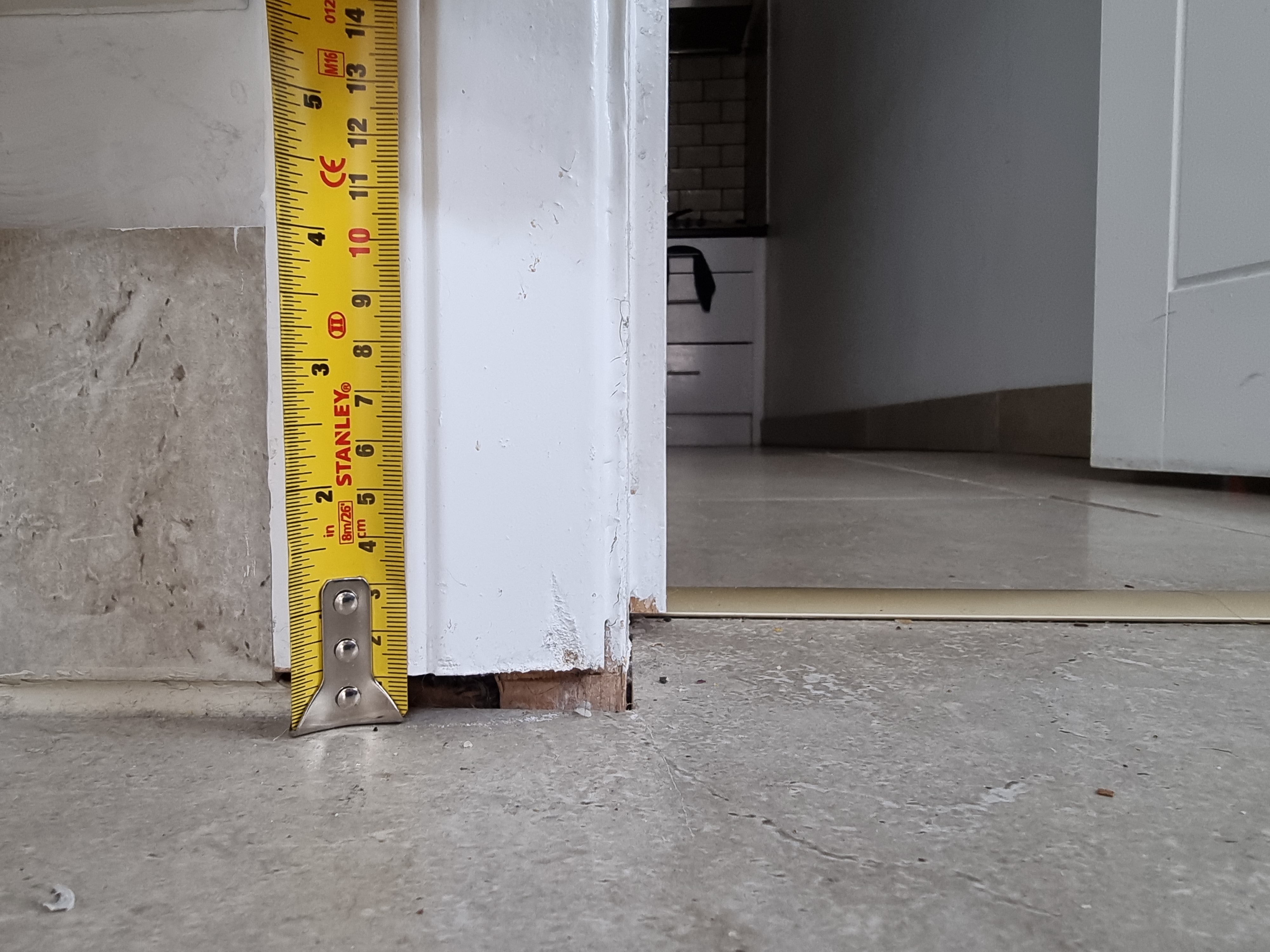

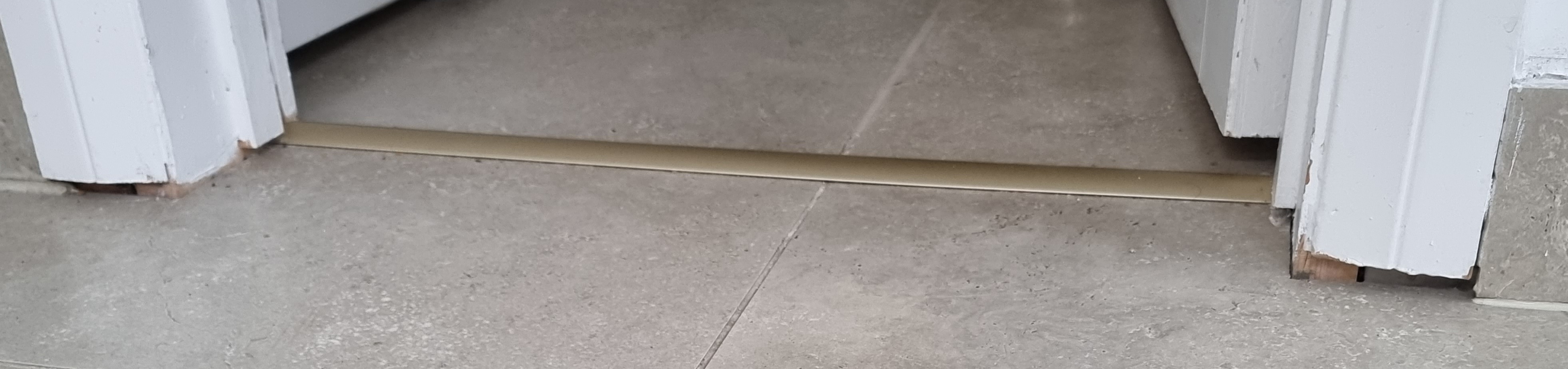

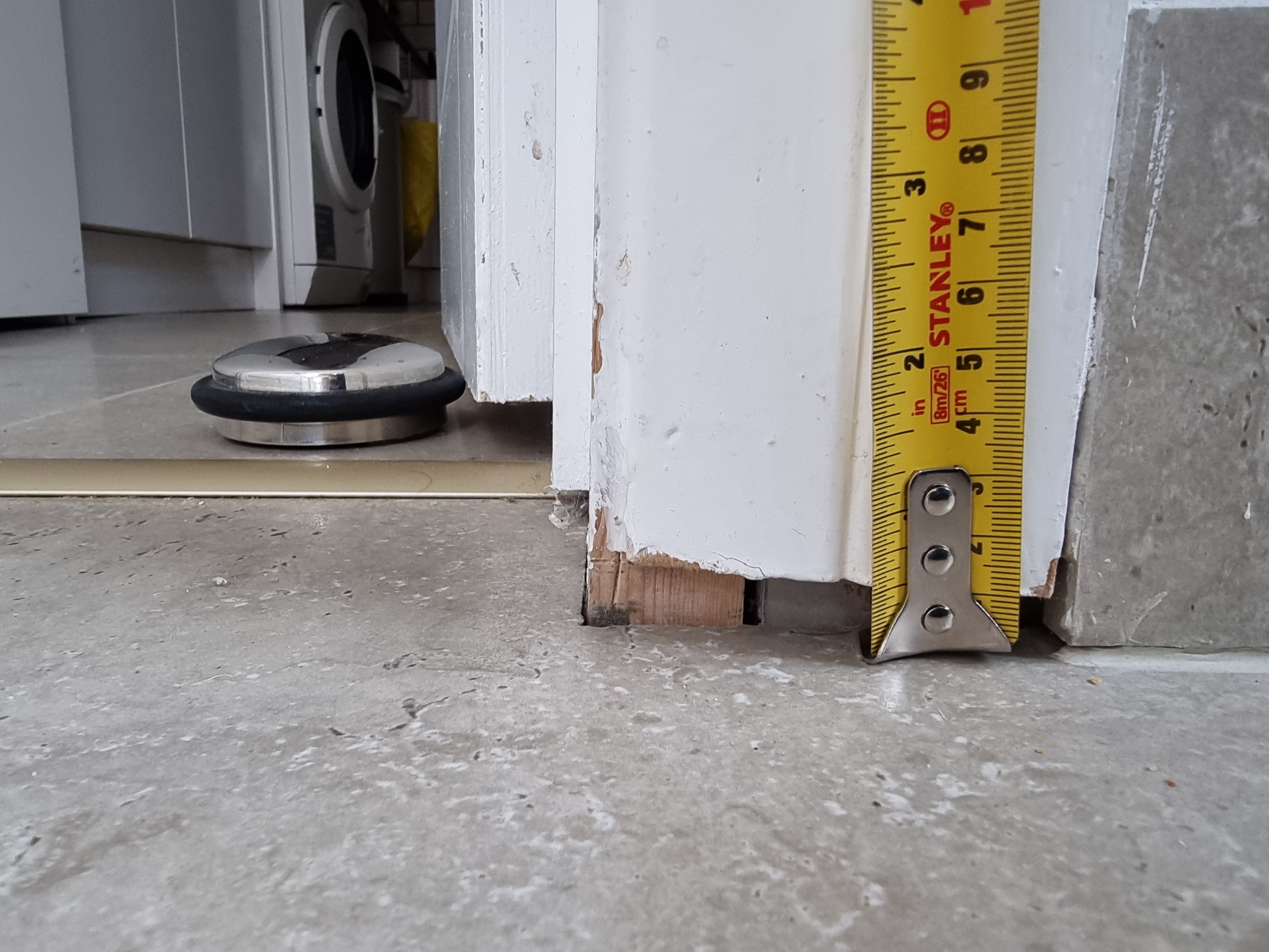

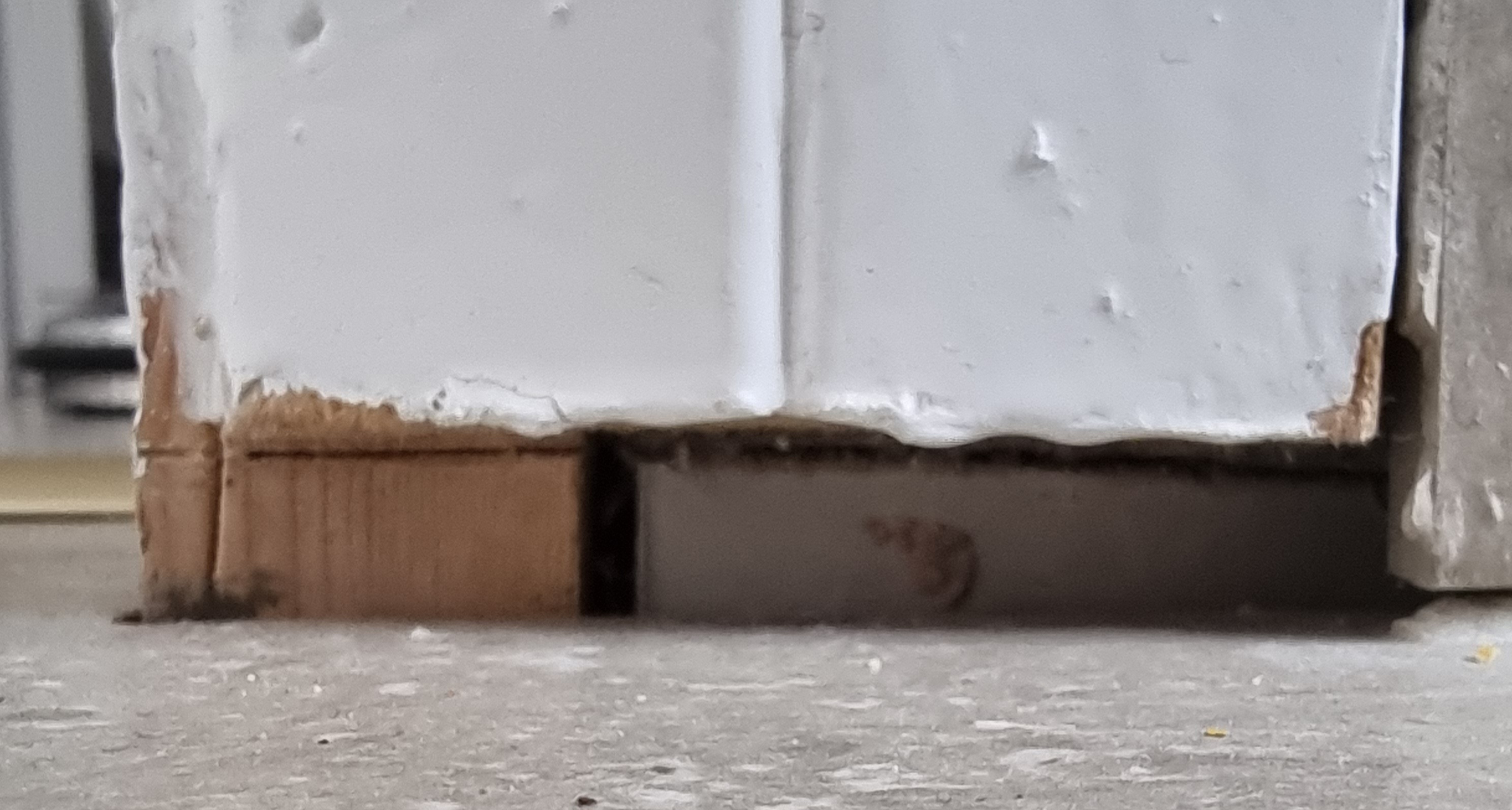

newbie282 Posted December 6, 2022 Posted December 6, 2022 Hi, Want any help / advice on how to fix this eyesore! There is a bit of gap between door frame & tiled floor. The floor has underfloor heating BTW. How can I fix this? I'm a complete newbie to DIY world. Is it easily done ? Thanks !
Russell griffiths Posted December 6, 2022 Posted December 6, 2022 If you want a moody bodge then fill it with a timber filler and paint it. If you want a nice job then remove the architrave and fit 3 new bits flat to the floor.
ProDave Posted December 6, 2022 Posted December 6, 2022 Suggest the person that cut them off too short comes back to correct his mistake?
newbie282 Posted December 6, 2022 Author Posted December 6, 2022 Thanks for your responses. Wish I could get him to sort it ! But that's another story.... I have never used expanding foam before. Could I use expanding foam to fill the gap & paint over it? Or is the gap too small for it?
