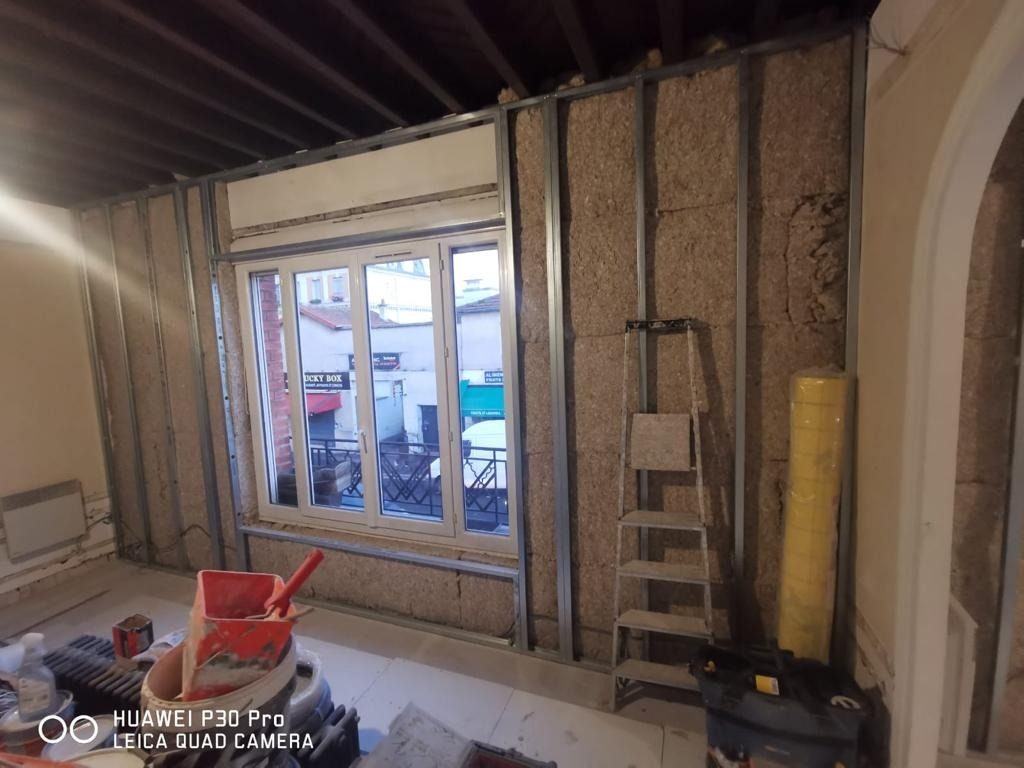

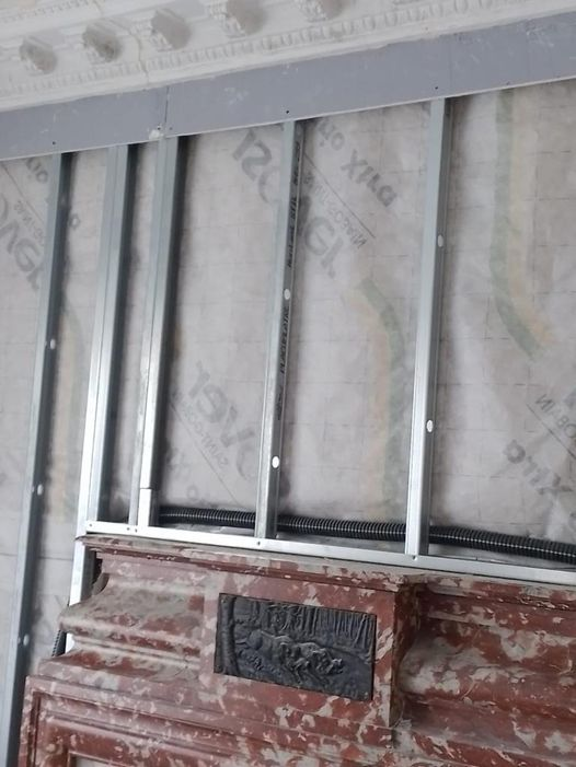

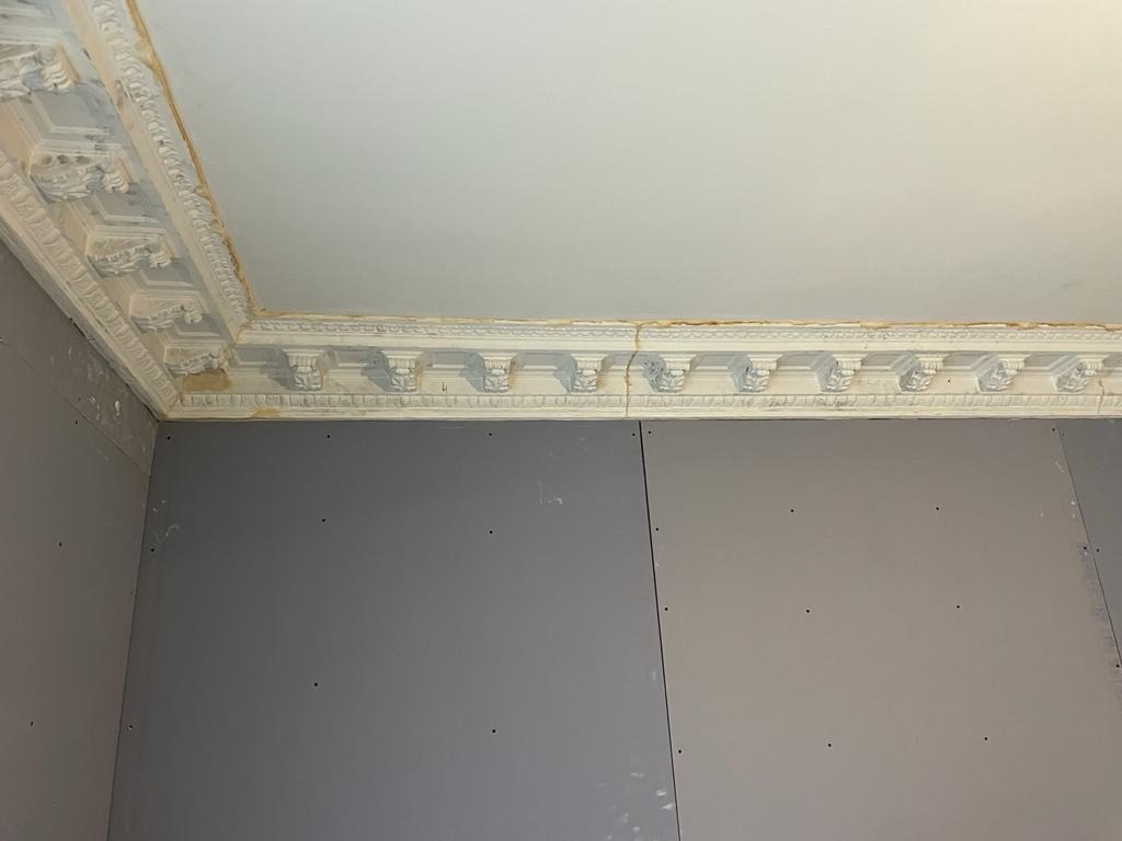

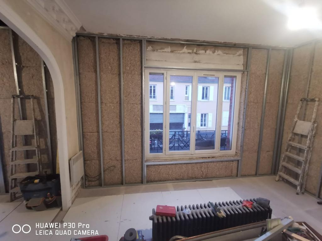

Garald Posted November 29, 2022 Share Posted November 29, 2022 This is just a visual update for people who are following my insulation saga. As you know, we are insulating the streetside wall with a good thick layer of cellulose-based insulation (cotton/linen/hemp). Of course I mean: insulating material, air, fireproof panel. I think this duct is for the stereo speaker cable: I didn't know one could simply remove the decorative mouldings and then reattach them, but that's what the workers have just managed to do. Does it all look good? Any comments? 1 Link to comment Share on other sites More sharing options...

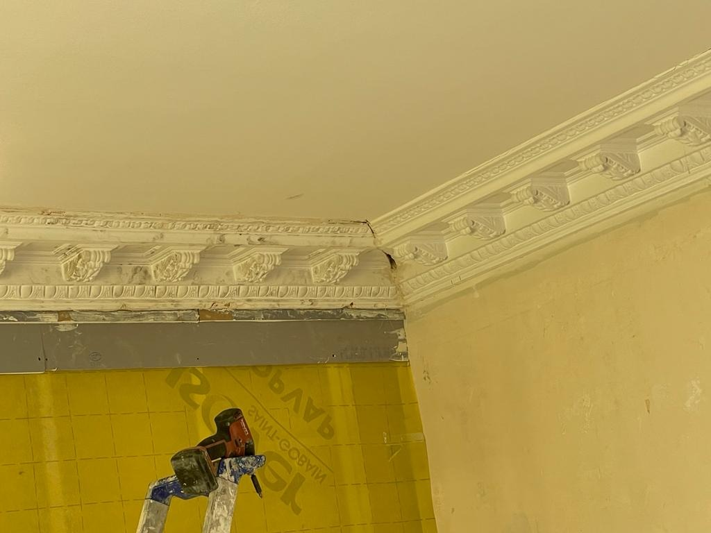

Mr Punter Posted November 29, 2022 Share Posted November 29, 2022 Yes good progress. When I have used coving adhesive I noticed it goes off quite hard so it is better to wipe off any excess with a wet sponge before it dries than to leave it to "others" to sort out later. Link to comment Share on other sites More sharing options...
Garald Posted November 29, 2022 Author Share Posted November 29, 2022 Well, I hope the workers doing this know that - or do you see spots of adhesive on surfaces that won't be covered up later? Link to comment Share on other sites More sharing options...
jayc89 Posted November 29, 2022 Share Posted November 29, 2022 Is that Thermafleece NatraHemp or similar? Link to comment Share on other sites More sharing options...
Garald Posted November 29, 2022 Author Share Posted November 29, 2022 8 minutes ago, jayc89 said: Is that Thermafleece NatraHemp or similar? It's BioFib Trio - no idea whether it is similar (as I don't know NatraHemp). Link to comment Share on other sites More sharing options...
jayc89 Posted November 29, 2022 Share Posted November 29, 2022 2 minutes ago, Garald said: It's BioFib Trio - no idea whether it is similar (as I don't know NatraHemp). https://www.thermafleece.com/product/thermafleece-natrahemp It doesn't look a million miles off. Is the insulation using the metal framing to hold it up, or are there additional fixings too? Would love to know how they got your cornice down in one piece! Link to comment Share on other sites More sharing options...
Garald Posted November 29, 2022 Author Share Posted November 29, 2022 3 minutes ago, jayc89 said: https://www.thermafleece.com/product/thermafleece-natrahemp It doesn't look a million miles off. Is the insulation using the metal framing to hold it up, or are there additional fixings too? I imagine it's there in part to hold the insulation up and in part so that one can set the fire-barrier panels against, well, something. What additional fixings? > Would love to know how they got your cornice down in one piece! I know! Polish contractor magic! 1 Link to comment Share on other sites More sharing options...

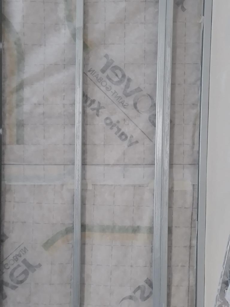

jayc89 Posted November 29, 2022 Share Posted November 29, 2022 What's the deal with the membrane detail? It looks like some is behind the MF and some is on top of it? I realise all my questions might come across like the Spanish Inquisition. I'm generally interested as Internal Wall Insulation is next on my list of jobs to tackle. Link to comment Share on other sites More sharing options...
Garald Posted November 29, 2022 Author Share Posted November 29, 2022 3 minutes ago, jayc89 said: What's the deal with the membrane detail? It looks like some is behind the MF and some is on top of it? I realise all my questions might come across like the Spanish Inquisition. I'm generally interested as Internal Wall Insulation is next on my list of jobs to tackle. I *want* to summon the Spanish inquisition - that's why I post here. But what do you mean by MF, and for that matter by membrane detail? Sorry, newbie here. Link to comment Share on other sites More sharing options...

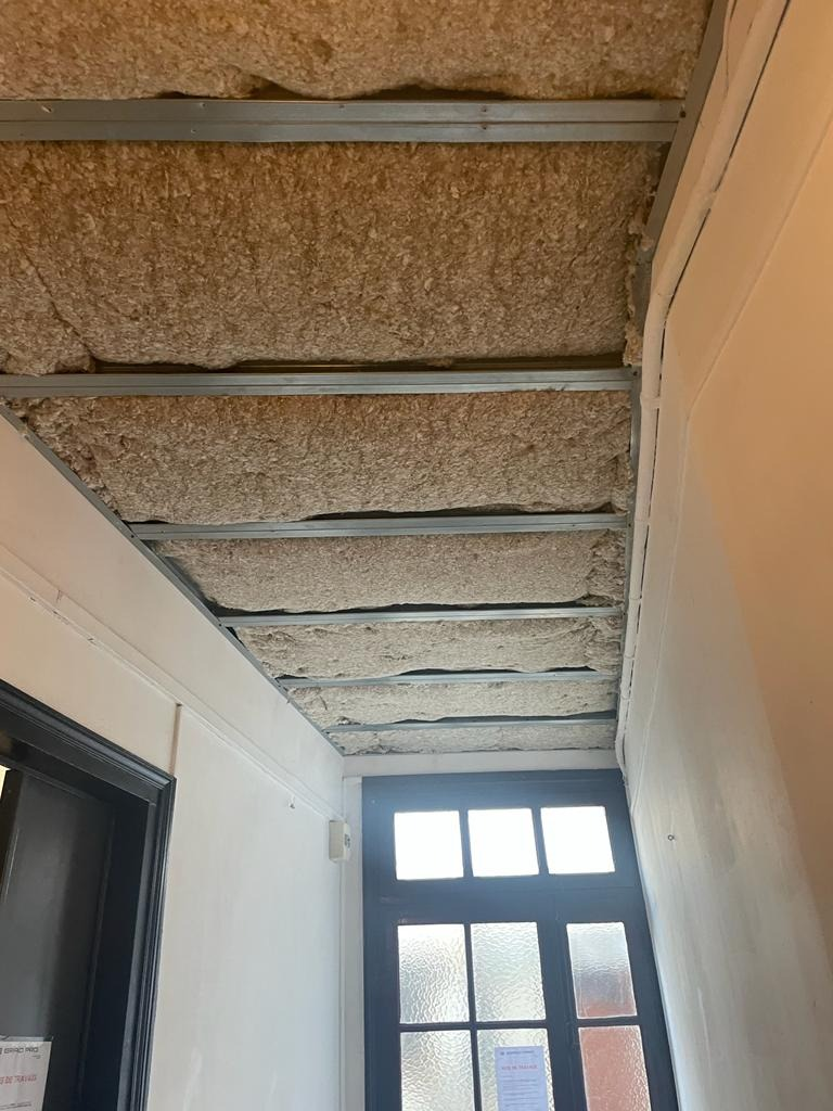

Garald Posted November 29, 2022 Author Share Posted November 29, 2022 More pictures! Insulating the coop's corridor's ceiling (because my kitchen is on top of it). Does it look all right? Link to comment Share on other sites More sharing options...
Garald Posted November 29, 2022 Author Share Posted November 29, 2022 2 hours ago, jayc89 said: Would love to know how they got your cornice down in one piece! Well, it looks like several pieces, but all in all very neatly. Link to comment Share on other sites More sharing options...
Garald Posted November 29, 2022 Author Share Posted November 29, 2022 (edited) 2 hours ago, jayc89 said: What's the deal with the membrane detail? It looks like some is behind the MF and some is on top of it? Ah, you mean that there is some membrane behind the metal frames and some membrane on top of it? Where should it be? (Maybe I am seeing order in chaos, but: I think the wall where the membrane goes on top is an internal wall - would that be an adequate explanation? Does it make a difference?) Edited November 29, 2022 by Garald Link to comment Share on other sites More sharing options...
jayc89 Posted November 30, 2022 Share Posted November 30, 2022 10 hours ago, Garald said: Ah, you mean that there is some membrane behind the metal frames and some membrane on top of it? Where should it be? (Maybe I am seeing order in chaos, but: I think the wall where the membrane goes on top is an internal wall - would that be an adequate explanation? Does it make a difference?) Yeah, exactly. Some is behind and some is in front of the metal frame. Presumably the one behind is on the external wall, so acting as a breather membrane (i.e. not allowing wind to directly reach the insulation), and I'd assume the one in front is an AVCL (Airtight Vapour Control Layer) but I'm not sure why that would only be needed on internal walls. Link to comment Share on other sites More sharing options...
Garald Posted December 5, 2022 Author Share Posted December 5, 2022 On 30/11/2022 at 08:40, jayc89 said: Yeah, exactly. Some is behind and some is in front of the metal frame. Presumably the one behind is on the external wall, so acting as a breather membrane (i.e. not allowing wind to directly reach the insulation), and I'd assume the one in front is an AVCL (Airtight Vapour Control Layer) but I'm not sure why that would only be needed on internal walls. Not sure either. What I do know is that one of the side external walls is humid (presumably because the neighbor has a beautiful garden with, sigh, creeping vines) so we have to be extra careful there. That's the wall with the chimney (working chimney, btw - we are assuming that, since it is a massive stone chimney, it will still be safe to use). Link to comment Share on other sites More sharing options...
