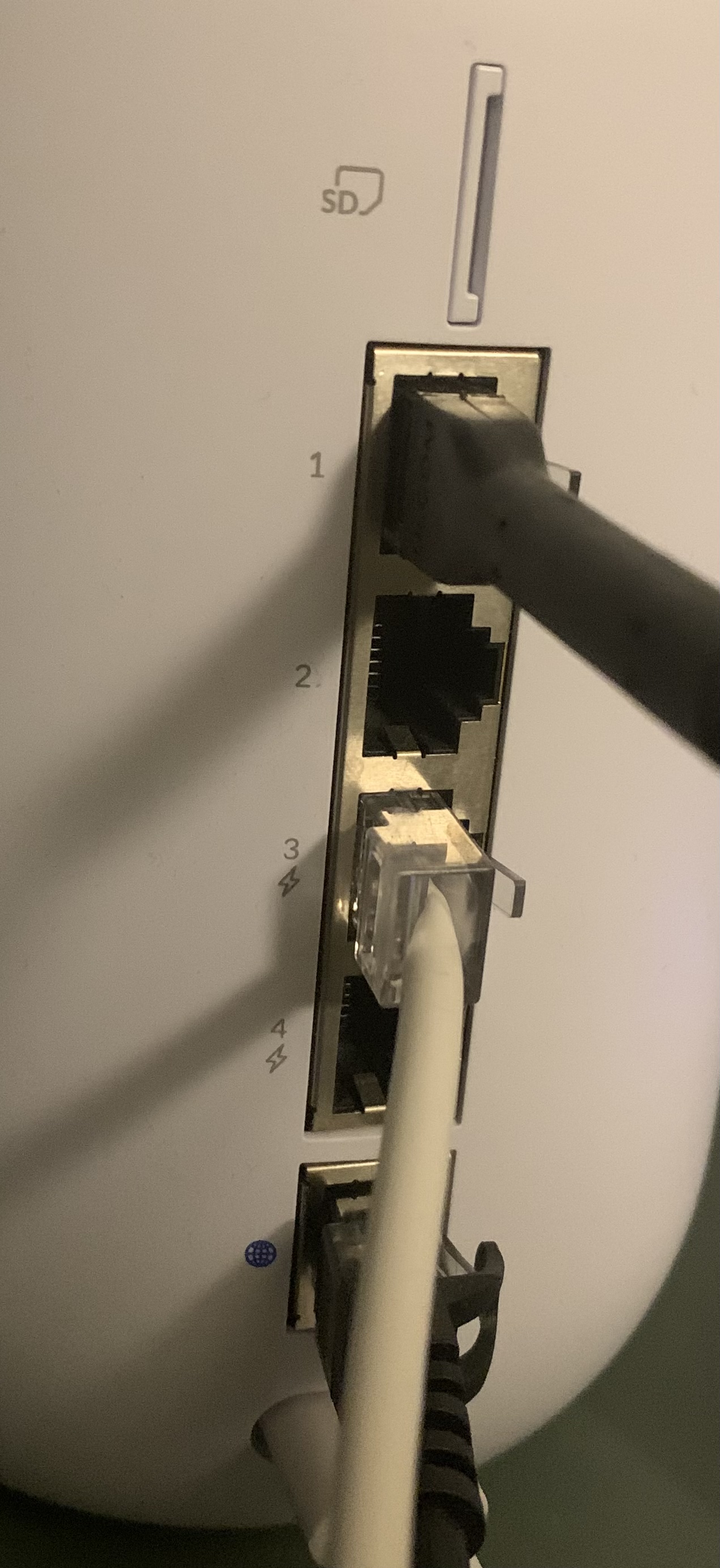

Adsibob Posted November 28, 2022 Author Posted November 28, 2022 10 minutes ago, MrMagic said: As far as I can see the dream machine doesn’t have PoE..do you mean the pro version? I’m sure you are right. But then what do the little lightning symbols mean on ports 3 and 4 of my dream machine?
MrMagic Posted November 28, 2022 Posted November 28, 2022 Ah ha. It means you have a dream router rather than a dream machine (ubiquiti having fun with naming 🤦♂️) Anyway, those ports are proper 48v PoE ports and will power the ring doorbell and/or the netgear switch. I’m afraid they won’t power the 24v nano switch.
Adsibob Posted November 28, 2022 Author Posted November 28, 2022 11 minutes ago, MrMagic said: Ah ha. It means you have a dream router rather than a dream machine (ubiquiti having fun with naming 🤦♂️) Anyway, those ports are proper 48v PoE ports and will power the ring doorbell and/or the netgear switch. I’m afraid they won’t power the 24v nano switch. So I have an issue I need to solve. The Cat 6 cable goes from my UD Router to a place where I need to split it into two cables, one fork to connect up to my iMac, the other fork to go to my bring PoE doorbell. I think I need a PoE switch, right?
MrMagic Posted November 29, 2022 Posted November 29, 2022 Yes exactly that. If you have power at the point at where you wish to ‘split’ then any powered PoE switch should do. if you don’t have power at that point then you’ll need a PoE powered switch with PoE pass through (like the netgear) (PoE in the above is referring to standard 802.3ae/af type 48v PoE, not the ubiquiti proprietary 24v ‘passive PoE’……thanks for confusing everyone Ubiquiti)
