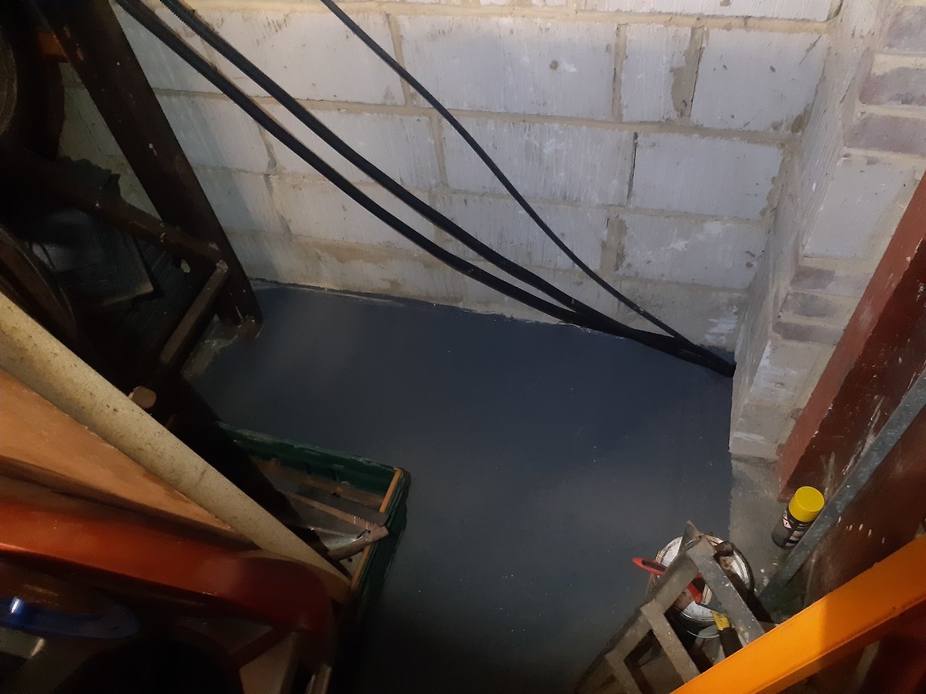

Onoff Posted November 24, 2022 Share Posted November 24, 2022 1 hour ago, Dan F said: both armoured and standard twin+earth would be impossible to work with in a conduit anyway. This is a 2.5mm2 SWA and 2 20mm conduits all inside another circa 60dia conduit. Link to comment Share on other sites More sharing options...
Dan F Posted November 24, 2022 Author Share Posted November 24, 2022 15 minutes ago, Onoff said: This is a 2.5mm2 SWA and 2 20mm conduits all inside another circa 60dia conduit. I meant impossible to work with in a 20mm conduit. I have 100mm conduit from the house to front drive, but then it's only a 20mm conduit from a pit to the controls box on the gate post. Unless I just skip the 20mm conduit and throw the armoured cable in the trench under gate threshold alongside the 20mm ducts with control cables. Link to comment Share on other sites More sharing options...

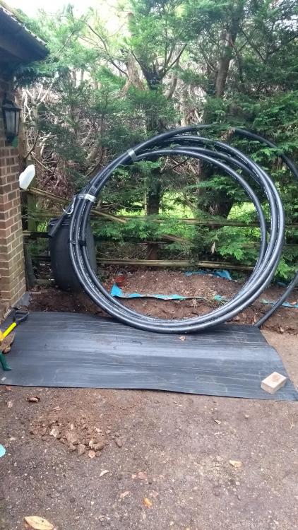

Onoff Posted November 25, 2022 Share Posted November 25, 2022 17 minutes ago, Dave Jones said: use sewer pipe will never have a snag pulling cable through. that crap 63mm ducting is terrible stuff. Not this stuff, proper DNO stuff and smoothbore. I think I paid a tenner for this: 1 Link to comment Share on other sites More sharing options...
Dave Jones Posted November 26, 2022 Share Posted November 26, 2022 18 hours ago, Onoff said: Not this stuff, proper DNO stuff and smoothbore. I think I paid a tenner for this: good stuff, hatefull to get in the ground! Link to comment Share on other sites More sharing options...
Dan F Posted November 26, 2022 Author Share Posted November 26, 2022 I got this stuff in the end https://www.tlc-direct.co.uk/Main_Index/Cable_Index/NYY/index.html. Not armoured but it's all ducted anyway. Link to comment Share on other sites More sharing options...
Onoff Posted November 26, 2022 Share Posted November 26, 2022 5 hours ago, Dave Jones said: good stuff, hatefull to get in the ground! Indeed I felt like Jennifer Lopez in Anaconda! Worst bit was getting it up through the hole I drilled in the concrete, had to drag it up with an electric engine hoist. Tbh I often feel like Jennifer Lopez... Link to comment Share on other sites More sharing options...
