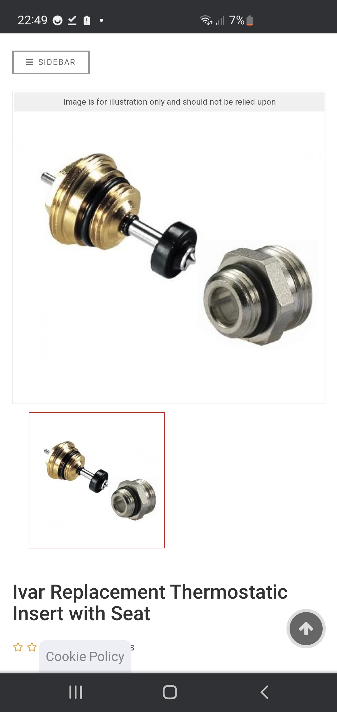

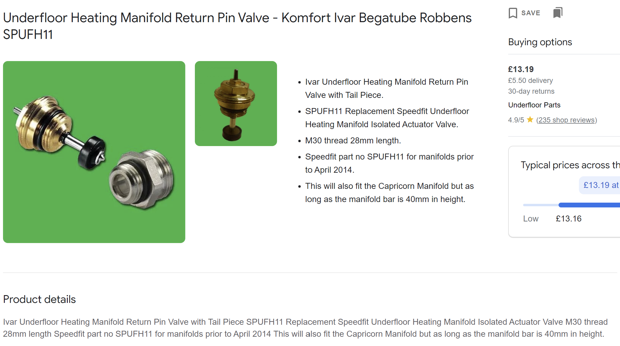

Nickfromwales Posted December 11, 2022 Share Posted December 11, 2022 I've just been called to a clients build where the Ivar blending valve is not letting the toasty hot water in the flow pipe to it, through to the loops ( even with the white TRV style head removed from the mixing valve. I drained down and removed the cartridge and it was firmly stuck, but in the fully open position!! I serviced the valve, proving free movement and that the pin returned to its "sticky-outy" position ( returned to that position by the spring ) and reinstalled it all. Set it to work, and fark all, still just a steady 20oC of heat which was keeping the dwelling at too low a temp. This setup has the ASHP pumping into a LLH and that is immediately adjacent to the UFH manifold / pump etc, so never needed a secondary pump to get from the LLH to the manifold. Conclusion, possible knackered mixing valve. I'm going to order a brand new one and install it as this is an inconvenience to my client, but this worked very well the first 2 winters, and I'm flummoxed as to why this has given up the ghost ( where others have been in elsewhere, longer, and are still working perfectly!?! Some houses I've fitted with 2x Ivar manifolds and still zero issues on those projects....... Could this be a few stray "Friday afternoon" valves perhaps? Link to comment Share on other sites More sharing options...
LA3222 Posted December 12, 2022 Author Share Posted December 12, 2022 On 11/12/2022 at 19:20, Nickfromwales said: Could this be a few stray "Friday afternoon" valves perhaps? Certainly looks that way! Is this the badger?: Link to comment Share on other sites More sharing options...
Nickfromwales Posted December 13, 2022 Share Posted December 13, 2022 10 hours ago, LA3222 said: Certainly looks that way! Is this the badger?: Looks different to the one I removed, but may be un upgraded replacement part? Link to comment Share on other sites More sharing options...
Nickfromwales Posted December 13, 2022 Share Posted December 13, 2022 2 minutes ago, Nickfromwales said: Looks different to the one I removed, but may be un upgraded replacement part? 👎 Prior to 2014?? Link to comment Share on other sites More sharing options...
LA3222 Posted December 13, 2022 Author Share Posted December 13, 2022 48 minutes ago, Nickfromwales said: 👎 Prior to 2014?? Rog - didn't notice that bit! Link to comment Share on other sites More sharing options...
