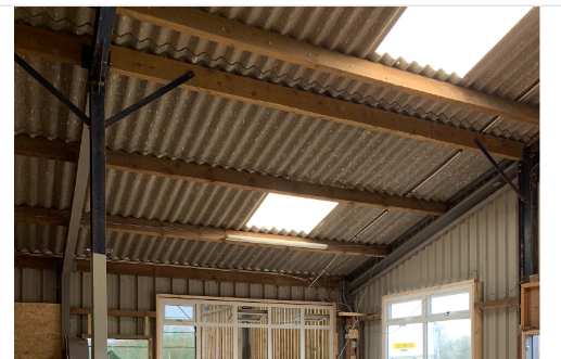

The outer skin passes the column here and is probably more than your allowable thickness. but not much.
I wonder if anyone knows how much or little constitutes complying?
And is there a dimension recorded at the planners?
If it is a problem then is it possible to shave off the necessary amount of eps, and inset the blocks?
OR inset the whole wall to line up with your permitted building line,  and then overlay the gap at the column with PIR to the available thickness.

  On 03/12/2022 at 17:24, saveasteading said:
As there is wall cladding then that would define the available outer limit. so you have 20mm or more to play with, if anyone is measuring that closely.
But then what if you drop a string line from the edge of the roof  sheeting, does that give extra width?
Even if you could only squeeze in 20mm PIR outside the columns, that will do enough, and can be made up for in other ways (discuss later if this works in principle)
I do not agree for a moment that you should leave the rafters and purlins exposed, if that is what the above suggestion is. It would need heavy protection and would be , let's say, quirky. It works in the Mediterranean but not here.
Are the purlins  (pedantic corner here...purlins are only on the roof, the walls have wall rails (or girts  in American and some of Europe))
yes, are the purlins set on top of the rafters or inset?
What do you plan for the wall construction?
You will be stripping the wall and roof cladding. Has anyone already measured the existing dimensions?
This is all worth many thousands to you, so any more photos or sketches may be worthwhile.
Expand
Really interested to hear more on your builds sound sliek you have lots of experience on different projects with this. It really depend on how the LPA feel and see it. In my area they are really against any class Q and are renowned for being difficult, so the project is really in their hands. If we get class Q ( which we tick all the boxes to say we should) then we'll apply for for planning to try and take the advise from all of you guys to knock down and start again. We really don't want anything different, the current footprint works fine, it's just a build method around the steel portal. which is really undecided still
I like the idea of ICF, but it would need new foundations  so full planning, just trying to look at backs options, no one has actually measured the barn yet another that the architects rough dims. part of me wants to try and add to the structure before it measured so we can squeeze som insulation and structure in as well as eth steel cladding.... it all seems like ridiculous class Q game, just to try and make the building energy efficient without losing footprint
Purlins are set onto the steel portal frame (rafters?) and the fibre cement boards are fixed to the purlins (excuse me if the wording isn't correct

Have you checked if the fibre-cement is asbestos free? It looks as if it is modern enough to be polypropylene not asbestos.
If so, it doesn't have to come off and you can build above it for insulation and weather (IF allowed for height) and below for appearance.
