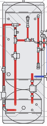

Kustom Posted November 16, 2022 Share Posted November 16, 2022 (edited) Hello all, First time post. Weve just downside and bought a small 1960's bungalow, which is currently heated by a gas combi boiler. There are only two of us most of the time, so a 5 bed house was deemed unnecessary in the current climate. Were due to have Solar PV and a battery storage installed (Currently on hold due to part availability) We would like to dump any excess solar into a hot water tank. As there is currently a combi boiler fitted there is no hot water tank but we have a space for one in an airing cupboard. Plan 1 was to install ASHP but the house plumbing is the wonderful microbore system so would require re plumbing throughout to achieve the require flow rates plus potentially bigger radiators so that idea was parked. Plan 2 was to get a Mixergy cylinder, but this would only help with the DHW and a couple of plumbers have said that its not really suitable for being fed by a combi. Plan 3 Was to use excess solar to heat the tank to pre-heat water before going into the boiler, I like this idea but unfortunately the old combi (2006ish British gas / Worcester) is not able to accept pre-heated water. So after some reading around on this forum I think I need some advice on a plan 4. New gas boiler (combi or system?) New tank (Two immersions, two coils, does it need a buffer tank) Eddi to deal with the diversion Any help would be greatly appreciated. Edited November 16, 2022 by Kustom Link to comment Share on other sites More sharing options...

Kustom Posted November 16, 2022 Author Share Posted November 16, 2022 @TonyT Thank you for the reply, we will be having a hybrid inverter and battery fitted when givenergy gen 2 inverters are available. @JohnMo Thank you for your schematic, I think I understand what's going on but I have a couple of questions What is AVV is short for? some kind of relief valve? Also what the the circular/dot connections on the tank in the Heating diagram? Is the buffer built into the tank like this Telford one? or separate. Would you mind telling me where your tank came from? Thank you Link to comment Share on other sites More sharing options...
JohnMo Posted November 16, 2022 Share Posted November 16, 2022 AVV - automatic vent valve Dot connectors are the connections on the thermal store - these tap in the inhibited fluid in the cylinder. Its just a 160L vented thermal store, with a indirect heating coil (supplemented with a large plate heat exchanger) and DHW coil. DHW water does not enter cylinder directly goes through a coil. Link to comment Share on other sites More sharing options...
