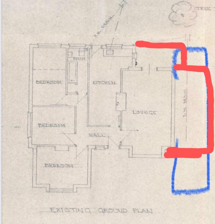

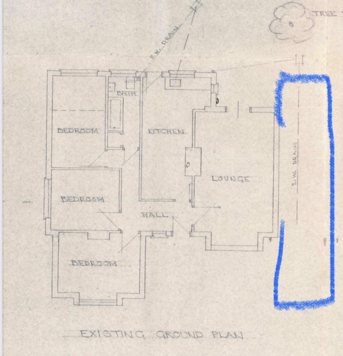

Mahak Posted November 10, 2022 Share Posted November 10, 2022 My original building has different length on the sides. I want to get side extensions. Can I build half the width of original house on the side marked in blue? Or it must be on the original side? Link to comment Share on other sites More sharing options...
ProDave Posted November 10, 2022 Share Posted November 10, 2022 Which is original house footprint and which is a previous extension? Link to comment Share on other sites More sharing options...
Mahak Posted November 10, 2022 Author Share Posted November 10, 2022 Everything on the drawing is original house. It was then extended 3m at the rear. Link to comment Share on other sites More sharing options...

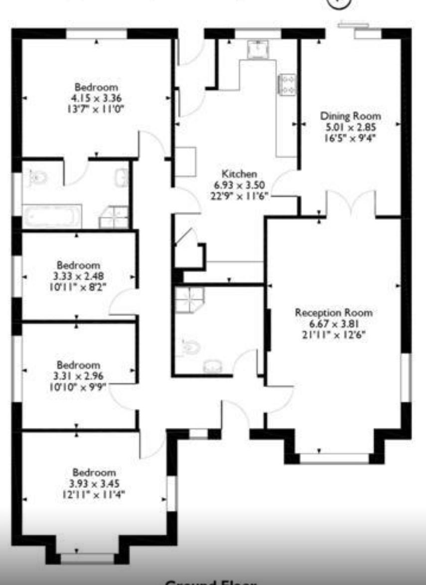

Mahak Posted November 10, 2022 Author Share Posted November 10, 2022 (edited) This is after rear extension Edited November 10, 2022 by Mahak Link to comment Share on other sites More sharing options...

bassanclan Posted November 11, 2022 Share Posted November 11, 2022 Your blue line is not permitted development. As the area in blue is shown as standalone and some come forward from the lounge. Given your existing extensions, it would be permitted if it didn't come forward of the lounge and was no wider than half of (25'1" -9'4"= 15'9") approx width of original kitchen+bathroom+bedroom - dining room. - essentially 7'10" Alternatively the extension flush with the lounge, front and back could be 1/2 the width of the original house, so would be stepped Link to comment Share on other sites More sharing options...

DevilDamo Posted November 22, 2022 Share Posted November 22, 2022 On 11/11/2022 at 07:32, bassanclan said: Your blue line is not permitted development. As the area in blue is shown as standalone and some come forward from the lounge. Given your existing extensions, it would be permitted if it didn't come forward of the lounge and was no wider than half of (25'1" -9'4"= 15'9") approx width of original kitchen+bathroom+bedroom - dining room. - essentially 7'10" Alternatively the extension flush with the lounge, front and back could be 1/2 the width of the original house, so would be stepped It may just be the rough drawing. Extending off the side of the bay wouldn’t be PD as it would project forward of the principal line. It would need to come off the main wall line, which appears to be approx. 600mm back. Link to comment Share on other sites More sharing options...
