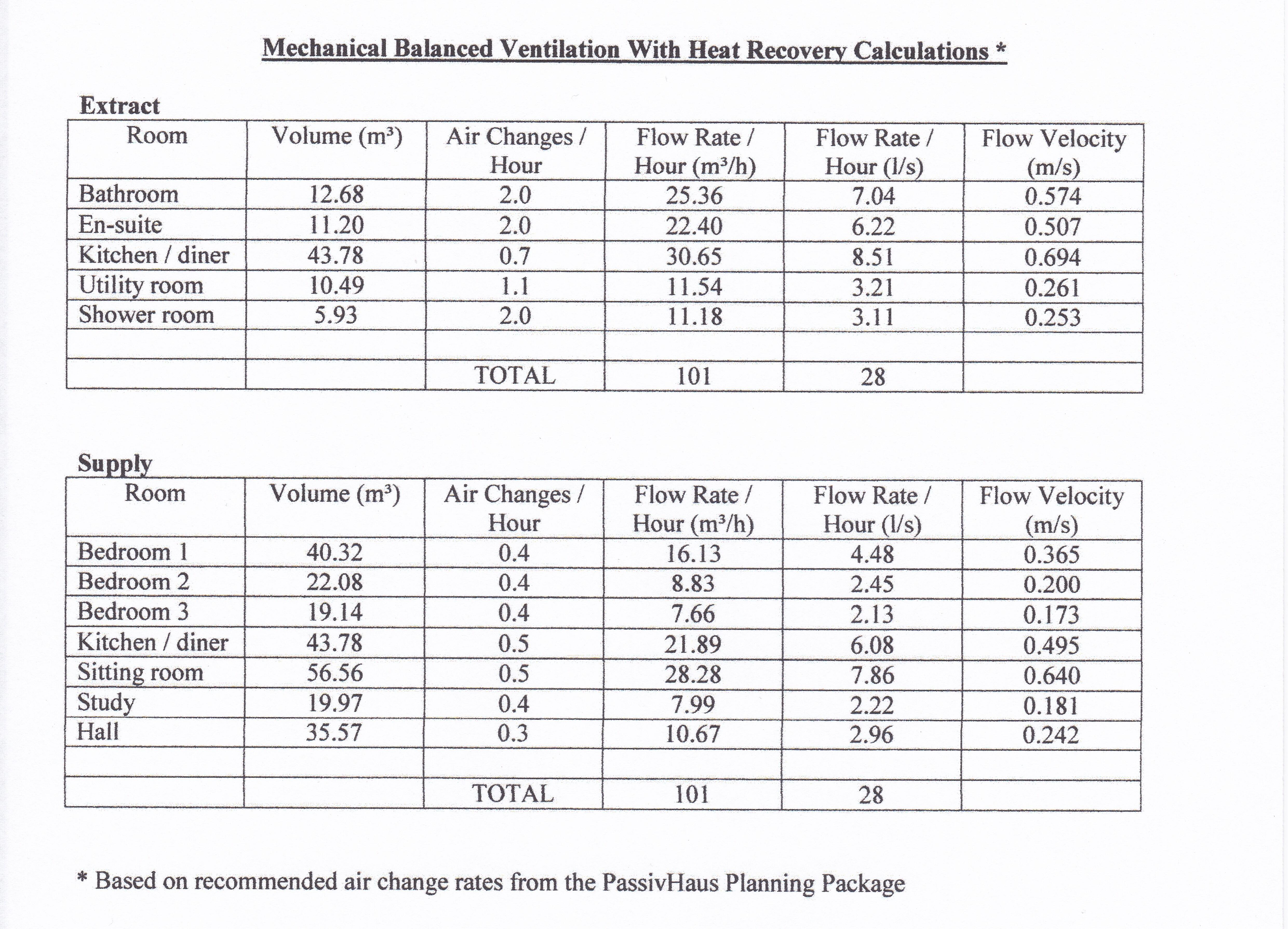

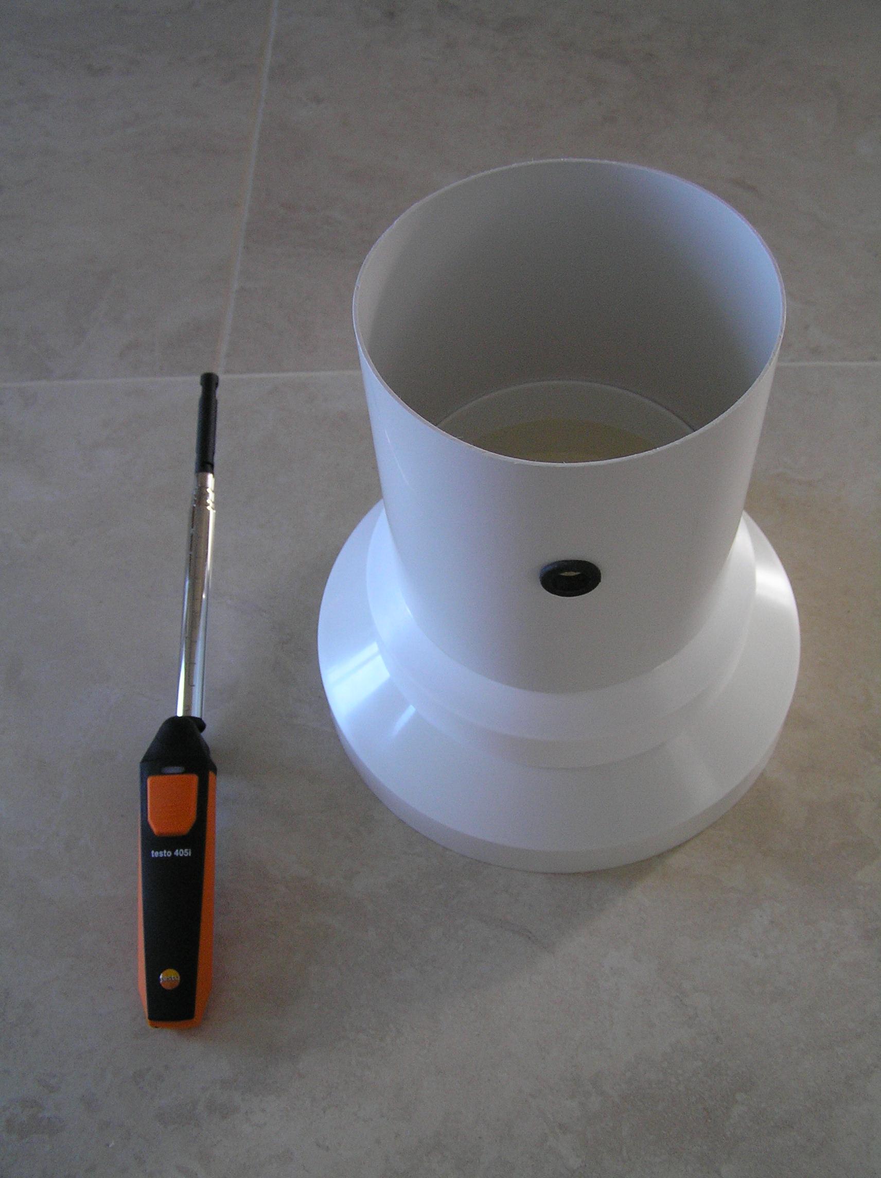

Gone West Posted November 9, 2022 Posted November 9, 2022 I bought a Testo 405i and made a cone. https://www.test-meter.co.uk/testo-405i-bluetooth-thermal-anemometer These are the results. I just made a table. 2

cwr Posted December 5, 2022 Posted December 5, 2022 On 09/11/2022 at 08:40, Gone West said: I bought a Testo 405i and made a cone. https://www.test-meter.co.uk/testo-405i-bluetooth-thermal-anemometer These are the results. I just made a table. I'm intrigued by this, did it work well and cope with low velocities/air flows?
JohnMo Posted December 5, 2022 Posted December 5, 2022 I made a similar one. Then had someone with certified equipment come and 'official' commission so I got a test cert with calibrated equipment certificate. He remarked how close the initial setting were compared to final, I think one terminal was slightly adjusted. So works well.
Gone West Posted December 5, 2022 Posted December 5, 2022 3 hours ago, cwr said: I'm intrigued by this, did it work well and cope with low velocities/air flows? Yes it worked well. It sends the reading via bluetooth to an app on the phone and then I printed them out. It's just time consuming going round every vent and then repeating the process until it's all balanced.
Tims Posted December 5, 2022 Posted December 5, 2022 You've just saved me question on making exactly the same test funnel with some leftover plenum pipe @Gone West. I've got an RS components hotwire bluetooth anometer on order from Ebay (£10.95 including postage and packing) that looks like it came from a bankruptcy auction of a contractors kit (has an asset number sticker on it). Hopefully all that is wrong with it is a missing battery compartment cover 🤞. I'll be happy to lend it to people if it works when I've finished my initial set up (though that's a while off yet). If it doesn't work how do you go about going on the waiting list for the forum one? 1
MikeSharp01 Posted December 5, 2022 Posted December 5, 2022 On 09/11/2022 at 08:40, Gone West said: hese are the results. I just made a table. How did you get away with less than the part F 4 ACH for the extract rooms?
Gone West Posted December 5, 2022 Posted December 5, 2022 1 hour ago, MikeSharp01 said: How did you get away with less than the part F 4 ACH for the extract rooms? I did it twice, once for SAP and then the real settings for PH, which is what we kept. The BCO wasn't interested in the SAP results, so for me it was a waste of time.
