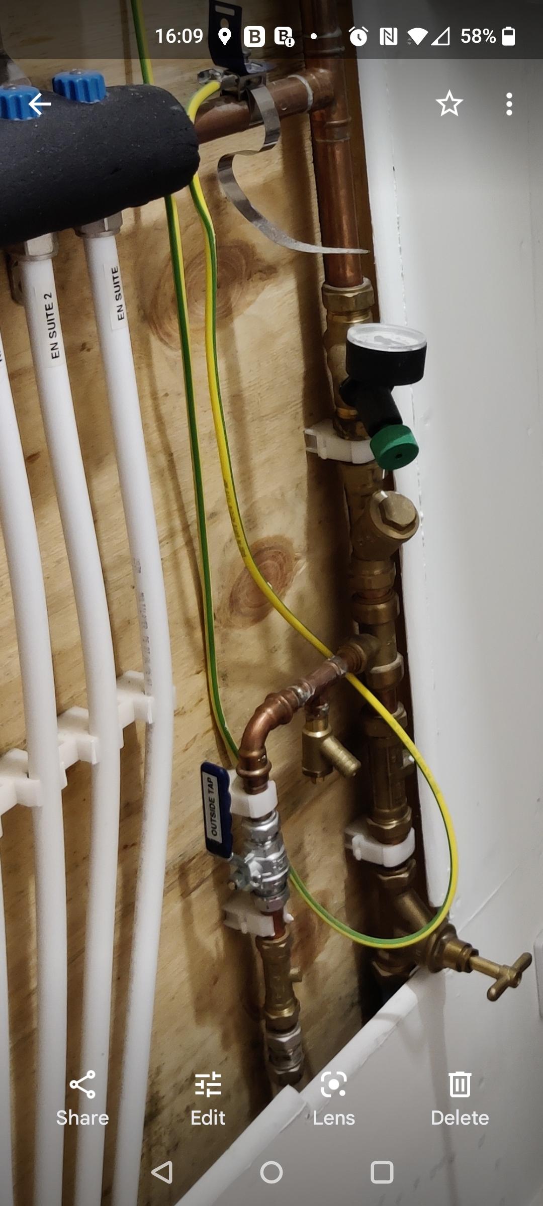

JackofAll Posted November 8, 2022 Author Share Posted November 8, 2022 56 minutes ago, JohnMo said: I put the cold below the insulation and used a plumbing manifold in a central point. Used Pert-Al- Pert pipes in conduit,so the can be removed as per building regs. Didn't do hot in floor, but would do that within the insulation, as above. Where did your pipes run from manifold John, in floor or through ceiling? 1 Link to comment Share on other sites More sharing options...
JohnMo Posted November 8, 2022 Share Posted November 8, 2022 Cold ran down from Manifold, under the floor, then up at the point where the sink was going to be. Photos of stop cock and cold manifold. Plant room is in an upstairs loft section, so main water goes there also. Other photo you can see various white pipes coming up at the outside walls. Hot pipes are in the ceiling and drop down. Walls were all battened to form service gap the plasterboarded 1 1 Link to comment Share on other sites More sharing options...

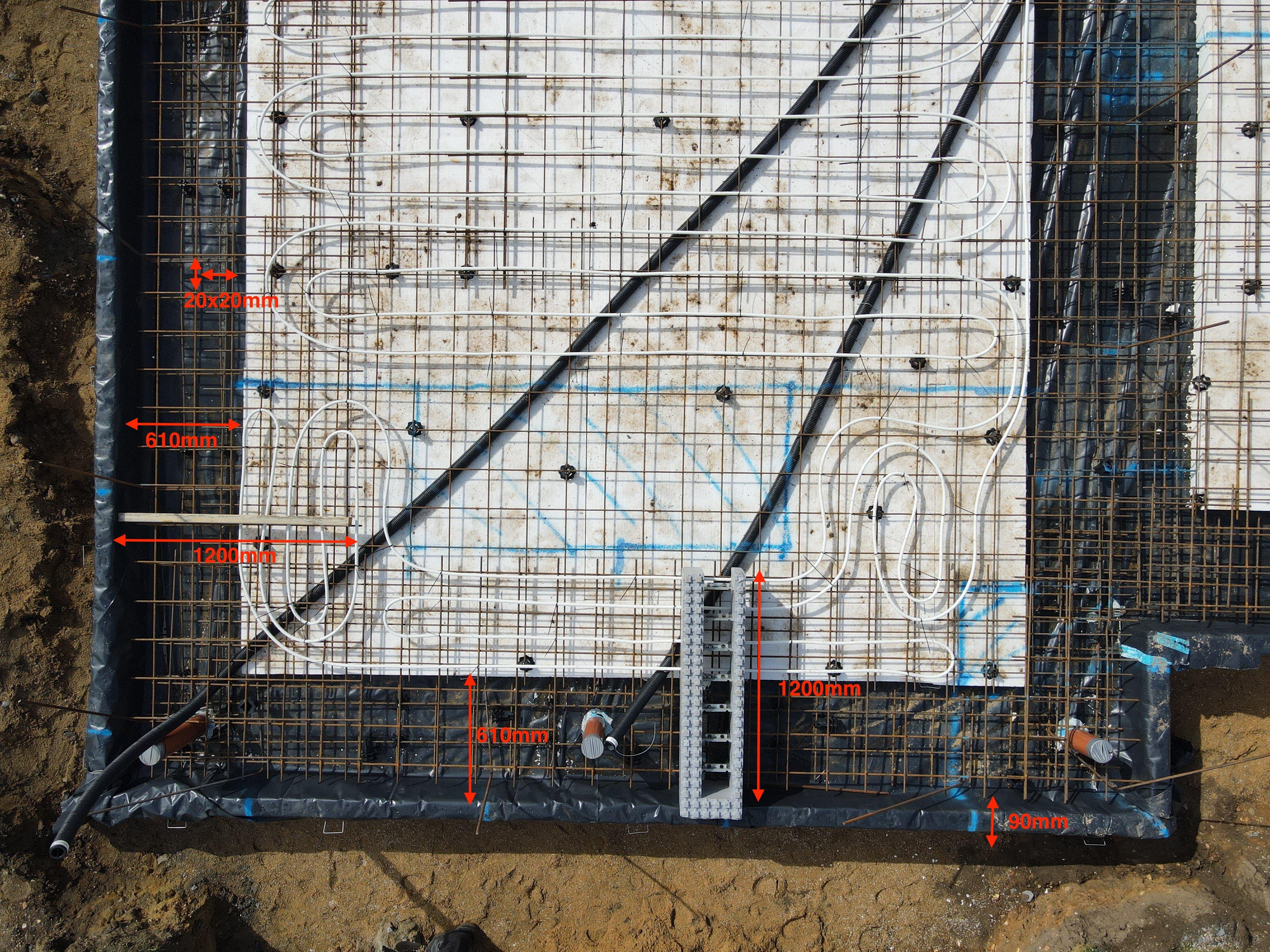

Nick Laslett Posted November 8, 2022 Share Posted November 8, 2022 I just ran ducts for the hot water pipes in the raft. This was standard 50mm twin walled ducting. https://www.builderdepot.co.uk/cable-ducting-twin-wall-black-per-metre-50mm The ducts ran under the rebar mesh. The plastic mesh supports were 50mm high. 1 1 Link to comment Share on other sites More sharing options...
